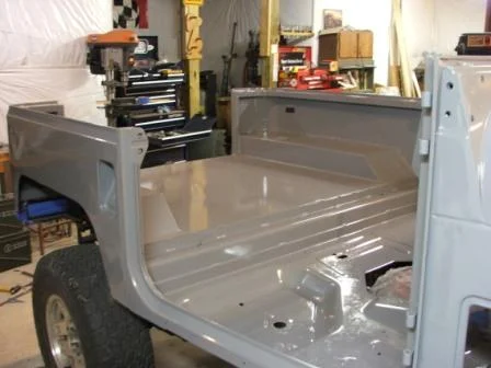

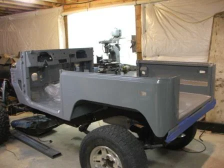

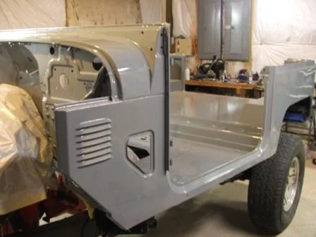

Painted my tub this weekend...
I came across this tread a while ago and thought I'd give it a try with a roller. I think it worked great. Since I'm working in my basement, I have to be careful not to "nuke" the house with fumes and dust. Using the roller, it was minimal. I have three coats on the rear quarters, with a 400 grit and 600 grit wet-sand between coats. (24 hours apart). Still have a couple more coats to put on the cowl, dash, and floor boards, but you get the idea. Color is Rustoleum "Smoke Gray". I have use about a quart so far, and three 12 oz spray cans to cut in the difficult areas.
What do you think?

It looks good. Are you going to clear coat it?? Did you paint the bottom side as well?
It looks like you are passing me on the cruiser build. I still need to strip mine down and take the tub off to paint it and cleaned and paint the frame. I might have to make GSMTR this year if you are going to have it ready.

Bottom is painted as well. I pre-painted some of the rear pans before final assembly/welding and just touched them up. With the tub just sitting on the frame I lifted one side 8" or so and did the front half then did the other front half the next day.
No clear. I'm not after that good a finish. If I wanted to, I could keep wetsanding and then buff, but I have to draw the line. I'm on a schedule! You get a ton of paint applied when using the roller. It tends to self-level and flow into a nice glossy finish. Besides, clear would complicate trail damage repair.

That looks great. I like that naval war vessel look.

Yeah, it does look a bit like a Navy ship. I hope once I get the bezel, seats, cage and stuff in it looks a bit less bland. I really wanted to go back to the factory blue, but it is a tough color to get right and I didn't see '77 Smurf Blue on the shelf at Lowes for $7.57 a quart.
I'm open to suggestions for bezel (white or black) and cage colors. Seats are black cloth Corbeaus. Was leaning toward just a black cage, but I'd think about something else.
