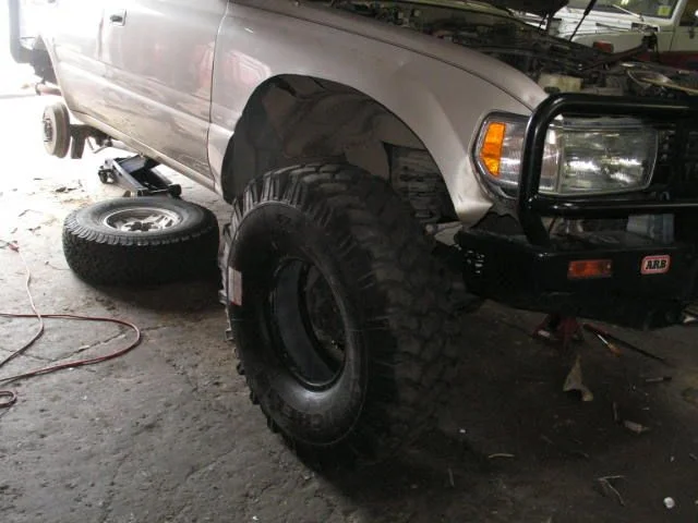

What size rims are you putting them on? Are they 16.5's like millitary wheels?

16 x 8 w/4" or 3.75" BS

Can ya get 'em in 19.5's for The Big Ol' Dodge sir?

these are 11x16. The next step up is 11x20 and they are about 44" tall. Maybe a bit big for the dodge

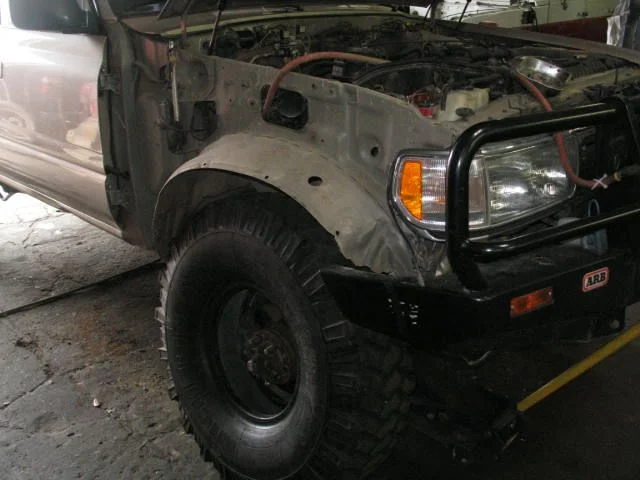

So what exactly are your plans? Trimmed fenders, moved axles, what?

The front fenders are going way back. Rockers cut off all around. 1/4 panels going but roof/windows/gates staying. Rear axle back a bit, just enought to get it recenterted after the lift, then lenghten all the arms out.

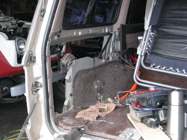

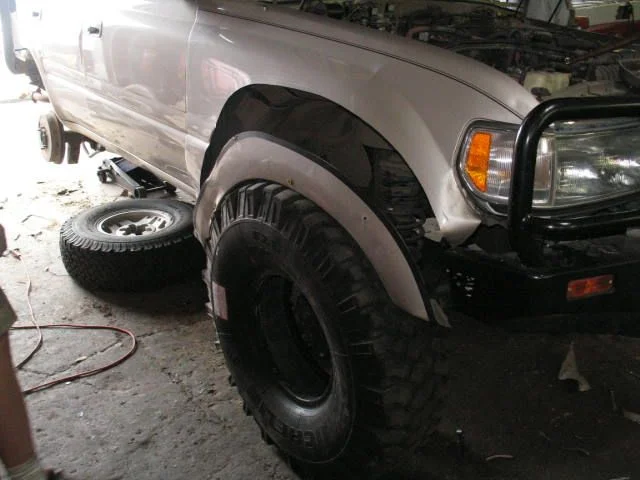

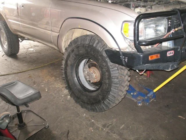

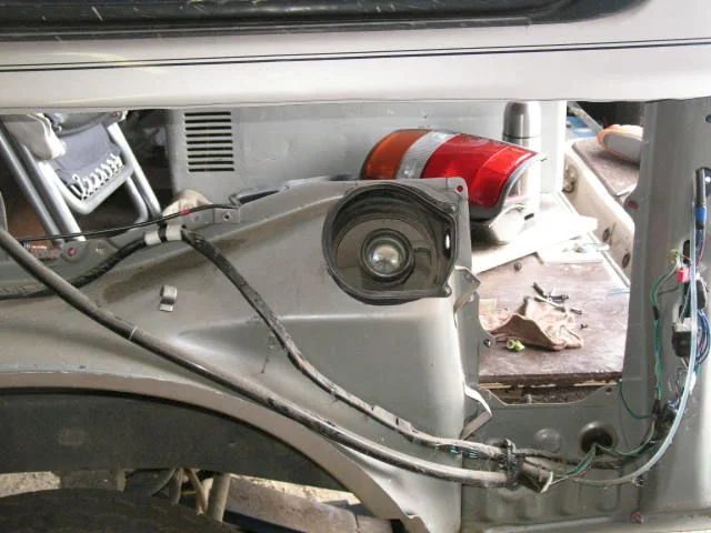

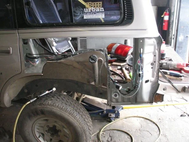

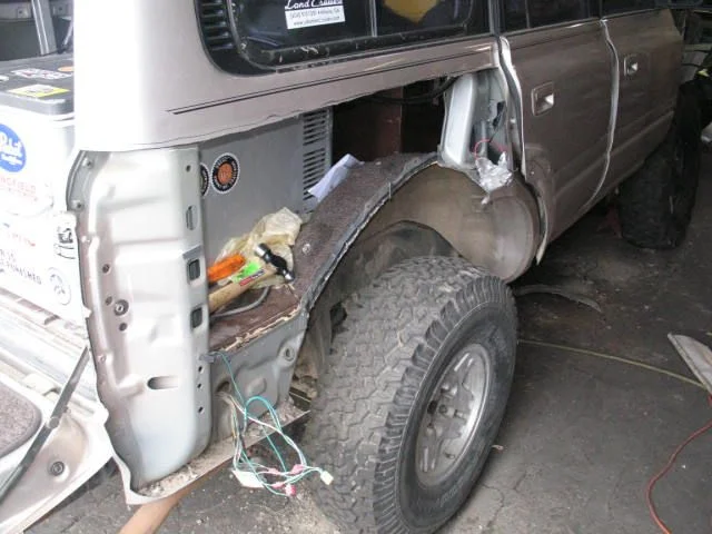

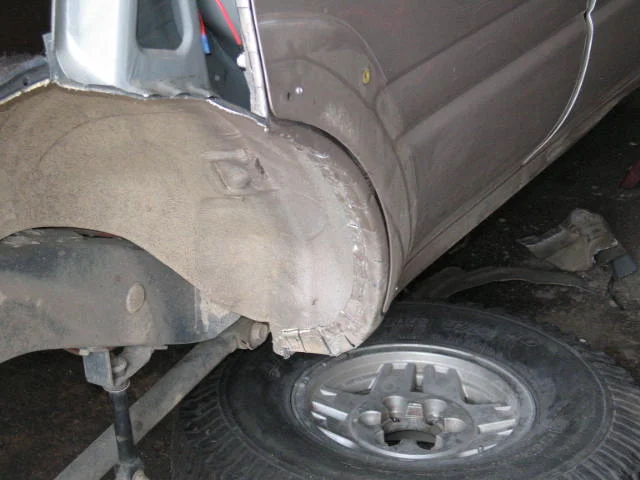

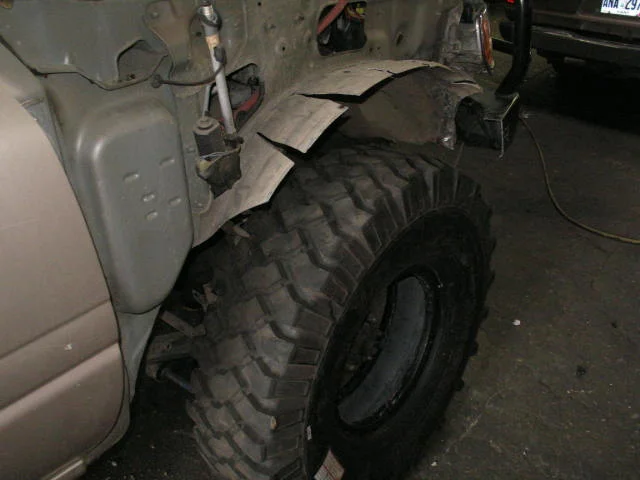

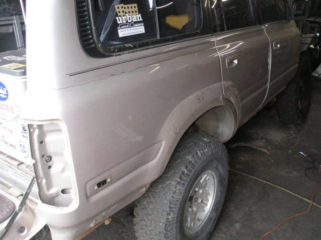

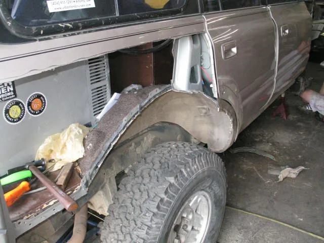

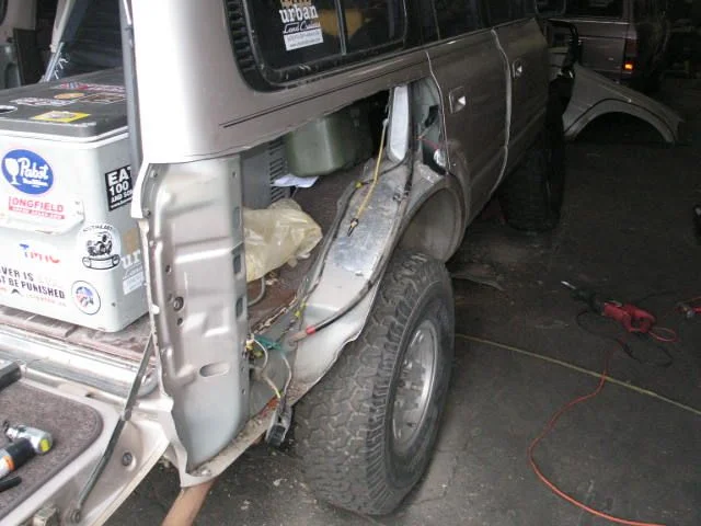

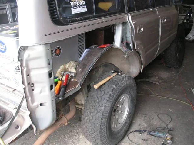

so we (mike) removed the fenders and got to cutting. The inside was cut into strips then a 1/4" rod was welded over it to give it some strenght. We then used aluminum tape to fill the "pie" slices. This will get herculined and sealed later

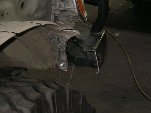

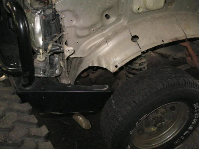

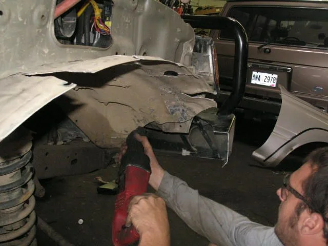

chopped th ARB bar. Just about brand new as well!

fenders more or less finished

we cut at least 5"s out of them! I will nee to go back later and fab some inner skirts

Posts: 2,820
the back was a bit more involved

it keeps getting better

more cutting
