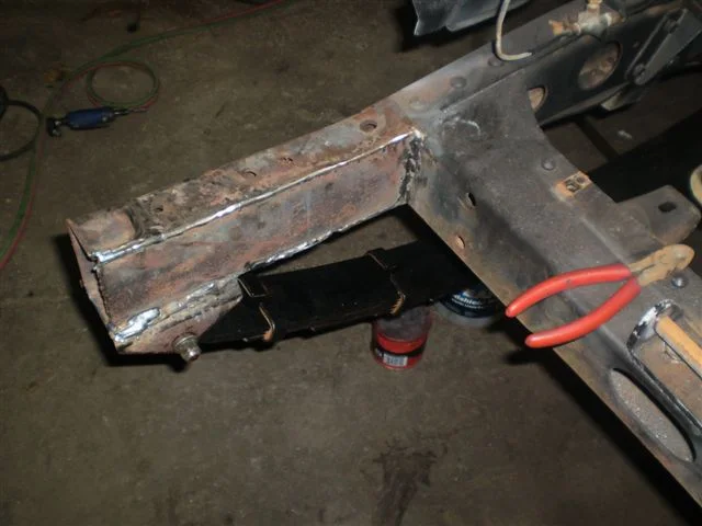

Jeff has been on my a$$ for not posting pix of his build, progressing at the shop
Completed will be
69 FJ40 2F, SM420, SO, SR, Saginaw, High steer/1 ton Chevy TR ends, cut n rotated front housing, Metal Tech cage, (need a decision soon on style)
4 wheel disc, power brake booster added, Lock Rite in rear.......

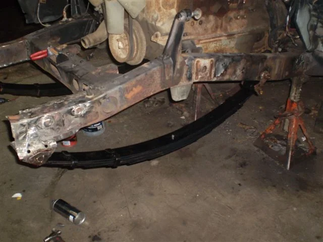

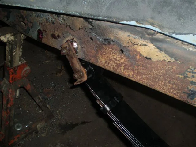

1 st pic is showing the SO finished and the cleaned and painted springs hung, note the shackle sunk into the rear of the frame
2nd pic shows the Saginaw steering box mount, this is 3/8'' steel,
3rd pic is showing the passenger side, SOP is plating the inside of this frame rail also...

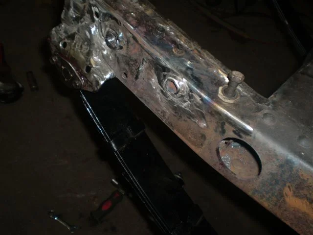

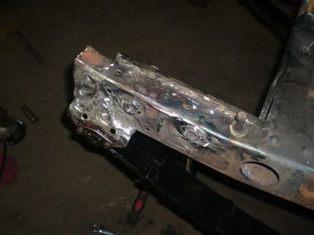

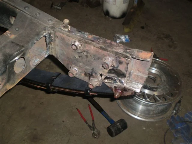

1 Close view of the rear shackle
2 and 3 View of the outside of the frame on the gearbox side, the two bolts that go thru the frame are sleeved to prevent the frame from collapsing .

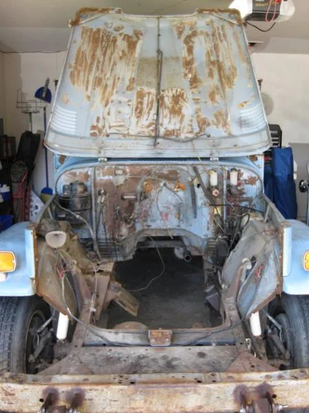

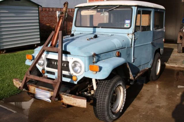

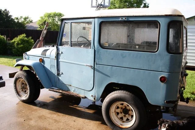

Here are shots before it went to Butch.
As I bought it.
Size:  48.0 KBName:  img2.jpg
After I pulled the 1F.

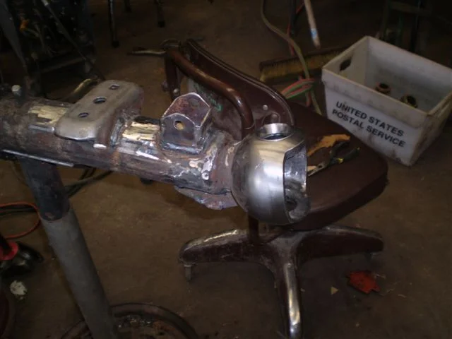

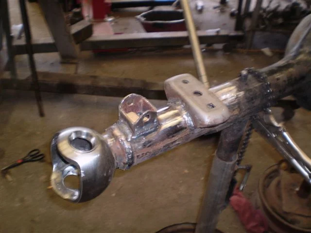

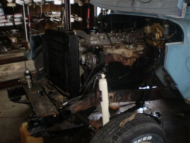

GOt the axle cut and turned, shock mounts on and lower ball braces in place, got to make some steering stops and the upper ball brace, then finish assembly,
Josh says ya need to buy some Longs now, I splained to him you need to know how to change a birf...............

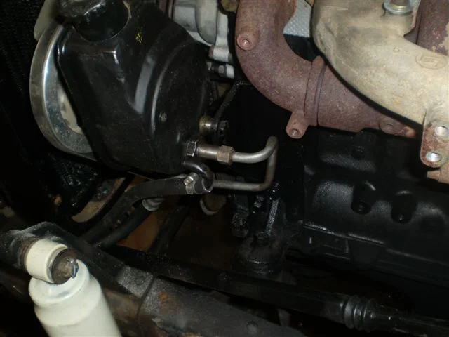

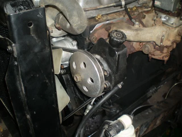

Progress report, got it setting on the SO, engine wired and running, PS finished, Power brake booster on, etc.....

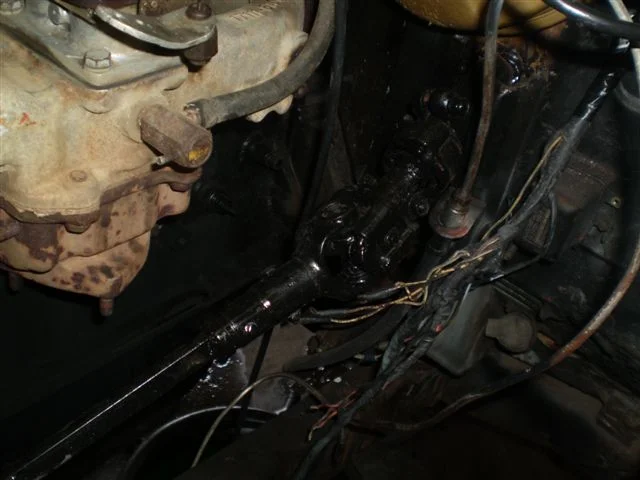

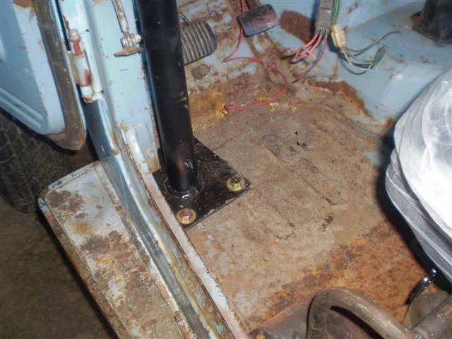

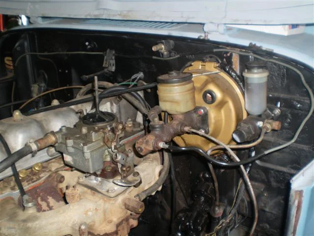

First pic shows the lower end of the FJ55 column, it comes with a u joint and lower bearing......

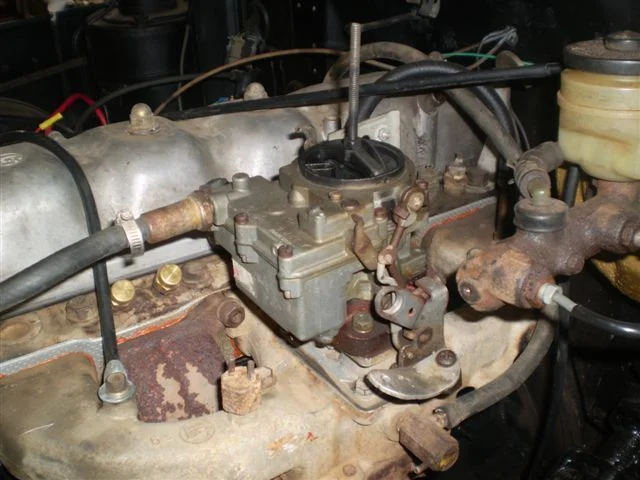

Second pic, this Rochester carb came with the truck, it was here and it works great.....

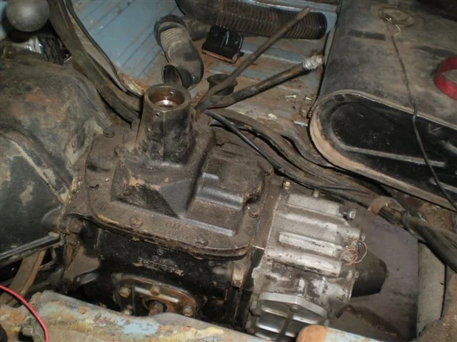

Third pic shows the poer brake booster, this truck di not come with 'em

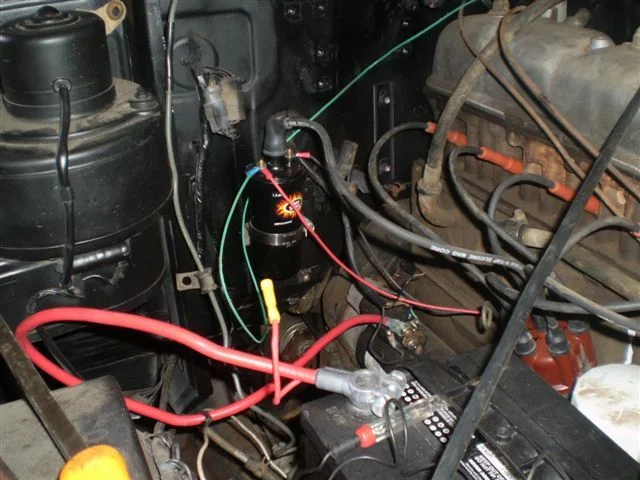

Pertronix ignition system from Mark the hippy foolproof............
SM420 with twin sticks.

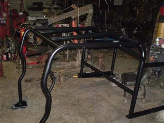

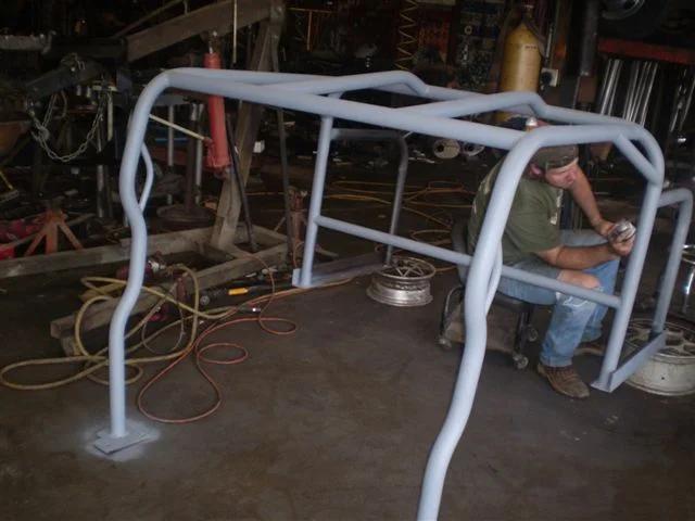

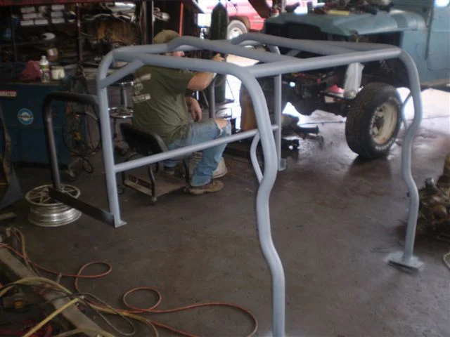

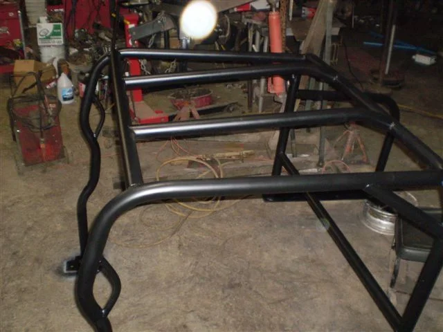

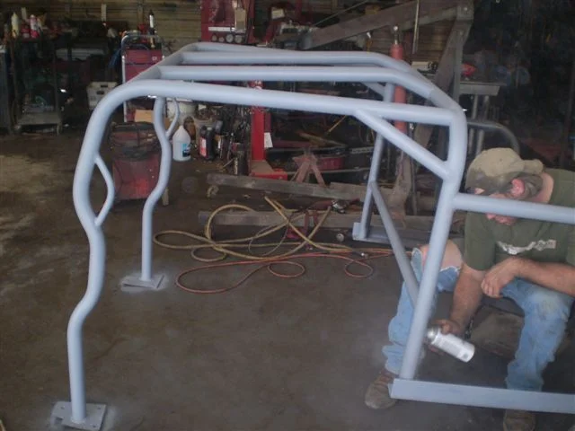

Josh came in a worked his magic........it's primed, shoot black in the morning

That is a work of art. Can't wait to see it mounted up.

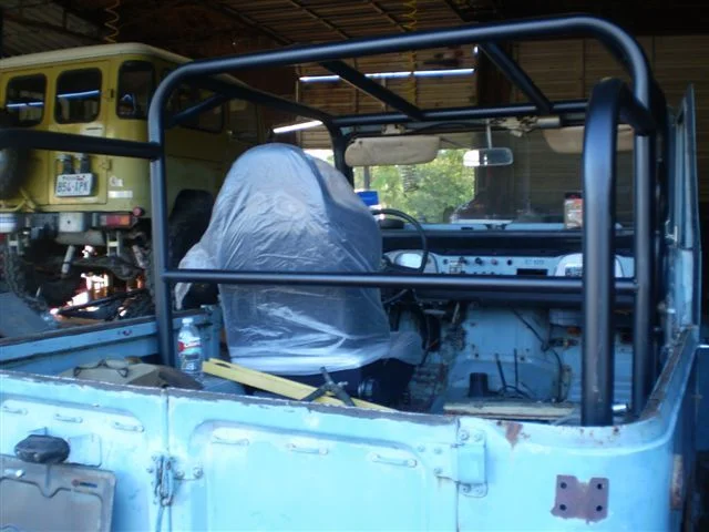

cage question
Quote:
Butch,
Would that roll cage (I assume Metal Tech??) fit in a FJ40 with the hard top on without modifying the hardtop or its mounting?
And, its sounding like you are getting closer to completion... then you would have some room to work on my Toy...

Hard top fits fine with that cage. I've got the same cage.

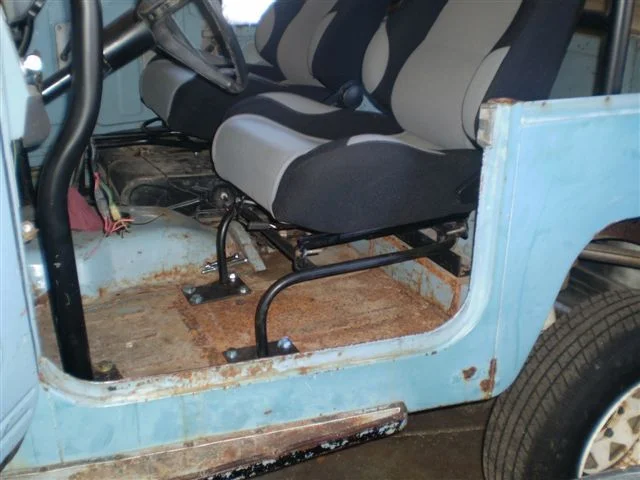

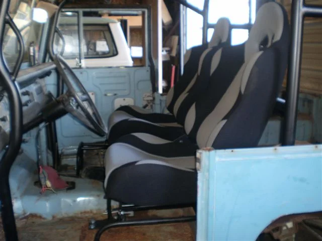

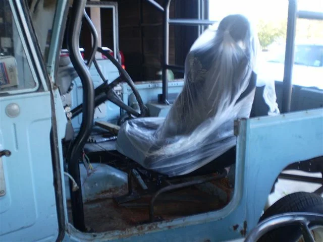

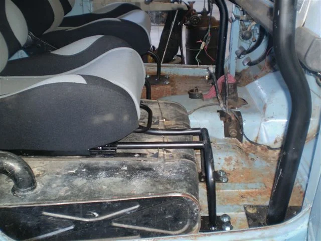

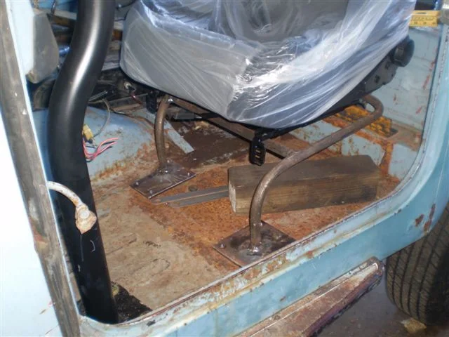

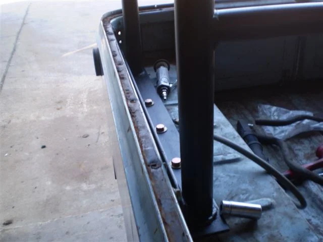

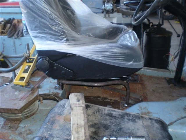

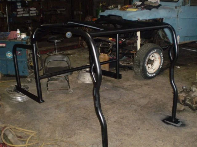

Josh got a lot done today............cage painted and installed, drivers side seat almost mounted........

Posts: 3,673
Seats and stuff
Got the Summit Racing seats installed.....Josh fabbed all the mounts and was able to install sliders on both......first 40 I have ever seen with an adjustable passenger seat........a 7 ft guy can sit there.......

Cool. I'll invite Dirk Nowitzki to the round up and he can ride beeotch.

Man, the more I look at that blue color the more I want it gone. That blue would be cool on a stocker but not a trial rig.
Now, what color?

[QUOTE=jebber;4939331]Cool. I'll invite Dirk Nowitzki to the round up and he can ride beeotch.[/QUOTE
You had to Google it to spell it .........right?
Quote:
Now, what color?
Trial rigs are motorcycles.......
Never seen a 79+?

Quote:
Originally Posted by JasonH View Post
Never seen a 79+?
I waz refering to men's FJ40's the round bezels..............
Not them metrosexual square bezel deals......
