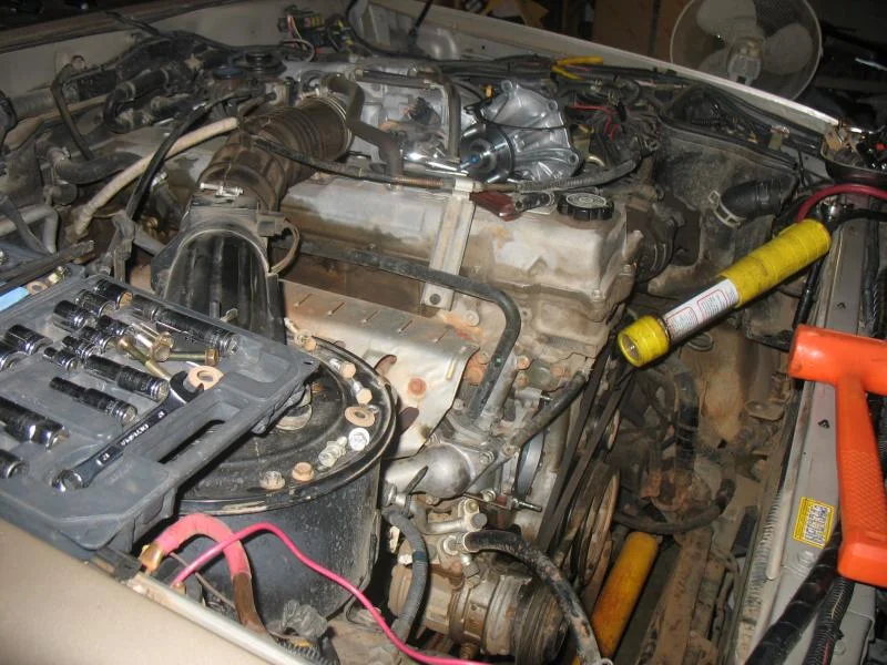

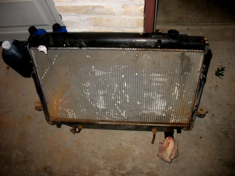

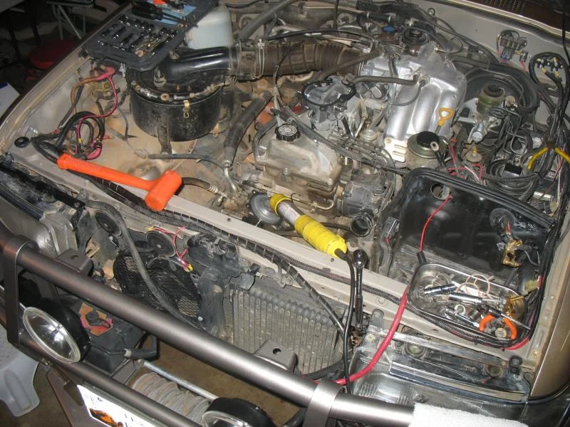

Cooling system rebuild
How does this suck? Let me count the ways.
Remember: A job that consists of a 1000 steps always turns into a 10,000 step procedure.
It's slow but I'm steadily chipping away at my radiator and water pump replacement. I found that having two battery trays and other electrical accessories makes this a more labor intensive job.
I've had to remove both battery trays and all the associated electrical crap. After draining the cooling system, I found cracks in the fan shroud and transmission cooler lines. After a quick trip to the dealer, the parts are on the way. I'm spending a lot of extra time cleaning everything and rewiring some of the accessories.
When I finish this job, I'll have a new radiator, water pump, thermostat, fan clutch and drive belts. Sweet. I just hope I can remember where everything goes.
