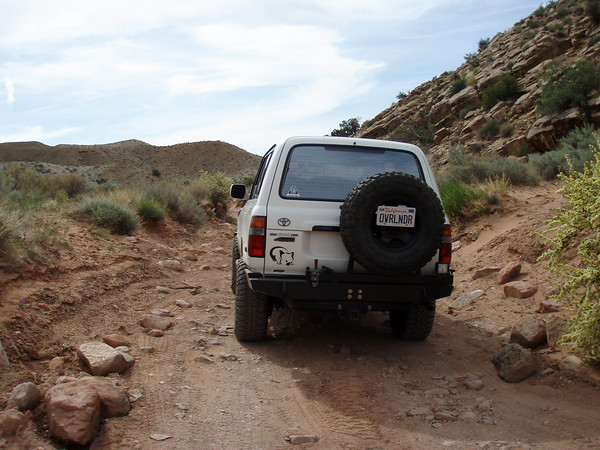

I'm new to the area and need to get my truck inspected. I have a Slee rear bumper, problem is I don't have a rear license plate lamp, nor the wiring harness that originally ran from the lamp assembly to the connector located in the rear, sort of in the middle where the bottom of the tailgate meets the floor.
Parts fiche shows the assembly for a 91-94, so I'm assuming those years are compatible. If anyone knows of any salvage yards with a LC or two please let me know. Already tried Wimberly with no luck. I'd rather not splice into the tail lamp harness, and the vehicle has a rear sub-tank so the towing harness is gone as well, or at least not readily accessible.
Thanks! Scott

So the PO pulled the original harness out of the lower tail gate? There is ONE pin to pull out of a connector and the plate lights will be disabled. Usally this pin is then wired to the new relocated plate light. Or did they pull the whole light bracket off also?
Well there is one salvaged '94 I know of but it's not in one of my "prefered" yards so I can't get any $$ off the parts. Otherwise you'll need to run a few new wires if the light bracket is still there.
Everything is gone from the tailgate. The pin connector has very little slack in the wire so it would be very difficult to splice into, which is why I was looking for a factory connector. I found a used assembly at Specter, so I plan on just extending the wire length and fabbing up a bracket for the original lamp assembly.

So is the tire carrier on the truck?
Yes. Everything is as you see in the above picture. I ordered a used license lamp assembly and harness from Spector and my plan is to splice a longer cable into the harness so I can use the OEM connector and fabricate a bracket to mount the lamp above the plate on the spare. A small piece of aluminum angle should work. There are wire guides on the bumper and spare tire carrier to facilitate this. My other option is to drill some holes in the Slee bumper and mount the plate and lamp there.
Scott

Very nice! Is that Borrego?

mounted on the swing arm with an autoparts brand lamp. 15mins and less than $10. cheers.
Up near Arches in Utah this past May.
