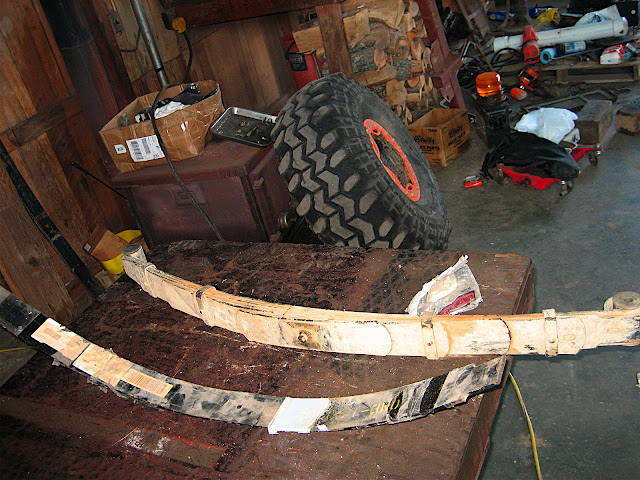

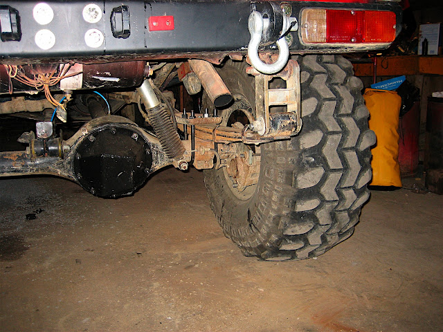

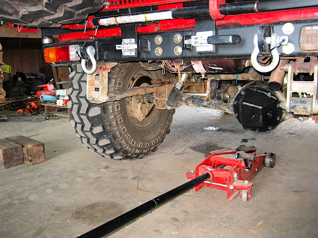

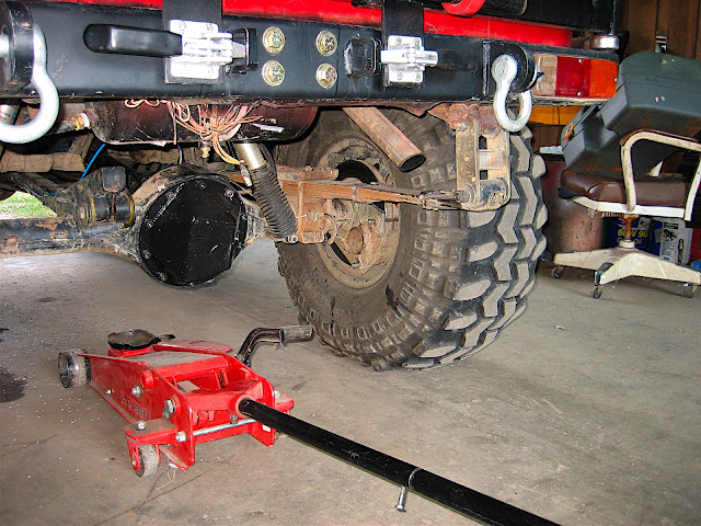

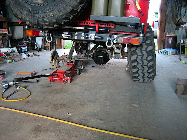

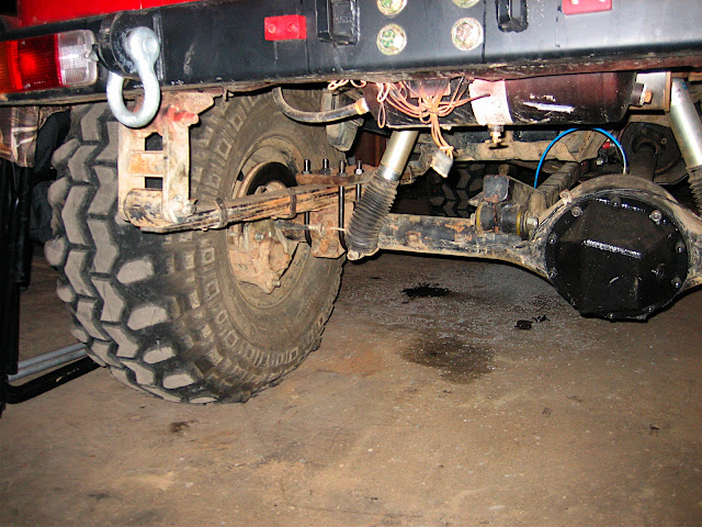

Well, here are some pics from the spring adjustments we had to do on my rear end tuesday afternoon...after it was mostly loaded. We added and 2.5" lift OME add-a-leaf that was designed for the front when carrying a heavy winch/bumper...Thanks to Bob a TPI for helping us out!
At this point, I still have no idea what springs those are. When I bought them, I was told they were flipped/drilled 40 springs that came as a part of the SOA in a box that I got from Rascal. But these measure 2.75" wide, 45.5 eye to eye, and they're offset, so not 55 rears...They are aftermarket, but not sure whose??
As you can see, the first pics demonstrate that the springs that started out flat, had inverted. Then a few pics of the spring off and then with the new leaf, they sit just about where they were with the cruiser empty.
And Finally...almost fully loaded...minus the fuel...For those paying attention earlier, the small ARB is riding in the big truck up to Tok, and we'll move it to my Cruiser there...
