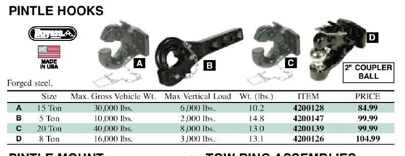

This is a pintle hook...
LabRat11 is offline   Reply With Quote

OEM Toyota BJ40 Pintle hook.
Military uses them, and if I have a choice I'll never use a ball again. My trailer has the ring and I bought a receiver mount for another pintle hook that I can use on either truck.
The connection is solid, it swivels every which-a-way without a chance of popping off as a ball hitch could do if stressed.
And, I agree with labrat about those combo things. Looks universal and thereby a convenience but I think the lunette ring moves too much against only the shaft under the ball causing a possible breakage (or considering labrat's post, an assured breakage)

The pintle/lunette setup is FAR superior in every way. Much more heavy-duty and actually easier to hitch up. When towing, you get more articulation between tow rig and trailer. Hell, we pay good money so that our truck's suspension articulates, why not give our towing combination the same advantage? (Rhetorical question)
Some will point to specialty tow setups that have the regular ball, and the hitch articulates by twisting; however, IMHO, these are more failure prone than the military setup.
All four of my cruisers have pintles, and one of them (HJ45) has the combo pintle (as pictured in Snook's post #5). I've never had any trouble with it.

That sounds kinda spendy. Brand new one retail for $50 in Anchorage. I KNOW that shipping to your local is less than to here. Mil surplus shops here get about $20-$30 for them.
There is no "NATO" or other rating for Pintles. Forget worries about brand names and just pick one up at your local truck or farm supply store.

Northern Tools has several.
After some painful research I was able to find one that cleared my hitch receiver so I have both on now.

You'll find them rated for different weights. 5000 and 10000 lbs. seem to be the chinese made choices.
To use in a 2" square receiver you can buy or make a simple heavy plate/square tubing slide-in adapter to mount the pintle, like so:

thanks, what i had in mind was item B below with its own dedicated receiver bar. I no longer have a pintle mount on my 80 since i cut off the rear cross bar and added a bumper from 4x4labs. this is princess auto here and the price is $C. a bar that bolts up to bolt on pintly is about $40 so slightly cheaper if I could find a good price on a pintle but the dedicated bar suits me now.

The B style above is what I've been using for a number of years. Easy to swap between vehicles with a 2" reciever if you need. It's a solid heavy unit.

I bought the B style at an Academy sports. They had two and looks like they were trying to get rid of them, I got it for like $50, JC Whitney also has a small selection of the pintles. Might want to look locally at some outdoor stores to see if they have anything like you want because these are pretty heavy and shuipping might be expensive.

Sorry, it's late. I actually bought two inch reciever style like the one snook has pictured. Time for bed, Later.

I have been using the D style above, but now I need to sell it as it doesn't fit with my new rear tire carrier.
It is the best of both worlds it has a two inch ball built into the hook of the pintle.

I'm not comfortable with the trailerball/pintle hybrid. The shank of the ball is still the weak point. While any
