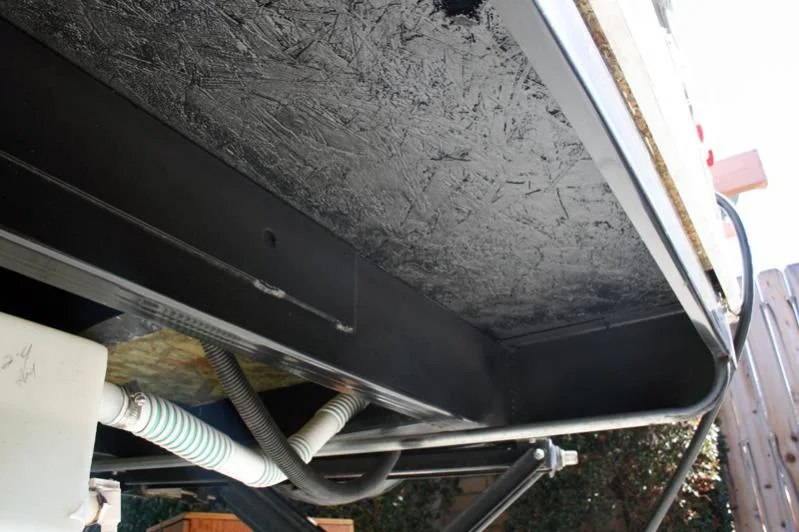

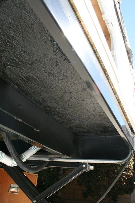

yep, that was the main concern for the short term. Driving 6 miles in salt water and beach sand has got to have some consequences I thought, so I wanted to prep as much as I could.
THe wheel wells have a plastic half fender, but it's all exposed wood underneath the whole trailer.
I bought some Rustoleum Undercoating from Lowe's. at 8 bucks a can I thought it would be an affordable test. I could always durabak over it next time maybe?
anyway..on to the photos.
