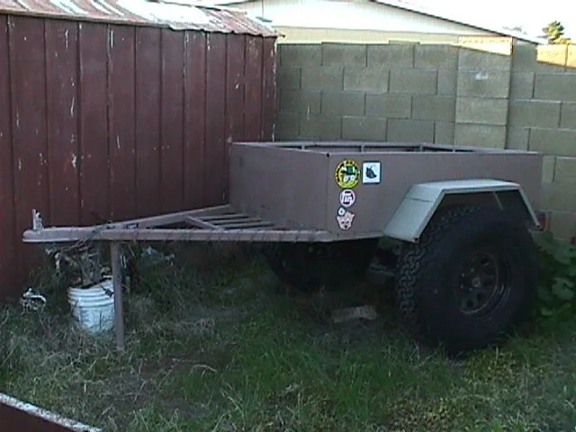

well heck thats pretty much the exact same trailer i built,,,, so of course i think its awesome !!!
i havent had any problems with the ribs being inside,,, i also use it for a general purpose trailer and i have to sweep out corners sometimes of messes that get in there, like hauling compost home or something. but its not bad and i'm glad i went that route.
i put tie downs on the outside of my main frame (down low) cause i didnt think i'd be able to reach them on the inside when loaded, the only drawback is that its tuff tying down something lower than the sides,, but that rarely happens.
i dont have a lid on mine, thought about it but i dont think i need one since i never plan to mount an RTT or anything.
my tailgate latch is a captured bolt in the trailer with a tab on the gate,, then i bolt it up, keeps it from rattling. i have to unscrew the bolts everytime i want to use the gate, but thats fine.
i used a regular ball hitch cause i built it back before anyone really knew about anything other than a pintle and i didnt want that. so far i havent had a reason to replace the ball hitch.
heres a crappy pic for ya. cant see well but its on 35" tires

Small update (sorry no new pics). So I'm pretty much done with the trailer with the exception of the lid. The lid won't be a huge expense but I'm out of funds for a couple weeks until I can get another sheet of 16ga and a couple other peices for the lid frame. But the trailer is useable and I've dragged it around a few times just to see if I can find any issues.
Well one came up. I took it out on Sunday and and jacknifed it (on purpose) but did something stupid. I knew I was going to jacknife it and was waiting for the sound of the tongue bottoming out against my rear bumper and took my eyes of the mirror for a second. Well it turns out that the way my rear bumper is trimmed up toward the outside corners allows the tongue to not bottom out against the bumper but actually slide underneath the bumper. That, along with the lock-n-roll that allows it to rotate past 90* I jacknifed it a little too far and the top lip of the trailer tub came in contact with my rear fender flare on the Cruiser. Not a big deal (other than a crack in the fiberglass flare, since I wasn't paying attention), but I need to figure out a way to keep the trailer from over-rotating in a jacknife situation which will definitely need to happen from time to time on the trail.
Kinda hard to see from this picture but maybe you can see how my rear bumper slopes up (bottom edge) toward the corners and that the level of the tongue can pass underneath. I'm looking for suggestions on a way to limit the rotation during jacknife situations. Any thoughts?
Edit: Maybe you can see the rear bumper better in this picture. I would have thought that the center portion of the bumper before it angles upward would contact the tongue but the distance of the point of rotation on the hitch away from the bumper face puts the tongue at an angle past 90* before the tongue contacts that center section of the bumper, letting the trailer tub come in contact with the truck.

So my thoughts are to weld a "stop" to the top of the tongue. Basically another peice of the tongue material boxed in on top of the tongue to contact the bumper as the trailer jacknifes. Once I get my cooler rack on the tongue that will probably contact the truck as well, but I don't want to damage the cooler or the cooler rack by using them as the "stop". Thoughts?

Attach your chains to your clevis points? It may be too much for those little chains.

The chains are actually decent strength but I still don't think they'll cut it as a real long term solution. I'll take a look at it but I think I'll have to do something else.

Did the handle hit/get bent when it swung over?

If you have to put it on the triangular tongue, you might as well make the space usable like a cooler rack. Just need to make the bottom strong enough to take the hit from jack-knifing.
