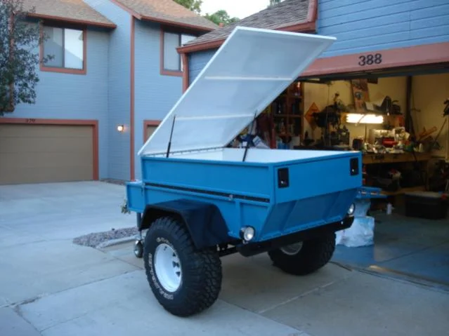

I think you are thinking correctly here. I don't have any easy way to partition or tie down crap in the trailer. I wish I had added something like that before paint. I will bolt in some tie downs after the kitchen is done.
Originally Posted by Box Rocket View Post
I've been thinking about this more and more and I am leaning toward puting the hinge on the front like yours. I was worried about it opening far enough to be able to comfortably get to things at the front of the trailer but obviously you can if it's setup like yours. Probably easier than trying to reach across from the side, especially if you're kinda short like me (5'9") and more importantly my wife (5'3").
Thanks for that pic.
Yup, after debating and debating and debating I mounted the hinge up front as well. Here is what made me decide. Stand by your tire and reach for the opposite side... its just not going to happen. Now, strap a fuel can, propane tank... whatever and your sides are full of crap putting you another 6-12" away from the far side of the trailer.
I would mount from the front... no questions.
