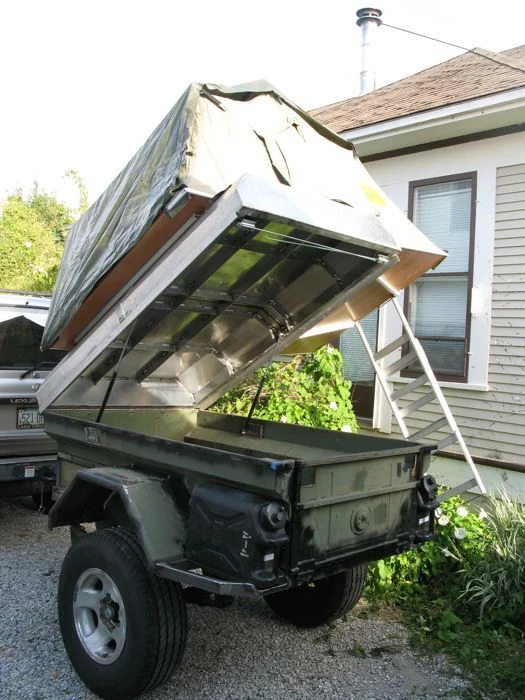

I need another suggestion. I have been wanting to have a side opening lid, but I'm realizing I could have a problem with where to mount a gas strut along the back because of the tailgate. Is there a good way to handle this without having to add a top rail across the back in the tailgate opening?
Or will I need to have the hinge for the lid on the front of the box? Obviously that will work fine, but it sure seems easier to get to stuff inside the trailer by reaching in from the side.

i hinged mine from the front and it makes getting in either side a breeze

I've been thinking about this more and more and I am leaning toward puting the hinge on the front like yours. I was worried about it opening far enough to be able to comfortably get to things at the front of the trailer but obviously you can if it's setup like yours. Probably easier than trying to reach across from the side, especially if you're kinda short like me (5'9") and more importantly my wife (5'3").
Thanks for that pic.
