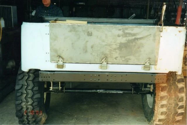

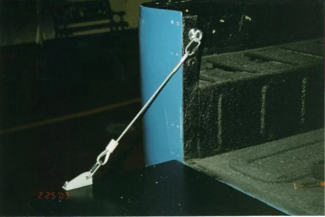

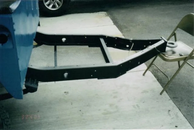

OK, here's the first few of the build. i made my own tailgate and ties so it become a table in camp.

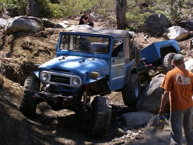

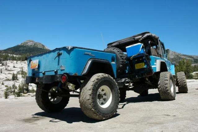

next a few shots in action. i made a tonnue type cover myself. the only thing i will change now is the storage is too small. i will either make more body up front like Kurt's, or make bars that raise the ability to stack things higher. mine has the cruiser frame with the inside channel removed, and a trailer axle.

oh, and ignore the torn off fender flare on the driver side. Rubicon trail damage.

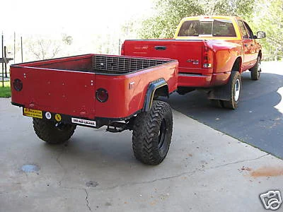

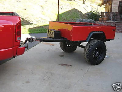

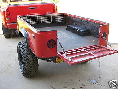

Here are some more pictures I got from a trailer currently being listed on Ebay eBay Motors: Toyota FJ40 Landcruiser Trailer in Excellent Condition (item 260374357482 end time Mar-18-09 18:00:00 PDT)=

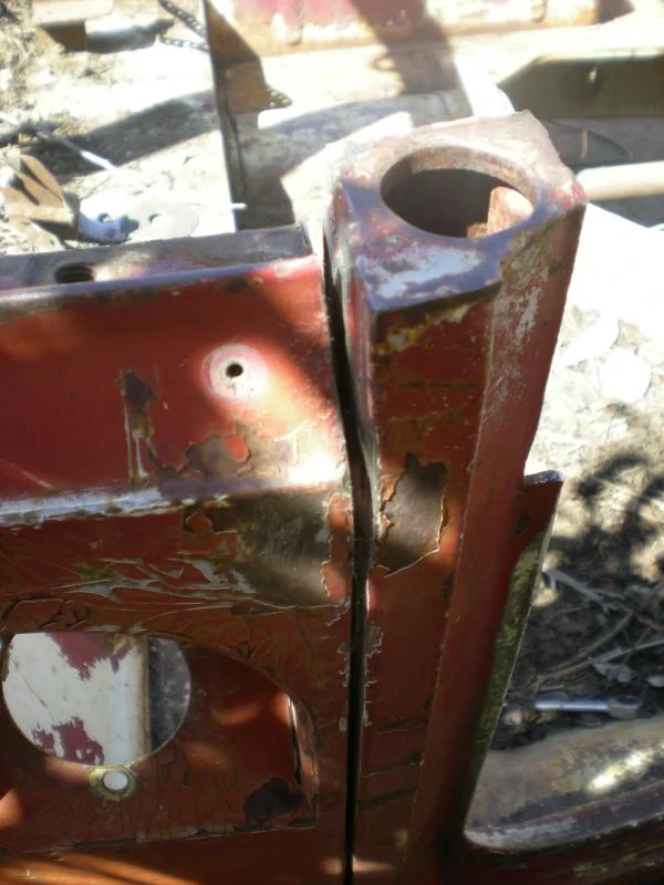

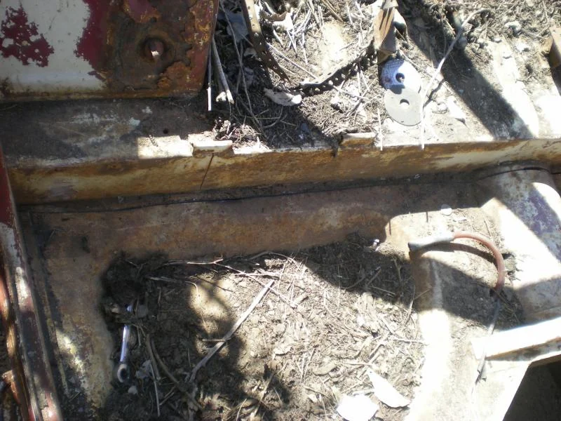

Work begins!
Weather was nice today so after a little wheeling with the family in the 80, I started cutting one of the tubs today. I started with the 65 tub at the seam directly behind the door. First I took out all of the bolts. Then I cut the welds at the top with a cutting disk. Passenger side came apart easy. The drivers side apparently got hit at some point so It had more welds at the bottom by the tool box. I borrowed a plasma cutter and will attack that area next as it was too tight to get the recipricating saw or cutting wheel in there.
Im trying to be carefull how I cut because I want to save the door frames for my 4 door 40 project. I also want to sell unused body sections to help fund the project.
I got some practice installing an axle this week end on my utility trailer. It had old bent 2000# 4 bolt hubs and I upgraded to a 3500# axle with 5 on 4.5 hubs that gave me the chance to upgrade wheels and tires to a larger size. The trailer has a dump to the added hight should help with the dump angle
So my goal with the expedition trailer is to have a rolling trailer tub by mid May when I am going on a grand canyon expedition. I live in southern Utah 60 miles from the north rim. It wont have a top or any built in kitchen equipment but it will be a place to haul gear and a flat place to sleep.

Here are some pics
