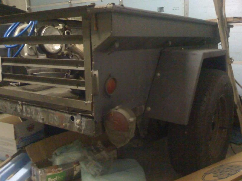

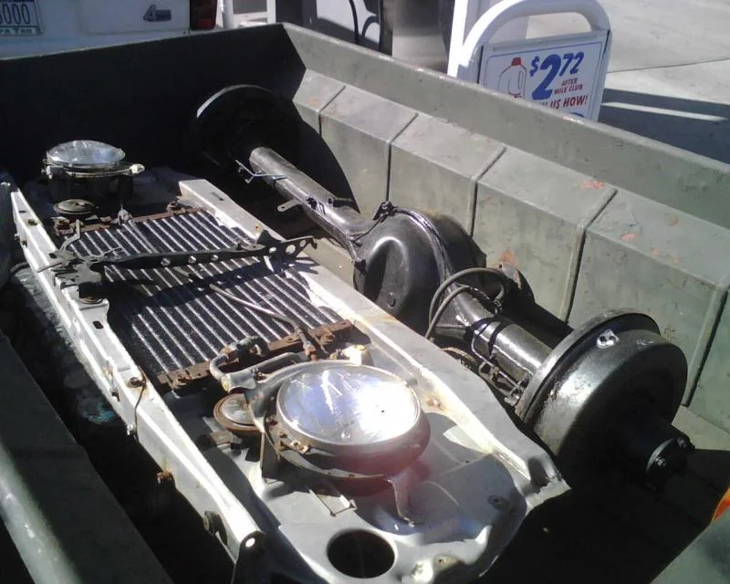

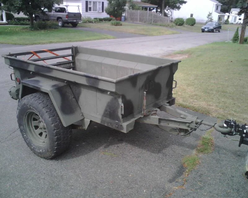

I picked up this M416 a month or so ago for $350 and it sat for a while till I got my hitch mounted and wired up. This past weekend I took it to Dave's Place ( GCLCNY Event ) and then down to LI to pick up some parts for my cruiser. I gotta say that I LOVE this trailer and am so glad I bought it.
Plans:
Break it down, fab up tailgate, remove paint and rust, paint, re-assemble.
First task, precious cargo:

I'd like to see some closeups of the tailgate.

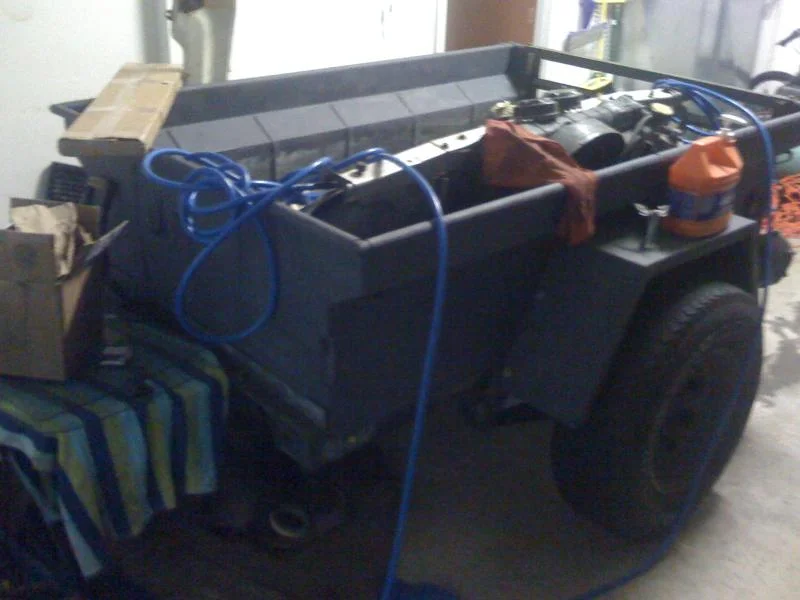

Small update: the trailer build has been put on hold for the time being because the t-case on my 60 exploded not too long ago. Long story.
Anyway, in prep for the winter, I want to grind out all the paint and rust with a 4" flap disk, then hit it with Extend rust killer then primer then a few coats of glossy rustoleum, as per the advice of Mark Woytovich. I'll put up some pics of that when I get back in Rochester and have a chance to do it.

Update long overdue:
A couple of months and a spring later, I am in KY doing an internship. A month ago I took the tub off, sanded / blasted all of the rust and most of the paint off, primed it and sprayed on some 3M under coating on the bottom of the bead and fenders. The rest of the tub got primed.
The frame didn't get taken apart because I have yet to purchase my 3500lb axle because I'm in the middle of my SOA. I did sand / blast all of the rust and sprayed the entire thing with a rust converter / metal prep to preserve it.
Short term goals for the trailer are to do an SOA on it to match the height of my truck after it's done and use it some more! Here are a few pics showing it's current task: parts storage.

I did a very similar work on my M416 five years ago and it served many purposes included "dumping" for my recently completed remodel house.
My 1967 M416 comes with a metal loops at the bottom tub for the Marine to load/unload from thier Marine ship for the front line deployment. One of the men at Coyote Flat joined Marine in 1970 and he pointed at mine and said "That's a Marine trailer!" even the metal loops was cutted off!
Yours?

First of all, thanks for the compliment! I've used this thing a couple of times and I love it. I considered selling it, but how would I transport all of my crap!
Metal loops..... What do these loops look like? My tub has got the drain holes front and back which have loops on them, but other than that there are no loops on the bottom of the tub. There are hand holds and tie down hooks on the sides, is that what you mean?
I really should paint this thing. I bought the paint, I'm just lazy. I've worked on my 60 so much this summer I kinda want to take a break.
