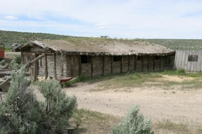

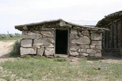

I spent a week working (exploring) everything south of you down to the Owyhee a couple years ago. Amazing country. Here are a couple pictures from that trip.The iris photo was taken about 1.5 miles NE of the Boni HQ where you are parked -in the middle of a cattle grazing pasture. The stone house and willow barn are 12-13 miles south. Bob

Blue HZT60, thanks for the pics. This really is a beautiful area. I think we will be making it an annual trip. It is amazing to see what they were able to do with so few resources up there and how well they have stood up to time in such a dry climate. For those that don't know, the willow barn (if like the willow sheep corals we saw) is actually made from 1" and smaller willow branches stacked together between posts. After 50-80 years, they are still solid and held tightly together.
