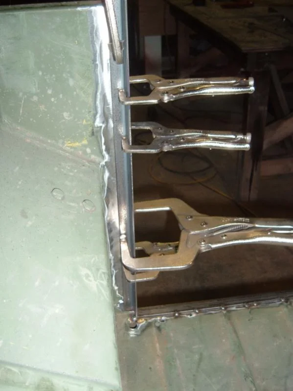

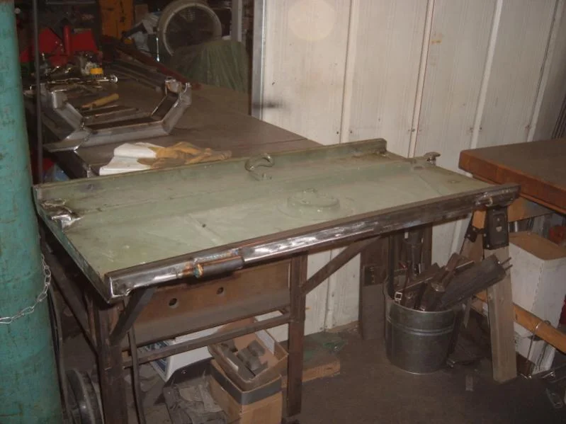

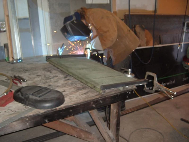

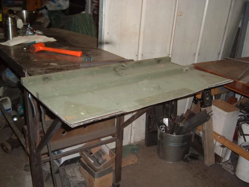

So I zip cut the tailgate out last night, tonite started the tailgate, Tuesday on to the fold out tent rack, I'm going to post all the pics as I go.... First pic is is the tailgate I cut out, ...2nd The Finnish Flash boxing in the tailgate with 1X1, 3rd the trailer...wrong order I know...

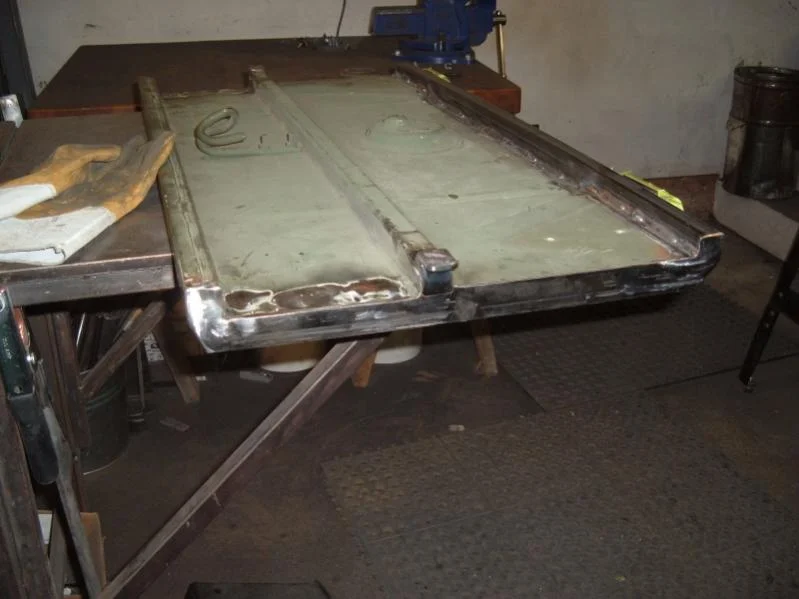

4th pic, boxing in tailgate with 1 x 1 to match the other two pieces of 1 x 1 already on it...5th pic the detail of the 1 X 1 around the heavy plate in the lower corners of the tailgate,

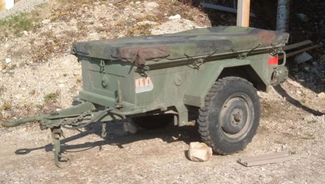

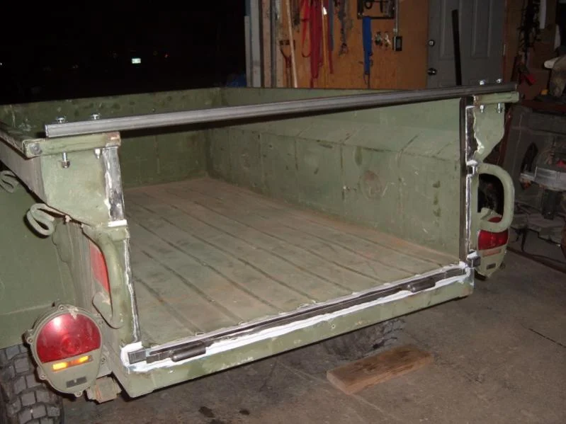

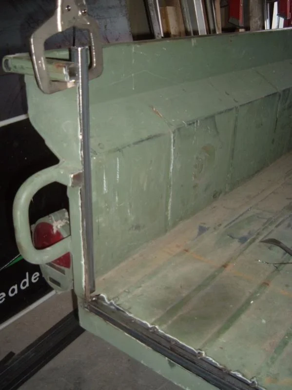

6th pic, the trailer, 1/2" angle set into the bottom, after we cut back the folded steel at that point, 1/2" angle boxing in the hole...

next pic, the detail of the angle set into the floor..it's flush with the floor, and gives me the spot for the hinges, tying them to the box...the last pic shows it from the inside, the angle being tacked up the sides of the hole...
We did the gate fitted in and the hinges tacked on, but no batteries,..Tuesdau night will update, and begin the fold out tent part....

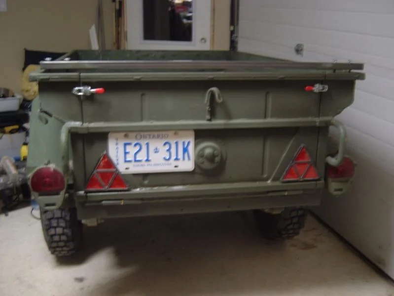

Painted the tailgate, cleaned up welds and sealed up the trailer, the bar across the top is the first bar of the fold out tent, just for mock up...

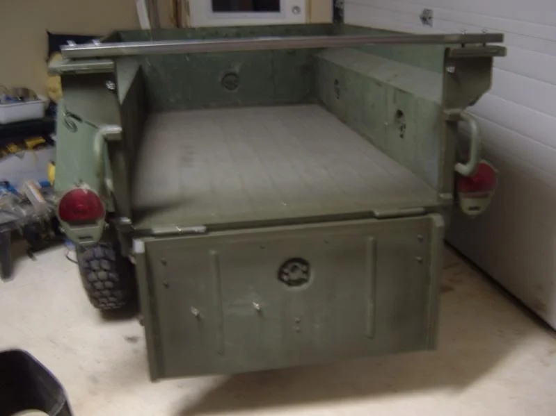

Tailgate paintes and installed, latches in place, the reflectors went back in the stock holes...I hung it open just to show it, I'll be installing two aircraft cables to support it...
On to the tent rack....on Tuesday : ) Long weekend now : )
