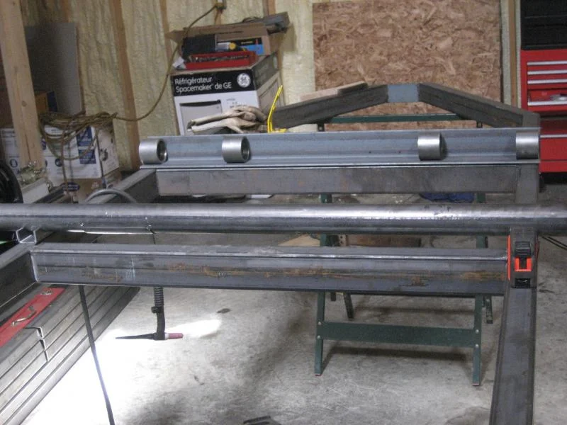

Started building after months of researching
Looks like everyone else is building trailers, I have been looking at this site for months doing research, so much great information. Checked out some used military trailer, could not find one worth the asking price.
Have also been checking out all the different web sites dealing with expedition trailers, love the Adventure trailers "Chaser" looks the best suited to my needs. Only problems are shipping and price. Now that I've started building and gathering parts, if Adventure trailers were a local for me, I would just buy one.
So the plans is to build two trailers like the Chaser, a friend wants one as well. Hopefully I can get photos to post.
Scott

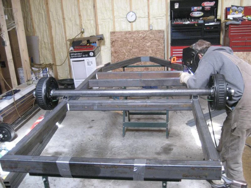

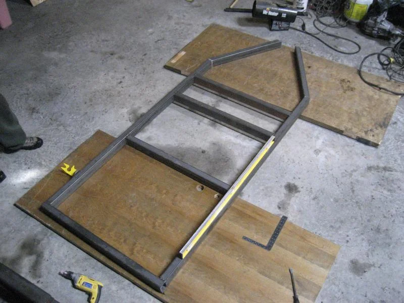

Here are a few more photos thanks the thread on independant suspension. Going to be riding on Slam Specialties RE-6 air bags, 3500lbs axles from Standen's with the electric brakes and 6 bolt patern to match the Cruiser, Hub Shells and bushing came for the suspension from "LT" at Metal Tech (which means that while I was getting them I also ordered Hyperjoints for the next cruiser project).
In the photos we got the first frame assembled, then used it as jig for the second frame, both frames still welded together.
Okay have to figure out how to post more photos.
Scott

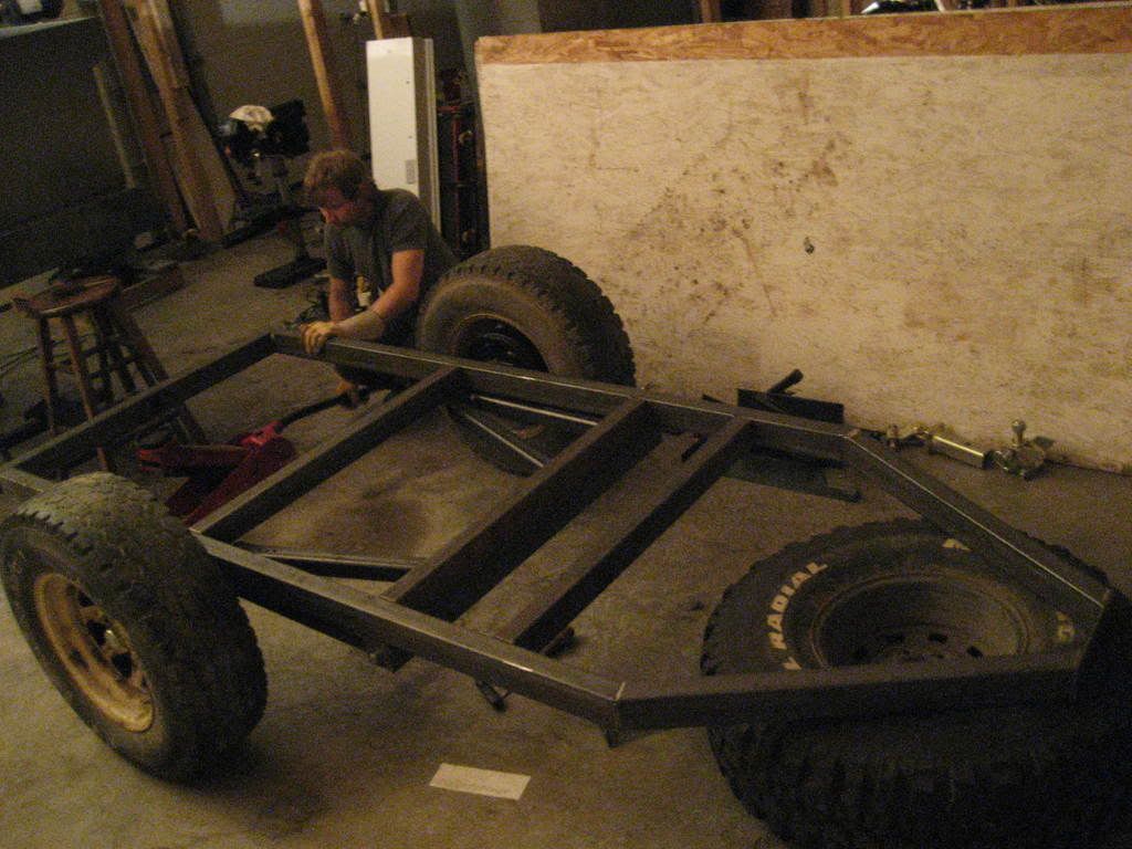

Got some more work done this weekend added some progress photos to the photo bucket link. I will try to copy some of the images here.

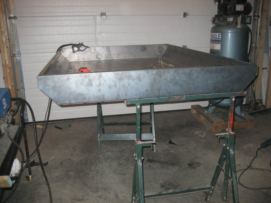

Starting the tailgate and built the second box. Everything is tack together, so I will be spending time on the welder getting all the seams welded up. Also need to weld up some brakets to mount the AirBags to the frame.

what gauge metal for the tub?

Do you have a brake that big or are you out sourcing your bends? Looks awesome, and light!

Quote:
Used 14 gauge hot rolled for the box, and 2"x3"x1/8" tube for the frame

Quote:
Did all the designing with solid works, took my the plans in to a sheet metal place. Had it all within a couple weeks, some assembly required.

STB Power Systems is on a distinguished road
Hey Guys,
Got a little side tracked, finally got the electrical inspection done on my garage so I now have my perminate service. Which meant I was able to start sheeting the inside of the shop.
I did have a welder friend visit for an afternoon, he welded up most of the box seams for me, much quicker and cleaner than I could.
