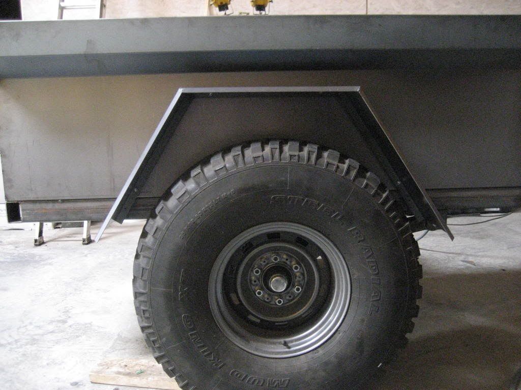

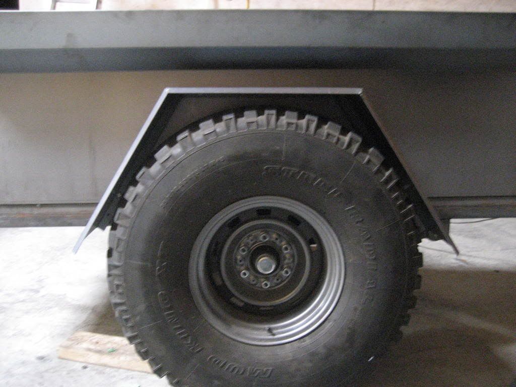

and even more,

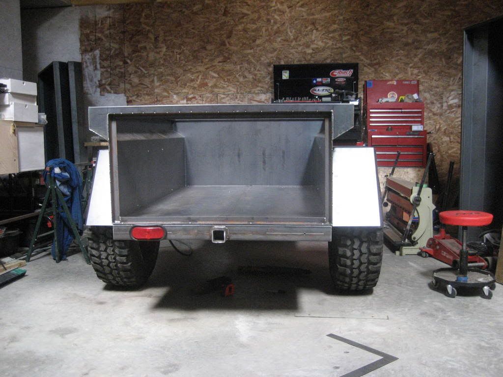

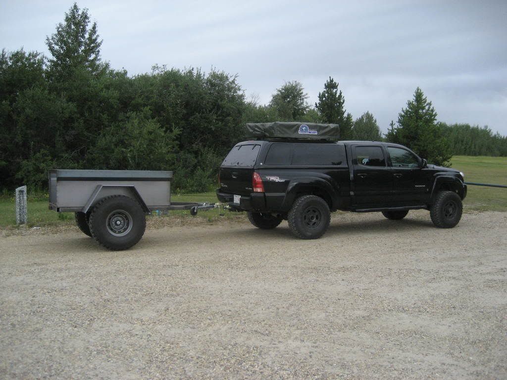

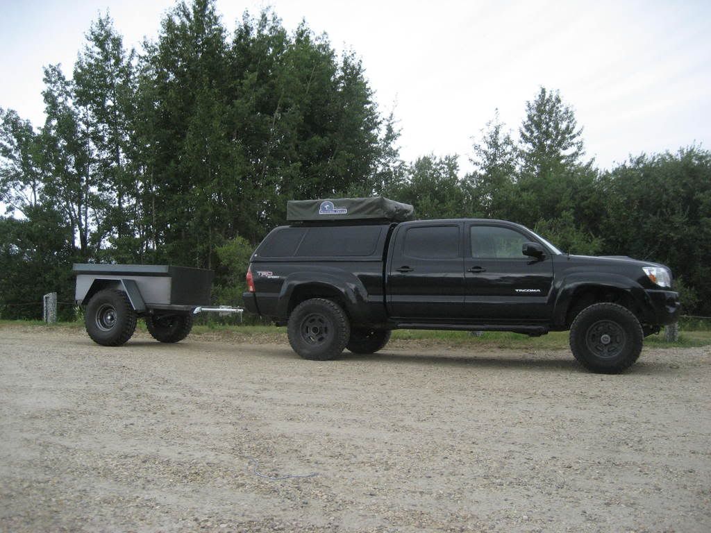

And finally took the trailer for a road test, 70mph on the highway, 50mph on a gravel road, trailer towed well. Only problems i had is the fact that i have no weight in the trailer and no shocks mounted yet, trailer was very bouncy in town.

I started off with a straight axle made the trailing arms and mounts on the frame then cut the axle. For the bushings i purchase the hub shells and the bushing from metal tech, the bushing are from jeep xj lower control arm.
The first road test was a bit scary, trailer was very bouncy in town (no shocks and 35" mud kings) and having the lock and roll hitch, i knew that if it wanted to roll over it could. Over all the trailer towed very straight, I will find a set of shocks next time i am home then try the road test again.
