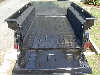

Posts: 8
Try POR15 I used it on my M100 trailer
www.7slotgrills.com/m100project.html
The bed was rusty but in one piece/ I just painted the bed
with RustO Dark Olive

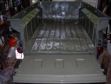

The back of my M100 was cut out when I got, it so I welded in a a CJ7 tailgate. I had to add pieces of steel on top to follow the lines of the trailer. Those are factory cables from a CJ7. I used
after market stainless steel hinges so they open everytime and won't rust up.

I'm new so I guess I can only post so many pictures. I wanted to post the tailgate.
