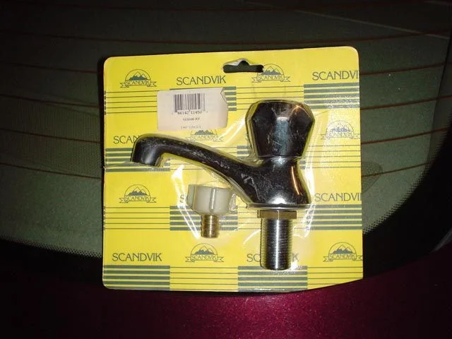

Posts: 2,857
I have loved that design and plan on copying most of it
Photogod- what kind of faucet you running?

Old 04-09-08, 11:58 PM   #5
I'm really very humble
photogod's Avatar
Join Date: May 2004
Location: MN physically, MI spiritually
Posts: 1,339
I kid, I kid... Had to stall whilst I took a photo for you.
I have a couple extras for more kitchens that were not made. If you like this and can't find one let me know and I'll cut you a heck of a deal. I'll even attach a kitchen to it.
Faucet was from West Marine, solid brass with a heavy chrome plating.

Do you have a leg or kickstand to hold it up? I would assume you'd keep one end on the trailer and suspend the other?
Man, I love that design. On the faucet, I need hot and cold to make my future plans work

I have fold out steel legs that have independent levelers for each leg so the unit is free standing and can be used on very uneven landscapes. The link is where i got them. It was the best price I could find. I had to do a bit of mod on the width, ie. cut them down to fit the width of the kitchen. I ordered them in black and repainted after rewelding them together. They fold up and fit inside the oak runners.
We went with the one faucet design because the width if the unit was to thin to put a double in. The width was determined by how many pieces we could get out of one sheet of plywood.
