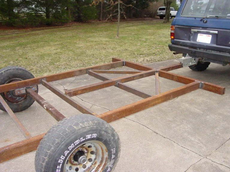

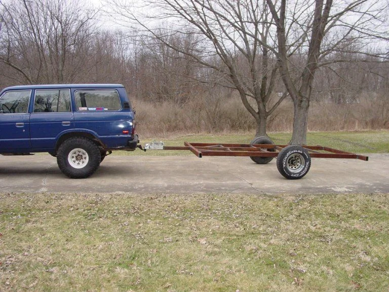

I've just finished throwing together a flatbed utility/car trailer. Well, nowhere near finished, but at least on wheels.
It has a DICO surge coupler and a single 5200# dexter Torflex axle w/ 12x2 hydraulic drums. Cruiser 6-lug pattern, of course.
Does anyone know anything about connecting the hydraulics? The brakes move, relative to the rest of the trailer, so there must be a rubber hose connection from frame to backing plate, but I don't know what should be used. A review of the mfgrs. websites was almost useless as far as brake line info goes.
I'm hoping there is some generic GM brake hose that can be used to make the connection from frame to drum. Trying to avoid buying the $100+ brake line kit for single axle boat trailer. LMK if this is a problem that can be solved w/ a simple trip to FLAPS.

Good suggestion. The problem right now is I don't even know what to ask for. I'll do some more investigating to see if the thread in the MC & wheels is double flare or crush washer or NPT...
Quote:
What kind of car are you planning to tow on that small trailer... it looks a little short.
It can carry 4000lbs, so anything that will fit on a 12.5' trailer will be fine. VW, MGB, FJ40, junk cruiser carcasses to the smelter...
Quote:
Most car haulers are tandems for a reason... why a single?
We got a super deal on the single HD axle & surge coupler at the local trailer store, so we said "Why not?"
It's a single made in USA axle w/ USA bearings, USA hubs, USA brakes, Toyota wheels (not the ones in the pic) and USA ST225/75R15 trailer tires.
The only failures I've ever had towing, was a korean tire and a china bearing. Good thing it was a tandem trailer. Seems necessary if using offshore parts.
I had a 16' flatbed tandem. Thought it was way too much trailer for my use, sold it.
Got a 14' flatbed tandem. It's still longer than I need, so it's for sale.
12.5' should be just right.
I also do a lot of towing around town, and going around a 90* right hand corner just about tears the tandem axles off a loaded trailer. Not a problem w/ single axle.
And tire/maintenance/brake costs should be reduced.
