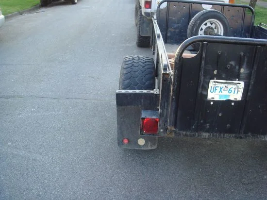

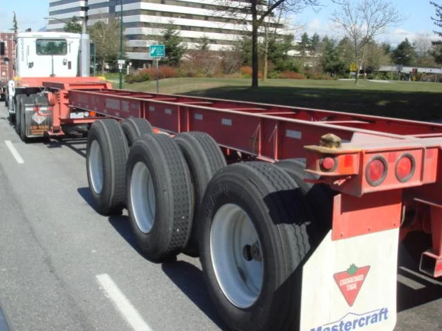

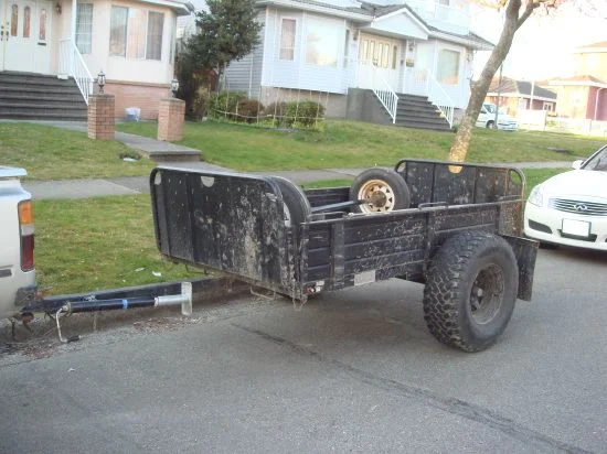

So are the mud-flaps legal or not?
Wondering what you stateside guys think?

Useless without a top, but I don't see how they could be illegal.

Legal as hell in Elwood, TX ... but then again ... anythang is.
Generally speakin', I believe most law enforcement personnel would prefer to see fenders rather than mudflaps.

Not legal in Oregon. Have to have fenders unless there is a body above the tire.

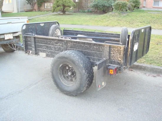

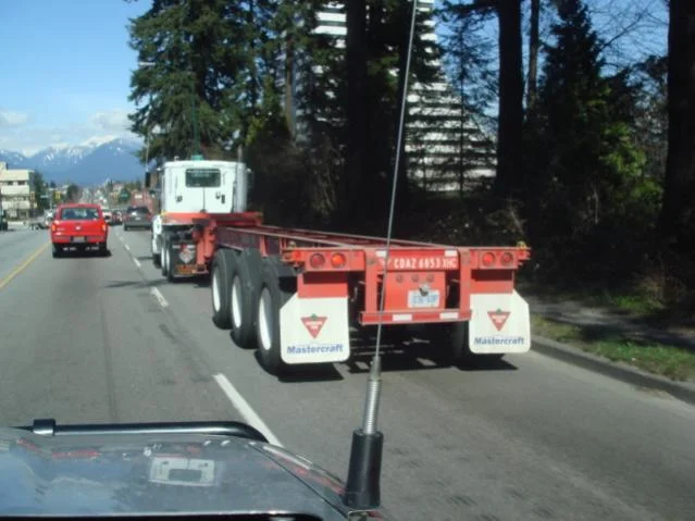

How about this one, both it and mine are insured commercial, I use mine for my construction business...

Well, in Oregon, container trailers do not have to run fenders. Specific exemption. Mud flaps are required, though.

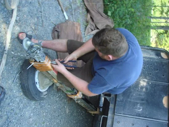

The one problem I have seen on a few of the SnowBear trailers with the extendable tongue is that the welds on the front trailer/tongue bracket tend to crack. Might be something to look at on yours.

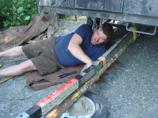

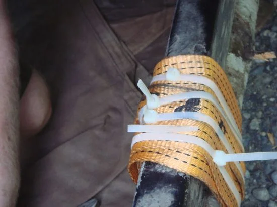

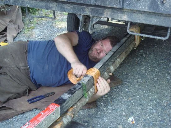

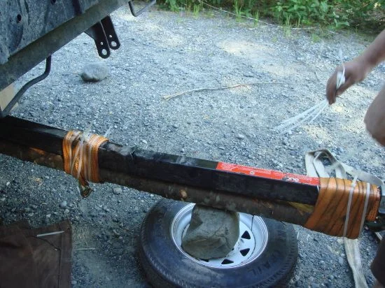

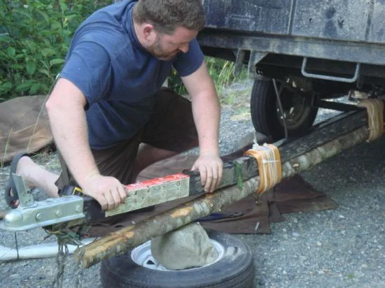

Yup that happened already, 400 clicks and a ferry ride from home too
Still made the last ferry of the night and have since replaced it with some 3x3x3/16 wall tube

Couple more

That's a bad ass trailer. Are those common/available in the US?

How much weight caused it to buckle? or was it the constant overloading.
I have one and worried about the same thing.

Had way too much weight on there, But i agree it is a weak link on this trailer and if you use it allot I would recommend replacing it.
The front and rear door is removable on these trailers and is a very cool design in that it also doubles as a loading ramp.
Oh and it also tilts too...
