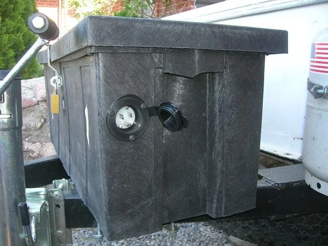

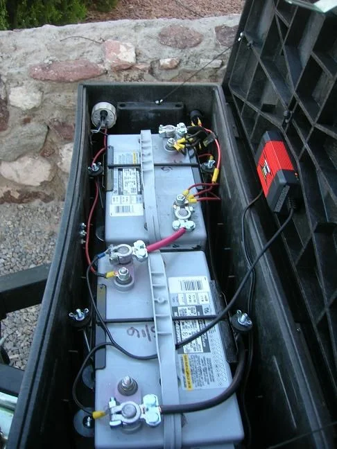

Here are some pictures of a battery box setup I did up for my M 416 trailer. I found a plastic box in my garage and found it held two Gp 27 96 AH batteries. I mounted the batteries in the box wired them in parallel added a 2 AH charger/floater to charge and maintain the batteries.

I can see how it might work, but you can also run a wire from your existing alternator and skip the whole windmill effect. The top of that box would be about the perfect size for a solar panel as well.
Brian, have you seen the little windmills for power that you can raise up on an RV or tent trailer? Same idea I guess, do you have any pics of the setup you are talking about?
mep1811, any more info on the gauge you are using, where did you get it at?
