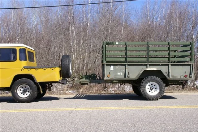

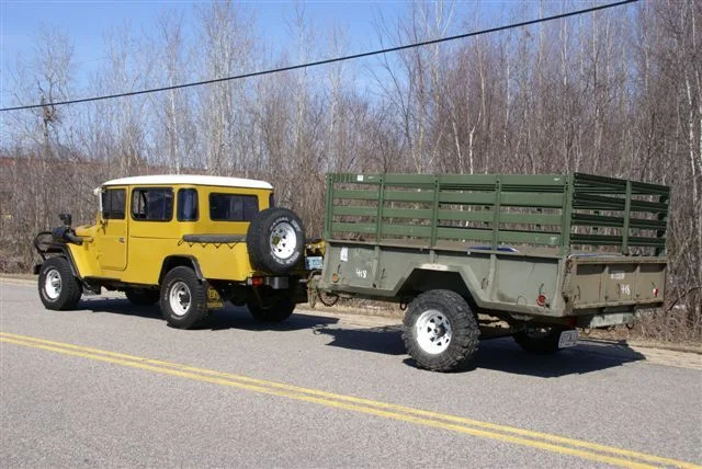

Just finished modifying this trailer. It is not an expedition trailer for trails, but a utility trailer for Home Depot, leaves, firewood, mulch etc. Changed the axle, put toyota wheel studs and lugnuts. Make no mistake; the M105 is large and heavy, but fulfills my needs perfectly. Price on Government Liquidation was right, and it came with new racks, bows and tarp.

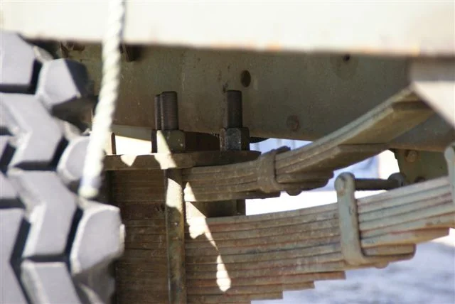

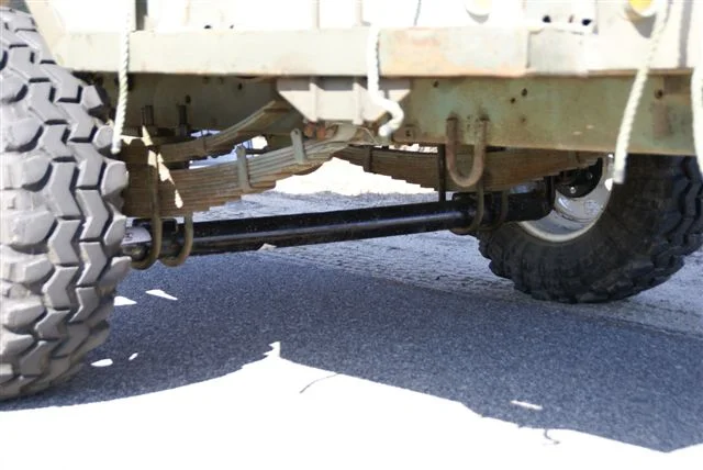

axle is 5200lb axle with 4" drop. Had to use a die and thread another inch on the ubolts in order to account for the difference is axle diameter.

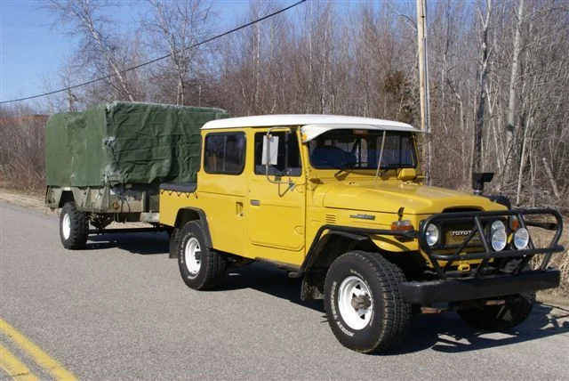

Rovers....this is one of my favorite set-ups. Hope to get some similar tube work.
Trailer is mostly towed behind the FJ Cruiser. I have hauled a cord of wood, but the largest load was a 3 yard bucket of compost; pretty sure it was overloaded that time.
