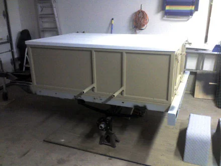

Location: Kansas
Posts: 175
camera phone pic

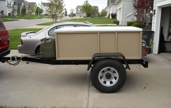

Location: Kansas
Posts: 175
pic as promised

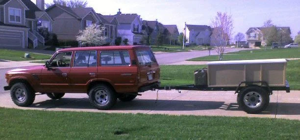

Drew
here is one of the trailer with one of it's future tow rigs

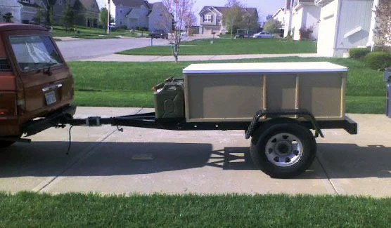

Posts: 175
and another

TLCA# 7236
Posts: 601
Looking good man, plus your Cruiser is just the right color!

Quote:
73fj - thanks!
the 60 is not OEM red but rustoleum regal red pretty close match though.

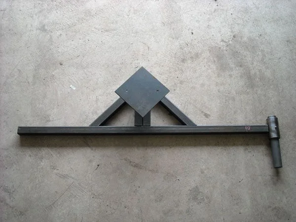

Old 05-06-08, 05:26 PM   #110
IH8MUD Junior
Acadia's Avatar

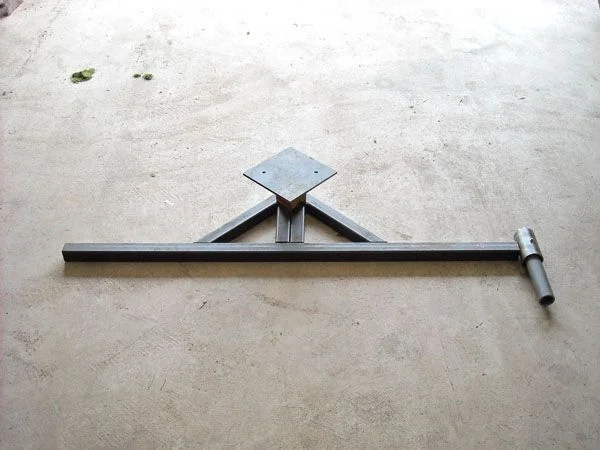

Join Date: Jul 2007
Location: Kansas
Posts: 175
Alright here are some pics of the swing out mock up.
I think I will ad another piece of tube from the spindle over to the tire support. to give it a little more support.

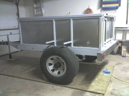

Old 05-06-08, 05:28 PM   #111
IH8MUD Junior

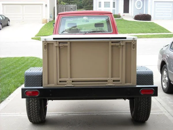

Acadia's Avatar
Join Date: Jul 2007
Location: Kansas
Posts: 175
here are a couple better pics of the trailer.

Old 05-06-08, 10:21 PM   #112
IH8MUD Lifer
REZARF's Avatar
Join Date: Sep 2003
Location: Louisville, CO
TLCA# 13041
Posts: 2,857
Did you box in the back of your bumper? You might need to for the tire swing out. It is amazing how much flex a tire can produce when it is swung open.
Drew

Drew - I didn't box it in.
I will be welding in a sleeve for the spindle. It will go completely through the bumper. I hope this will give it the rigidity it needs. If not I guess I will box in the bumper but that will make it a real pain to get the light housing in and out

Quote:
how has your trip?
Yeah, I would brace it up as much as possible, I was blown away at how much leverage is created when you swing a full size tire out on a swing arm. I bet the sleeving would help a lot. Maybe you could add a few gussets to the sleeve even. Just think beefy. If it flexes a lot it won't open and close smoothly, and it will bounce all over on rough terrain. Looks like a great addition to an already sweet trailer bud.
Moab was Moab, which is AMAZING!

Quote:
Originally Posted by REZARF View Post
... I was blown away at how much leverage is created when you swing a full size tire out on a swing arm.
Another wonderful example of one of them force times distance thangs.

got the swing out about 90% fabbed up now.
I am waiting on the latch. and I need to make a stop to keep the swing out from swinging to far around and hitting the side of the trailer. Then I will throw some paint on it and the bumper, plus touch up some the trailer box and call it good for now!
I put the extra support bar from the spindle over to the tire mount and it made a huge difference. before I did this I was getting about .25" maybe a little more of flex in the swing out at the very end. Now zero
here is a pic of the work so far
