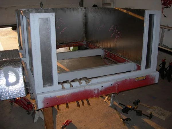

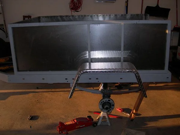

Well after a very nice Easter Brunch I made a bee line for the garage to try and get the sheet metal attached today.
I had decided awhile back to spot weld the sheet metal onto the frame. I had concerns that if I used rivets that they might work themselves loose. This may have just been me imagining things
anyway I drilled a line of holes around the perimeter of the sheet to use as my attachment points. Clamped the sheets on the frame one at a time and proceeded to weld them onto the frame. using the holes I had drilled as my spots for the spot weld. 6 hours later I am done
Here are a few pics of the finished product.

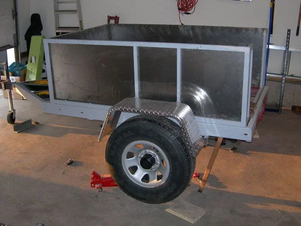

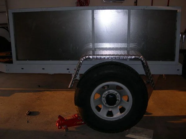

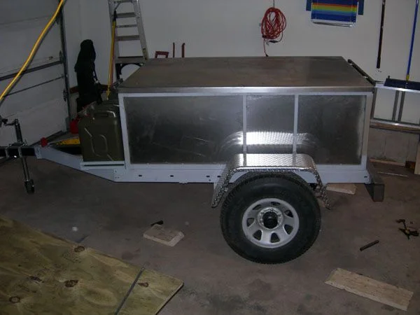

Here are a couple more pics with the wheel thrown on.

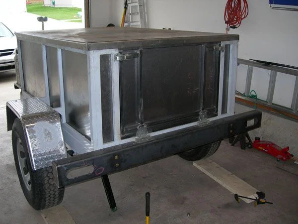

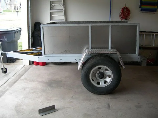

Been busy this week and havn't been able to work on the trailer much.
I did manage to sneak in a little garage time though. rear bumper is on. Just need to cap the ends and cut out slots for the lights. I should be able to get that done this weekend plus build the frame for the tailgate. anyway here is a pic

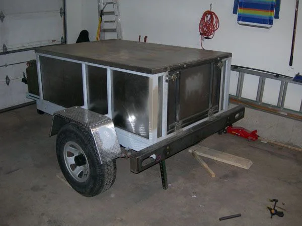

I managed to get the cut outs for the lights done today and the ends of the bumper capped off. I am debating if I should go ahead and seal off the back of the bumper or just leave it open.

I would seal it, gives it a more finished look, but thats me.

That is kinda what I was thinking as well.

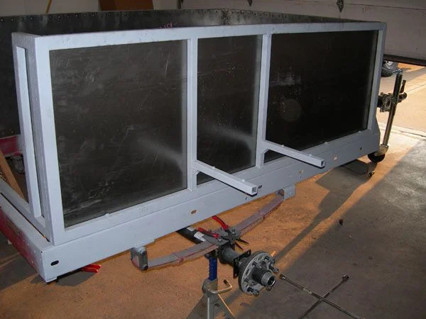

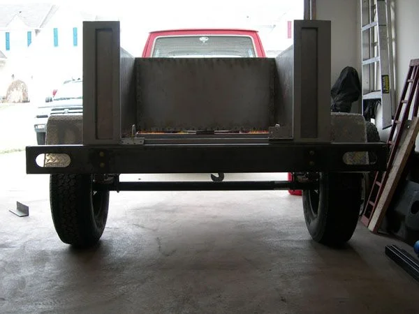

I picked up the lid from the fab guy today. I had him make me a basic tray (for lack of a better word) all I need to do is weld the corners and it will be almost done.
I am having second thoughts about the frame I was planning to build to mount the tray to. I am now considering using a sheet of 3/4" plywood and attaching the tray to it with flange head bolts and T-nuts. i think this might actually give it more strength and help prevent some dents. anyone have any opinions on this?

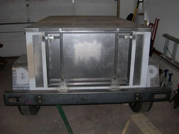

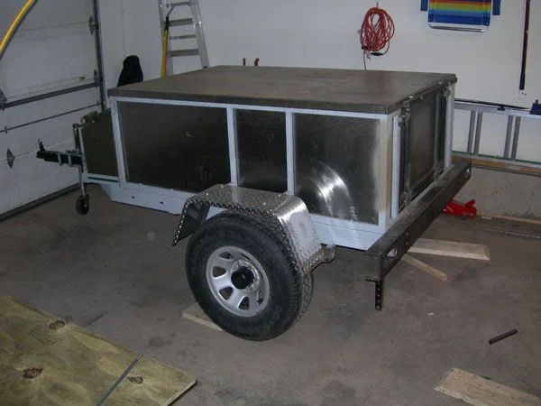

I made it out to the garage this afternoon and knocked out a few things.
- finished welding the frame for the lid up.
- tacked the lid to the frame.
- hinges on the lid.
- finially started the tailgate, still need to finish it though.
So hopefully by the end of this weekend I will have the major things done.

Tailgate is finished

pic update
it is getting close!
added a handle to the lid.
did a paint sampling today. I am leaning towards the khacki color for the entire body, black on the frame and a nice flat white for the lid

couple more for good measure.
