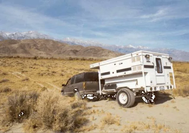

James I think you have a great idea, I looked through pages on ExPo just now trying to find a pic that had a FWC slide in mounted to a trailer bed. Here it is, could be a good place start. I would fill the gaps down low with truck boxes!
As for what you can tow, Overall weight is very important, the 2f is a good tractor motor but leaves a little to be desired when towing a load. I bet you'd be fine with how you are calculating your weight.

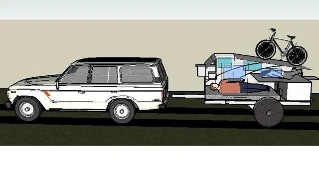

my trailer
this is what I am thinkinig. it will be 5ft wide, 10ft long, 5ft tall

phlyfish is offline   Reply With Quote
Old 02-04-08, 08:14 PM   #22
IH8MUD Lifer
sseaman's Avatar
Join Date: Sep 2006
Location: Nashville, TN
Posts: 1,372
I had run the same ideas, and was going with a drop floor to have room to stand up inside

Quote:
ahhhh sketchup

I am looking at running a 6ft x 13ft x 6ft trailer, I am going to place two 52" x 72" beds on the floor with a 24" x 72" walk way in between them. I am going to place a bunk bed above the forward bed with about 36" of space between them. This will allow me to sleep the entire family of 5. I will also be running a Galley off the back as well.
I need to make some drawings of this.

Posts: 6,179
That upper bed is kinda funny looking. Could two not sleep down low? It is 5 feet wide. My wife would never sleep up top like that. Claustrophobic comes to mind...
I like your sketch up though. But I would use the upper part for storage.
