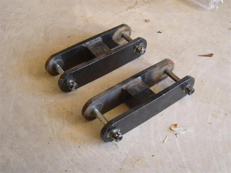

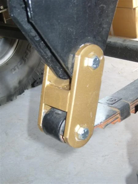

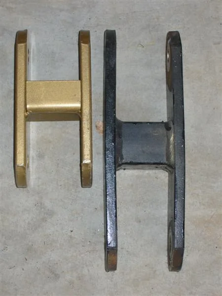

I built my expedition trailer to match my SOA FJ62, but now I'm going to be towing it with a UZJ100 and even after the lift and tires, the height is off. To help correct this, I replaced the extended shackles I installed back in 1996 with a shorter set from Rough Country.
It was a half-banana job and the end result is the trailer sitting 2.25" lower. I expect another 1" reduction from the change in tire size, and then I'll play it by ear. My goal is to have the trailer to ride as even as possible with the loaded 100.
Here are a handful of pictures. If anyone wants the extended shackles I took off (Daystar), I'll take $20 and you pay shipping, an easy way to lift an M100 or M416 without having to go SOA.
You can see the size difference between the two sets of shackles, and a close-up of the new shorter shackles installed.
