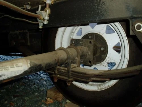

Can I just flip this axel???
Title says it all.
Its on my starcraft (small) pop up.
Im not sure if the alignment pin will be on the other side (small leaf)
I know about zero about leaf's
Thanks,
ken

You will need to buy new spring pins, but, yes, you can. Clamp the spring pack together with C-clamps first, remove old spring pins(maybe you can reuse them) install new ones upside down from the way they are installed, flip the axle.....voila!

Can You. Yes.
Do you want too. No
Most all trailer axles are built with a slight tow in in the front of the axle. If you flip the axle you will be towed out in the front. It will be all over the road when you pull it.
If you flip the axle side to side 180degrees and trun it upside down you might end up with tow in towards the front. It's been a long day and I'm not thinking clearly in three demensions. I think you will still be towed out in front.

I can't picture that. If the axle has slight toe-in and zero camber:
1. flip it 180 degrees on its axis, top is now bottom and front is now back, and it should now have toe-out.
2. rotate 180 degrees (viewed from the top), back returns to front, and it should have the original toe-in.
Of course, this only works if camber is zero.

That is what I was thinking. I drew it out on paper and it looked right. (I'm at a Hampton Inn instead of a Holiday Inn so I'm not thinking clearly.)
I do know that I put my very first trailer Axle on wrong. I had to flip it around 180 degrees.

Just to make it clear; Flip it upsidedown and rotate left to right.
Ya?..

Yep.
Measure the outside of the wheel in front and back. Do it in the center of the wheel.
This is just to make sure you have toe in.

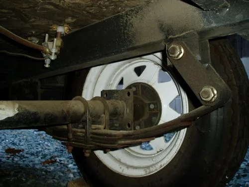

I have a small Jayco pop-up and I just went spring over. On mine the axle had camber with no caster I could see. So I cut the spring perch off and moved them on top of the axle. The center bolt on the spring pack did not need to be flip, the nut fit into the index hole on the perch. Packed the wheel bearings while I was there and it took about 2 1/2 hours by myself. Pick up 4 1/4" of lift
That would be the easiest. If he has a welder.

One thing I failed mention...when it was all done the tongue jack would not raise high enough. Another 1/2 hour extending the the post on the tongue jack so I could get the trailer off the truck.

Soooo... would it be better if I welded on new perches on the top, and not mess with moving the axle?
Good point on the jack extension, I will be installing one of those QD and Quick flip jacks that works off a spindle that is welded on the side of the tongue.

Ken by relocating the perch the factory caster and camber of the axle will be the same. No guess work...
