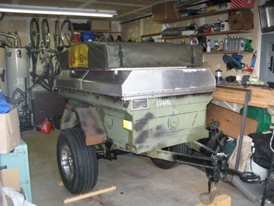

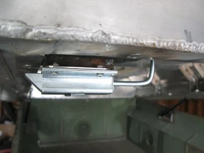

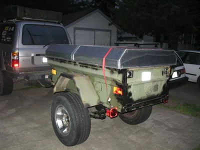

lid will be water tight when im done (hopefully)
Im using a rotory latch that has to latching points on each side of the trailer. this mean i can still open the tail gate with out popping the top. heres a few ruff shots

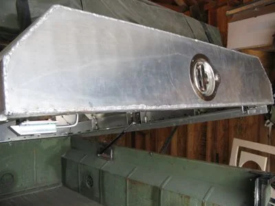

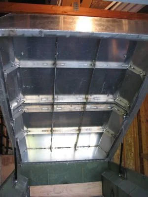

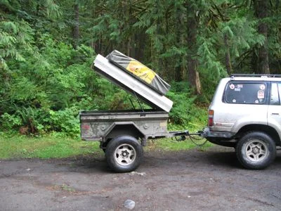

heres a few more i have on my comp now
thing ended up bein much lighter then i expected so when i ordered the struts at first i thought they were going to be way too powerful but i just moved them in board more and now they work great.

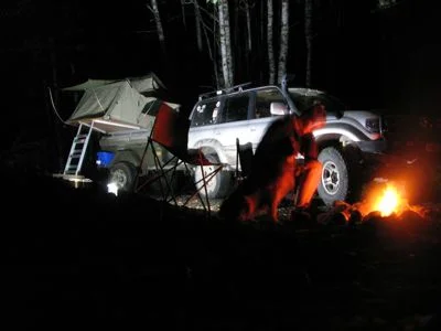

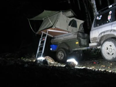

well I couldnt stand it and took the trailer for a "shake down run" everything went well except i really need to get mud flaps for my truck. The trailer got some serious mud. heres some pics of the weekend

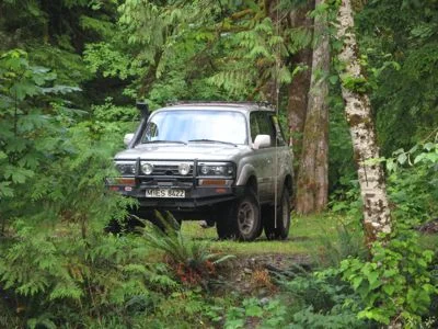

more pics

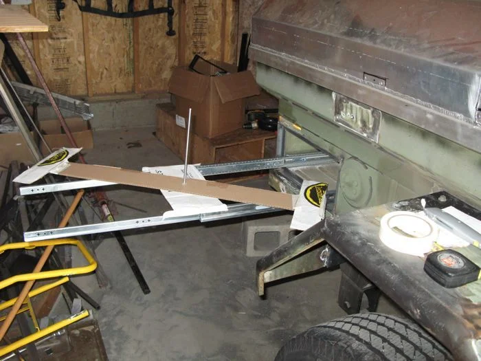

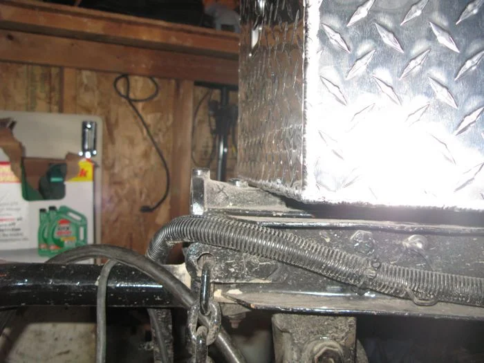

update, i started work on the kitchen, picked up a pipe bender and have started a bit of the drawer already. Im going to build the drawer frame out of pipe and cover the top with sheet metal, the sink and stove will be in the drawer. Some of the issues i ran into was the pipe bender cant make the right angles tight enough so I' had to modify the design a bit. Since the hub swap and the matching land cruiser wheels and larger tires I had to widen the fenders about 4 inches and loss the accessability of the drawer that i wanted (who want to lean over a fender to wash the dishes?) so the drawer will pull out of the trailer then rotate to achieve an easier angle.
Heres some pics of the ghetto templet dont mind the drawer slides pictured i have something else in mind

Hey man, Sweet trailer! I'm loving the lid. I think I might copy your design for my expo trailer. I've got a guy with a break that will make the bends for me for free and a guy who will weld it for free too. So I won't have alot of costs associated with the fab-up but I have no idea what a sheet of aluminum would cost.
Couple questions:
1)What kind of struts did you use to aid lifting the lid? If you have the make and part number available that would be fantastic.
2)About how much did the sheet of aluminum cost? What grade was it? Was it easy to weld?
3)How sturdy is the lid?

The aluminum was free
I have a buddy that is a welder for an aluminum boat company and he saved me some sheets for me from there last project. Id say its 1/8" or so.
as for sturdy Id say its just as strong as any of the steel lids ive seen. the tent weighs about 100lbs, i weigh 200lbs the girl and the dog is another 200lbs and i wouldnt hesitate to put alot more weight up there (the gusseting is the key) As for the struts I have an extra set when i ordered mine if your interested ill sell them at cost. ill see if i cant find the specs on them some time.

Rotating kitchen, what a good idea. You're going to have to be able to pin it in place though.

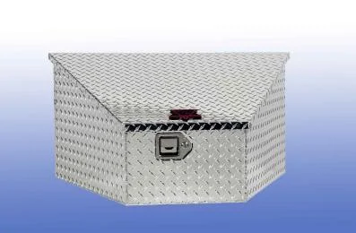

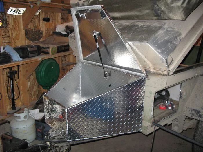

On a side note my nose box came today, Its the slanted front box that is almost perfect fit (ill have to notch the front and weld a bump but other then that it should be a perfect fit.
That is pretty sexy. It's going to look great!

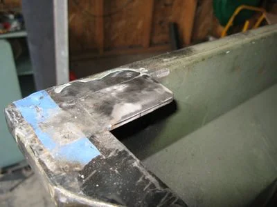

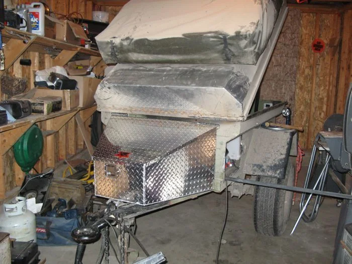

few pic in place i have to notch the front of the box about an inch
