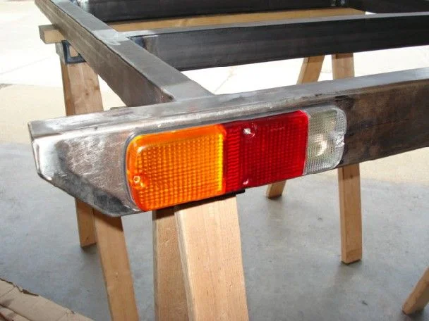

Here is what I am running... not cheap though
They do resemble FJ40 lights, wait, they ARE fj40 lights

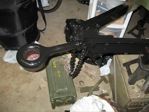

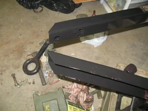

did a bit of work today not much but a bit, i also recieved the lights there pretty slick. im going to mount them in the angled out part of the trailer so it frees up the space where the original ones were for storage and a step. also got the latch to work but still have to do the other side. closes and hold snug really well.

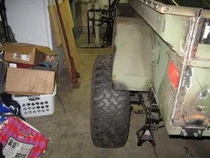

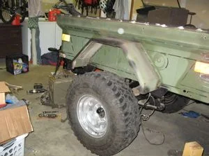

more, i pulled the fenders off the trailer as i plan to widen them about 4 inches for the larger tires, any one done this before and have any tips? not sure how i will go about that yet. also pulled the lunnet assembly off and cleaned it up, primed and painted it just need to re grease and re assemble so it should work nice and smoth now.

Tube fenders?
It might be easier to make tube fenders and then metal sheet them. I have thought about this on my 1943 MBT trailer. Then I could put the original fenders if i wanted to get back to stock.
kent l is offline   Reply With Quote

i thought about this but i dont have a bender so that limits me on that

lunnet re assembled and greased works smooth now
also dry fitted a 31 to measure for the fender extension. looks like 7 inches i need to extend it still not sure what ill do about that.

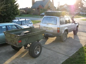

thanks for the hint ordered some up and have already installed them. got the wheels mounted up too, she sits just a tiny bit high in the rear but once the tents off the roof and on the trailer it should be perfectly level

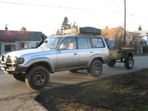

Well just an update threw some cheepo wally world tail lights on it, got it registered and im in the process of doing the top.
the top will resemble the AT trailers and will be tig welded aluminum.

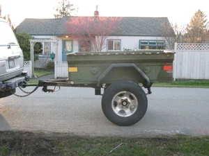

started messing with rhino since i just got it
heres a really basic view of the trailer
