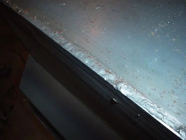

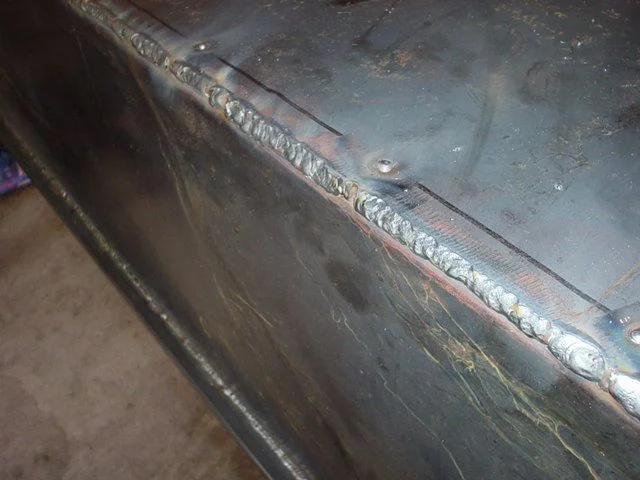

I'm with you there. 14ga is heavy shit, but I guess I put too much heat in the wrong place. I always pucker when welding sheetmetal....and usually, something bad happens
I think I can suck this down with bolts..........if necessary. Have to keep reminding myself.............."Its only a trailer"
Glad someone else feels my pain
Ed
A few pics of the welds.....

TLCA# 13041
Posts: 2,857
Looking great Ed, I can't even see where it is warped. Remember, you will be your own worst critic and see ALL the bad things but no one else will. On my trailer, I have things that I am bummed with (finish wise) and all my friends can't see it, and it seems to GLARE at me. I bet it is hardly noticeable!
Keep it up bud, looks killer!

If it's warping turn down the heat, take your time, and stitch weld it. Don't stress, have a beer, 14 Ga doesn't need a whole pile of hot.

Thanks 73fj................now you chime in I wish there was a journeyman sheetmetal guy here locally.
OK, new question......What is the best prep for having it bedlined, like Line-X, Rhinoliner, etc? I know if you take in a new truck they scuff and degrease everything, but what if you were to prep just for that? I usually use 3M MetalPrep and catalized urethane primer. Can they spray that crap directly over that?
What say you?
BTW 73fj, I am going to use the 110 gas/mig with .023 wire to weld the inside when I flip it. I think you are right, I had the heat too high.
Ed

If you have some scrap from your project laying around do some practice beads. This will help you find a good heat range, plus it will give you some confidence with thinner metal. 0.23 is perfect for sheetmetal.

agrreed .23 is the way to go with sheet metal, also just jump around from place to place and i try to keep my beads on sheet metal to one inch or less, just helps with keeping the heat down.
