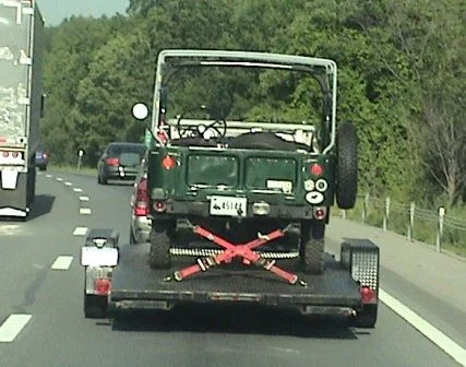

I like the suspension of the loaded vehicle compressed. Towing Report

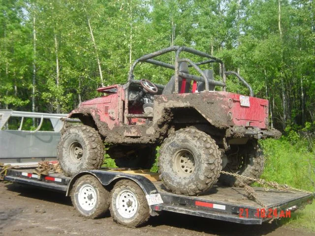

I like the vehicle suspension to be able to work. After doing a SOA I use the old perches as tie down points, I found strapping down on the bumpers I was having to stop and tighten a lot. I have towed many miles like this with no trouble. Its's hard to see, but I'm tied off on my old SUA perches here.

I am not overly fond of criss crossing the tie downs like that. What stops the truck from rolling in a corner??

Hmmm, never thought about it that way. I always did that to prevent a shift side to side........
I think I know what you're saying here, what would keep the load from rotating on the trailer? The same downward force would be applied if you went to the rear or side at the same angle. But, with the straps crisscrossed, with enough upward force so that it began to lift (rotation about that strap's anchor), there would be no stopping it. A strap to the rear would.
Next time I tow I'll try it to the axle with the straps straight front to back.
