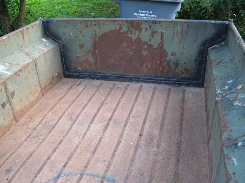

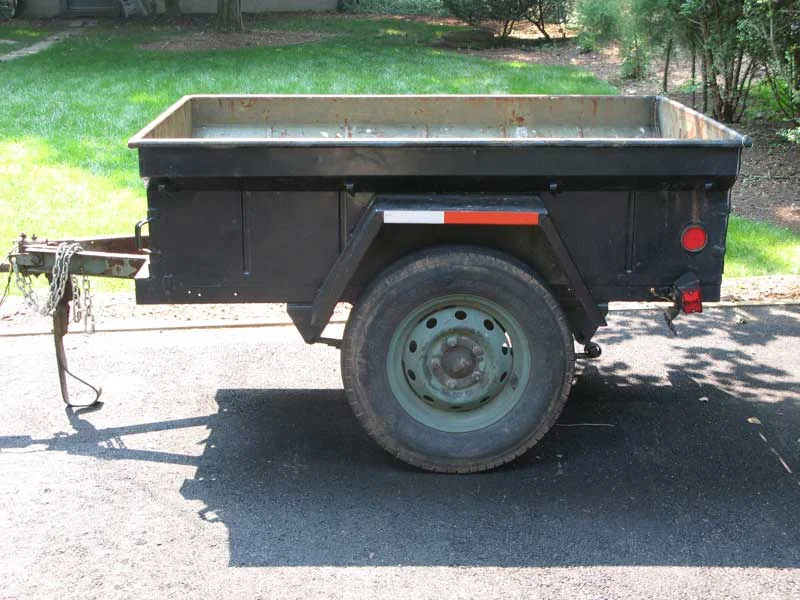

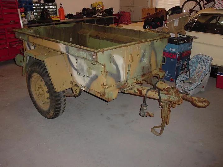

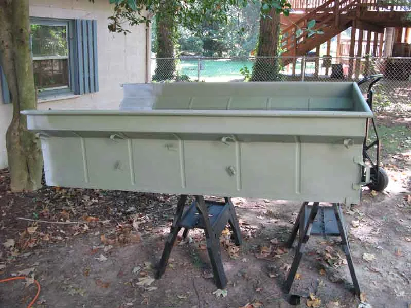

New M416 in Va

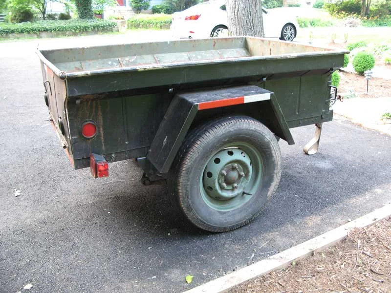

Here's my new M416, I still can't believe this guy sold it for $325 and towed it almost two hours to my door. He said his wife was so happy to see it go she let him buy a new trailer to haul his ATV'S. Enjoy the pic's.

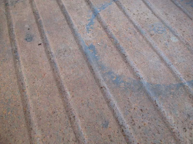

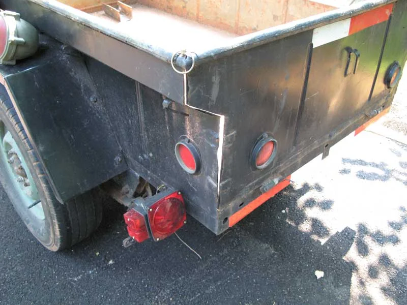

pic's

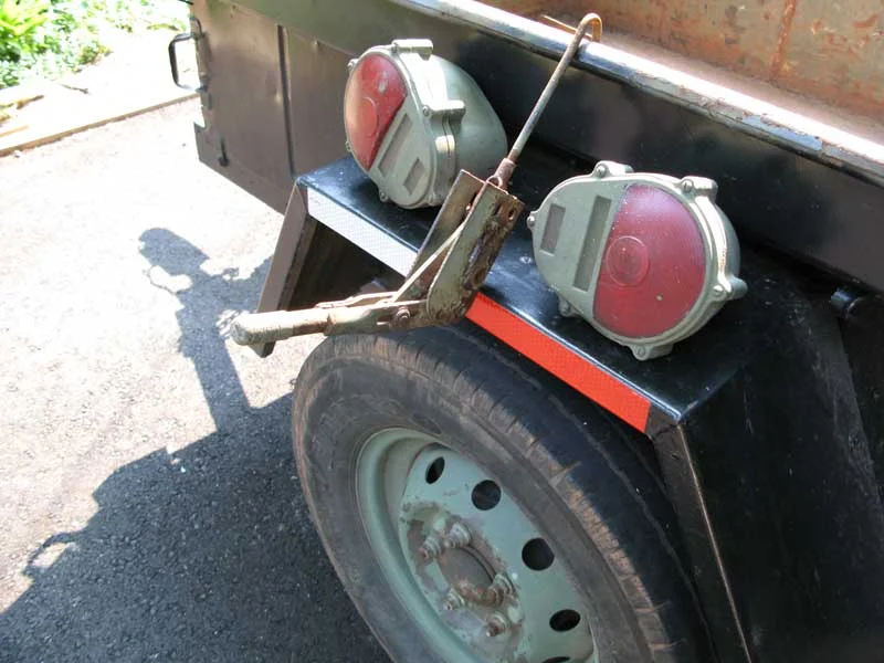

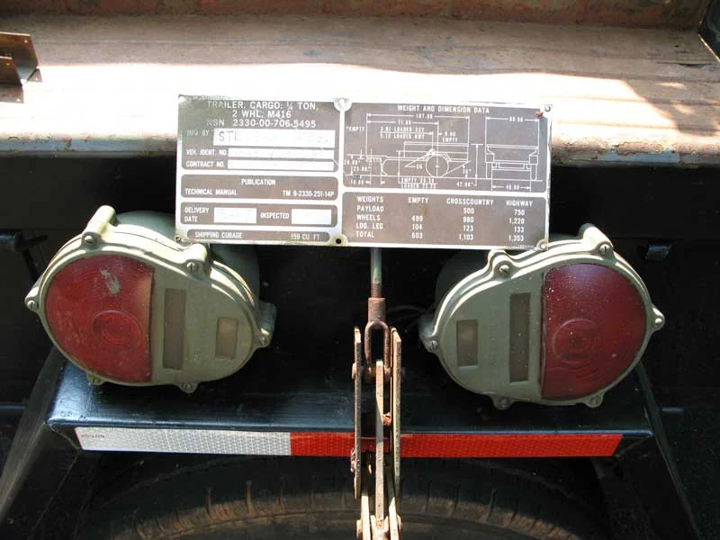

Came with the Military lights, hand brake and the ID Plate. Plan for now is to blast it bare, re fab the tailgate, bed liner and paint it

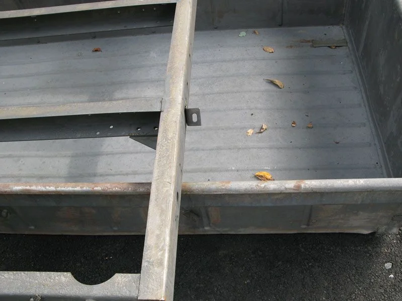

Old 06-18-07, 07:47 PM   #3
IH8MUD Addict
Luke111's Avatar
Join Date: Aug 2006
Location: Northern Virginia
Posts: 670

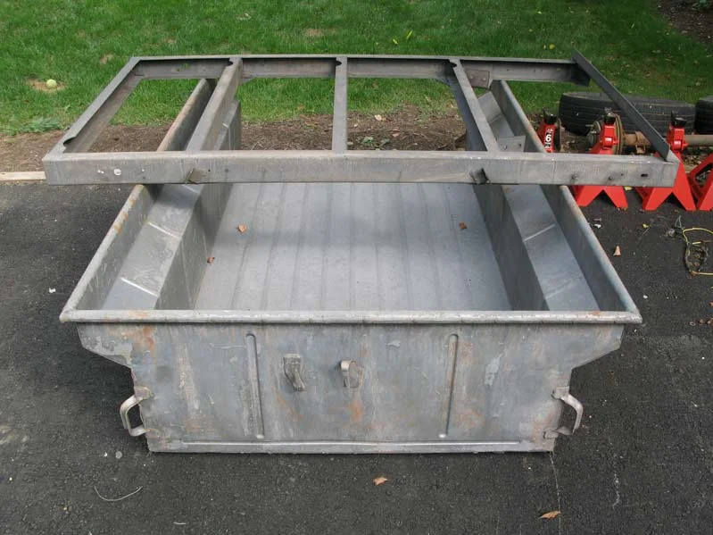

Last shot
Tailgate is in need of lots of help

oh those convoy lights ARE COOL

I would weld that "tailgate" shut and bring it back to original. Otherwise, when you take that river crossing your poor M416 will take on water and sink instead of floating as it is intended to.

Tailgate
I thought about doing that but decided to refab the tailgate . I don't plan on deep water cross in my 55. The tailgate will be usefull for unloading stuff for the house, mulch, gravel etc. I did start breaking down the trailer to the frame today, Its off to Chem-Strip for a little dip. I'll keep ya'll posted on the progress.

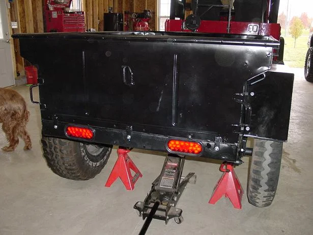

I got just about the same thing.
I paid $400 for mine and the guy delivered it since I did not have a pintle hitch at the time.
His wife was glad to see it go as well.
It's now sprung over waiting for 6 lug hubs and a set of 35's.
1st- just after delivery
2nd- just after a cheap-o paint job
3rd- new tail lights

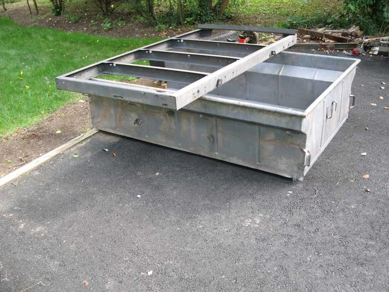

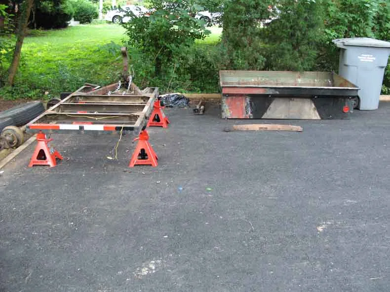

The day started great, broke down the complete trailer, lots of broken bolts, 4 letter words etc... finally whipped out the angle grinder with a cut-off wheel and went to town on the last few stubborn bolts, then the bad happened, It started with a big crack!!!! and a 70 ft dead tree came down in my back yard . About five min later I cut a nice 3/4 gash in my finger when the cut off wheel jumped.
After 4 stitches and three hours at the hospital, Lessons learned the hard way....always hold the grinder with two hands and use leather gloves not shop gloves.
The trailer is off to chem strip next week and I'm ordering the suspension system from Adventure Trailer, stay tuned.

It sounds like you had some bad luck. At the very least you will have plenty of firewood to put in your new trailer ;-)

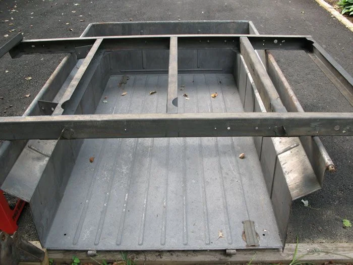

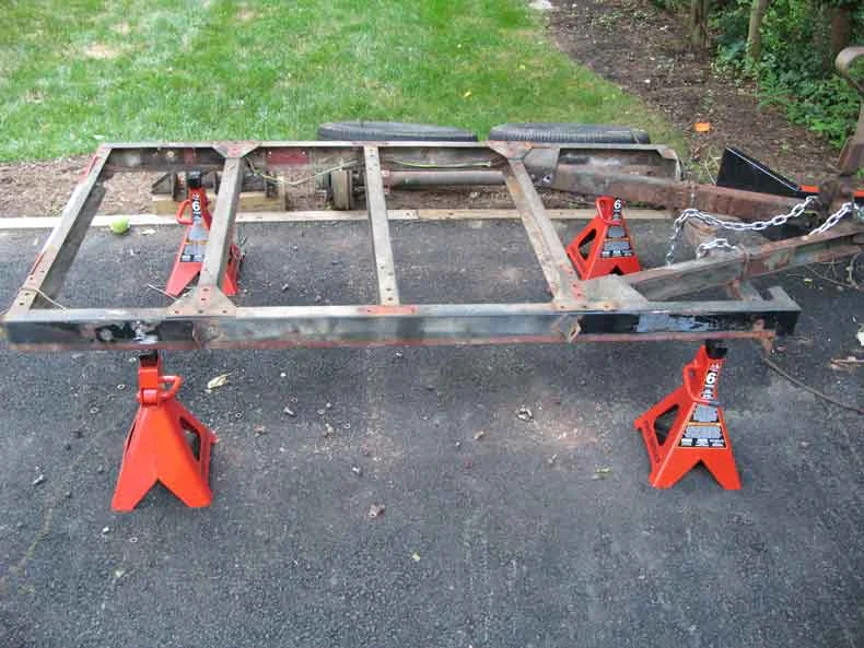

Bare Metal

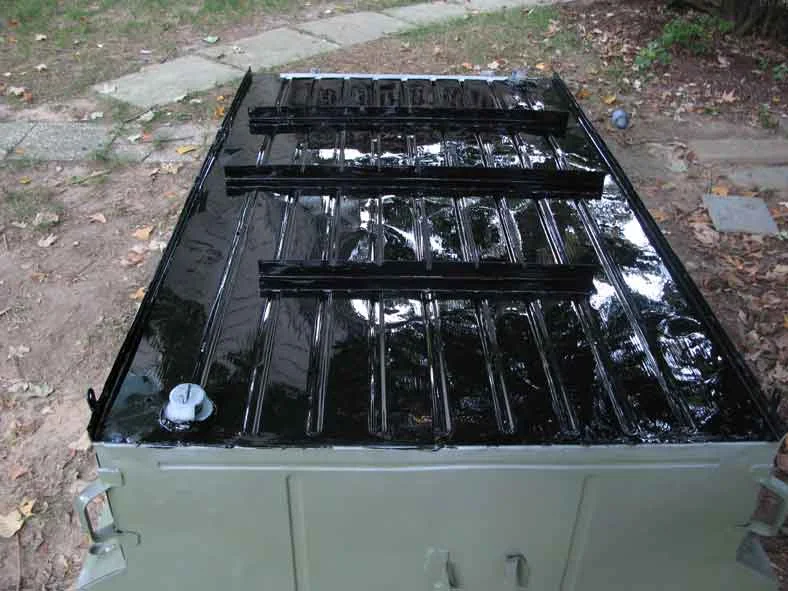

Here's a few pic's of the frame and boxed , just back from Chem-Strip, It came out really nice, all the bed rust is gone along with many layers of paint. They sprayed a thin layer of coating to protect it from flash rust, thers are a few small area's of flash rust as it has set in my drive way for two day's. Plan on shooting some weld-through primer tomorrow then it's off to the welder to fab the extended draw arms and redo the tailgate. BTW taking the advise of a few Mudders, I decided the Adventure Trialer suspension is to pricey at this time, so my plan is to follow what others have done and just order new spings, hubs. etc.
Lou

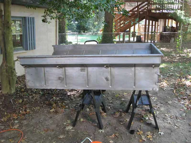

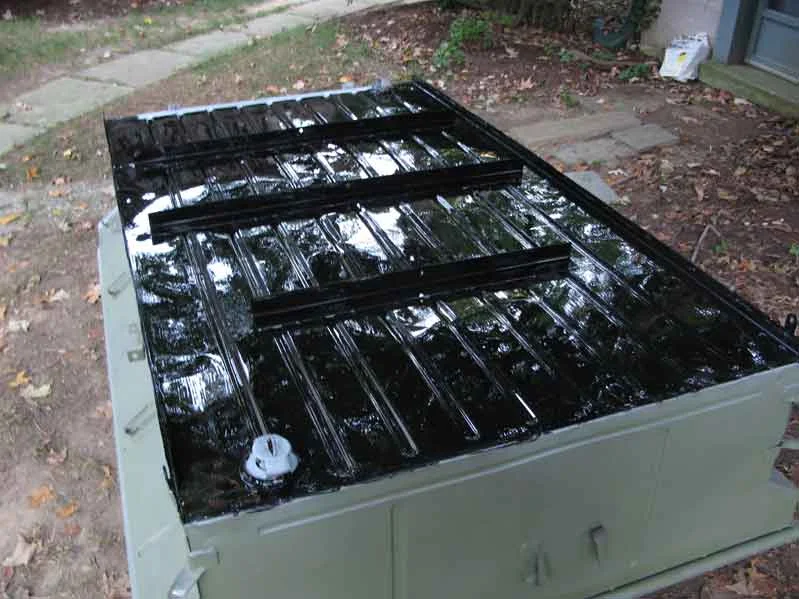

More
Here's a few more
Lou

Looks great!

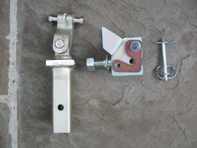

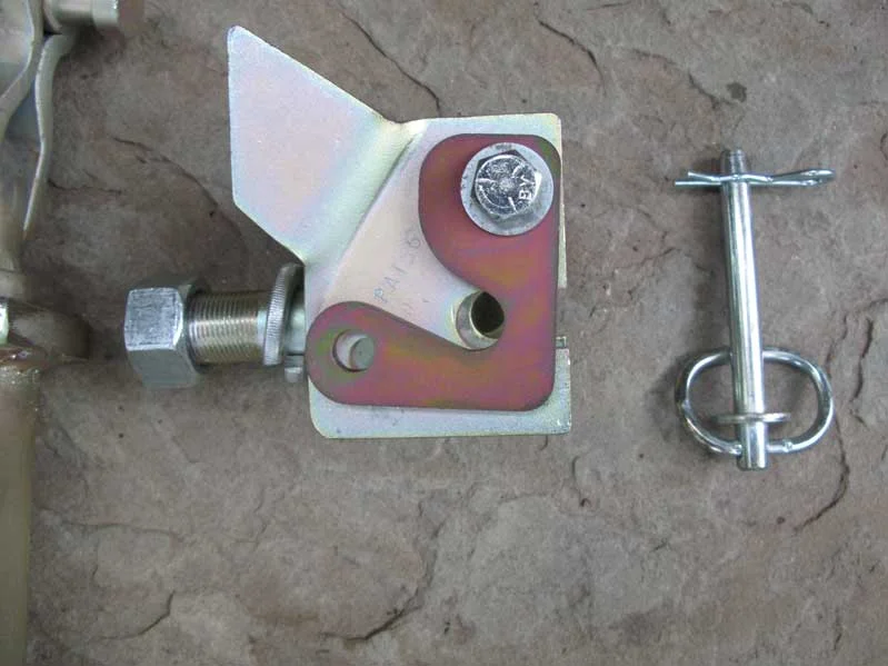

Coupler

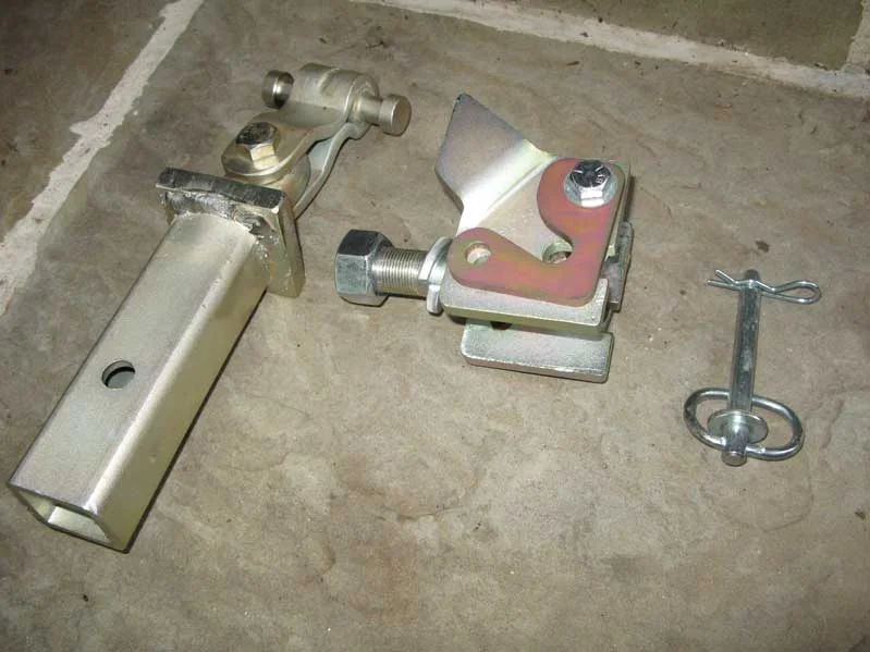

Just received this from Adventure Trailer, 6000 lb Lock-n-Roll Coupler.

What is the advantage of this hitch over the Lunette/ pintle setup?

Quieter for sure. Completely removable for security (although that can be done with a lunette/pintle as well).

Today I sanded the frame and tub, and primed both. The back of the tub and the front of the frame, I primed with weldable primer because both need some fab work.
Lou

Also painted the bottom with a oil base enamal, came out pretty nice.
Lou

Did you bring it to Ready-Strip in Upper Marlboro md or is there another one locally in Fairfax?
thanks
John
colangut is offline   Reply With Quote
Old 10-02-07, 09:04 PM   #27
IH8MUD Addict
Luke111's Avatar
Join Date: Aug 2006
Posts: 670
That's the place, maybe they change their name to Chem Strip, just of the beltway in Upper Marlboro.
Lou
