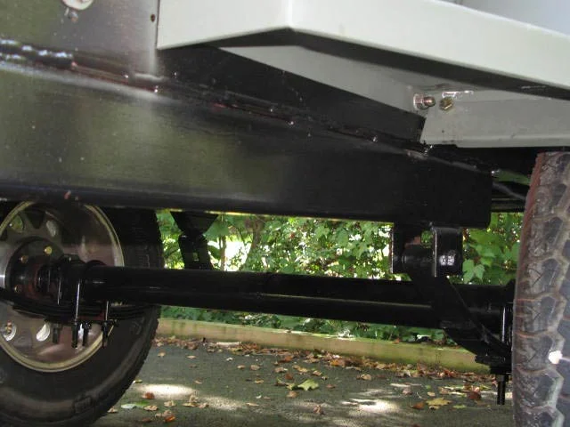

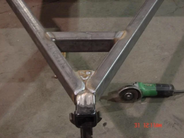

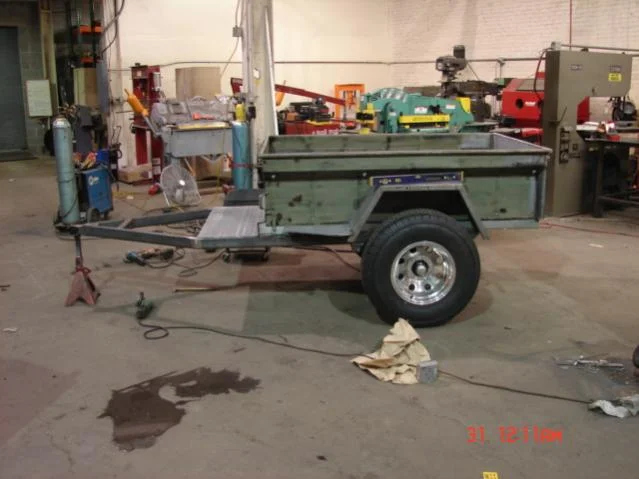

Trailer Update
All the credit for the work goes to my friends Cam and Lance at IronPig Offroad.

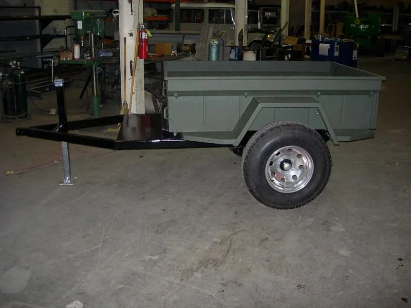

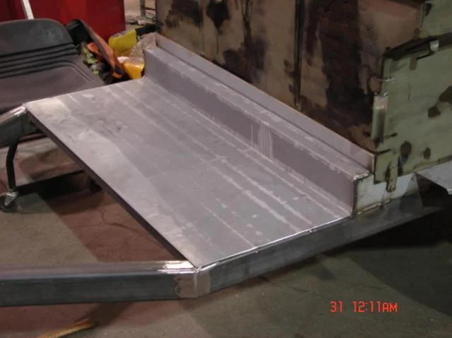

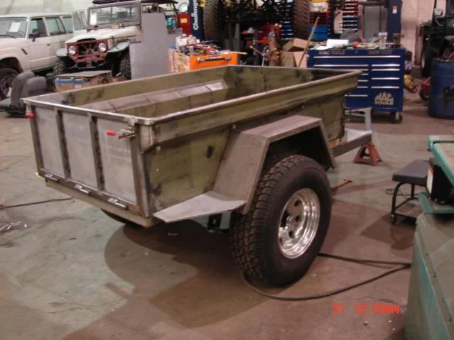

Here's the update , draw arms have been extended, 5200 LB Axle and springs , front and rear fender extension shelves and a front storage platform. Based on current measurements its should sit level hooked up to my FJ55.
Lou

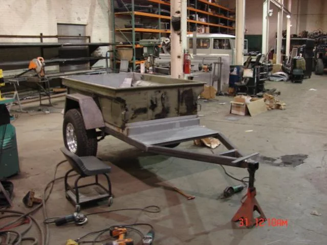

Posts: 670

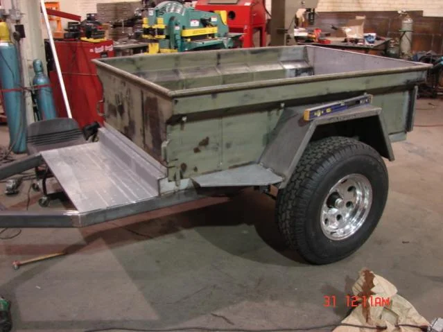

A few more
Everything should be finished in the next few days and then we'll paint it.

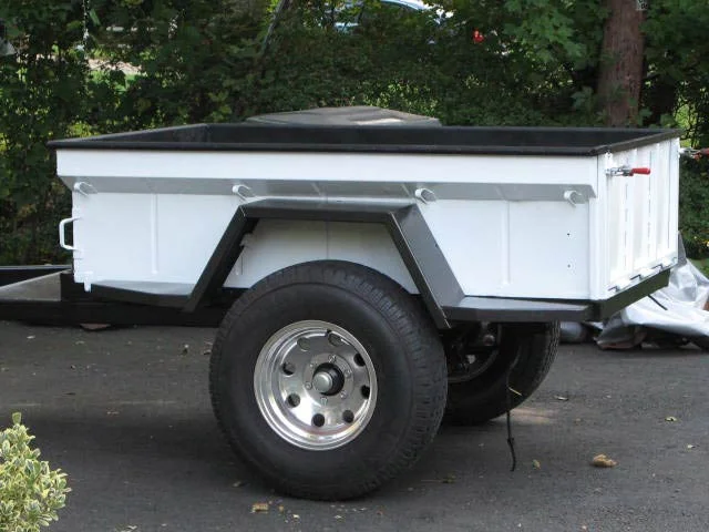

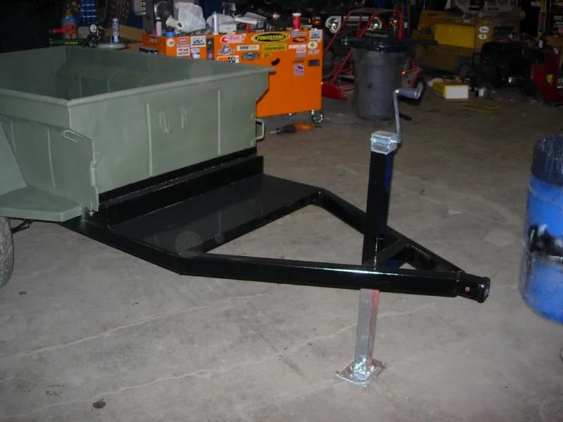

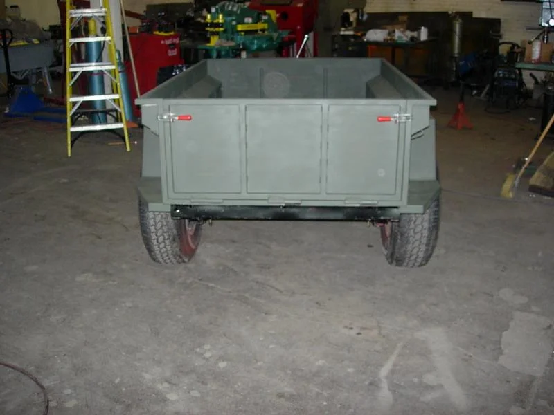

Complete

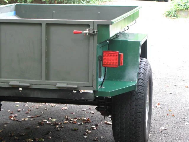

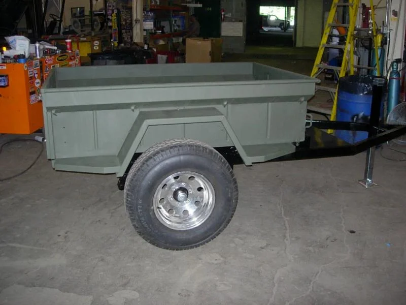

Here's a few more of it painted , for my use it pretty much done except the wiring, lights and bed liner. If I do decide to turn it into a camping trailer the guys at IPOR having given me a great base to start from.
Lou

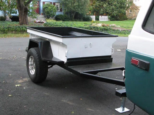

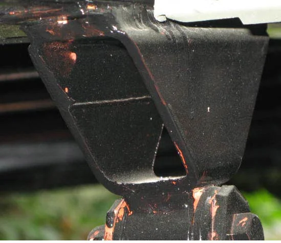

Trailer Update

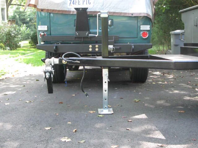

Looking at the picture of the jack stand, I think it needs to be moved back by the trailer bed because it would hit the truck or my bumper if I jacked the trailer..
Lou

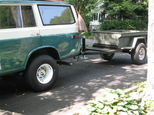

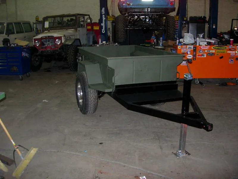

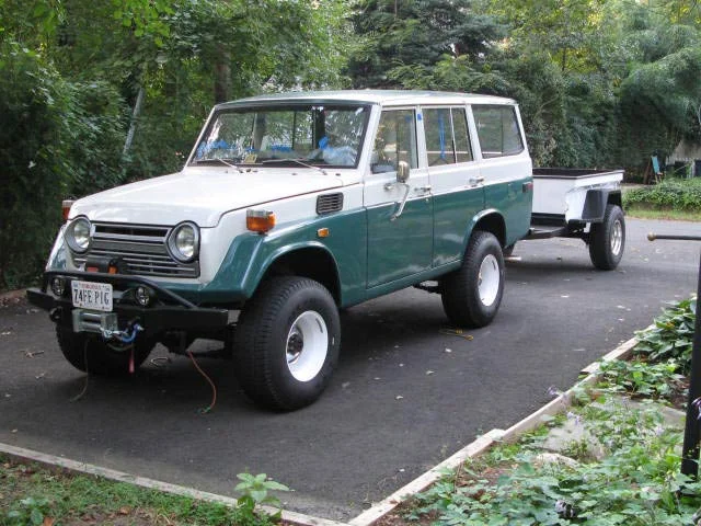

Got it home
Cam delivered the trailer day, pretty sweet. Ride height is level with the hitch, considering they didn't have my truck as a guide Cam did an assume job. To raise the trailer he ran the steel for the draw bars under the trailer frame and attached the front spring hanger and made an extended rear hanger.
I started painting it Hunter Green .
Lou

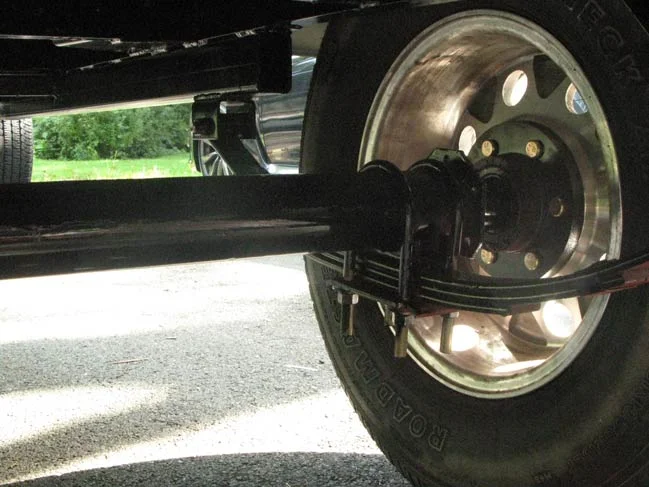

More
Will have to touch up the black oil based paint on the springs an axle.

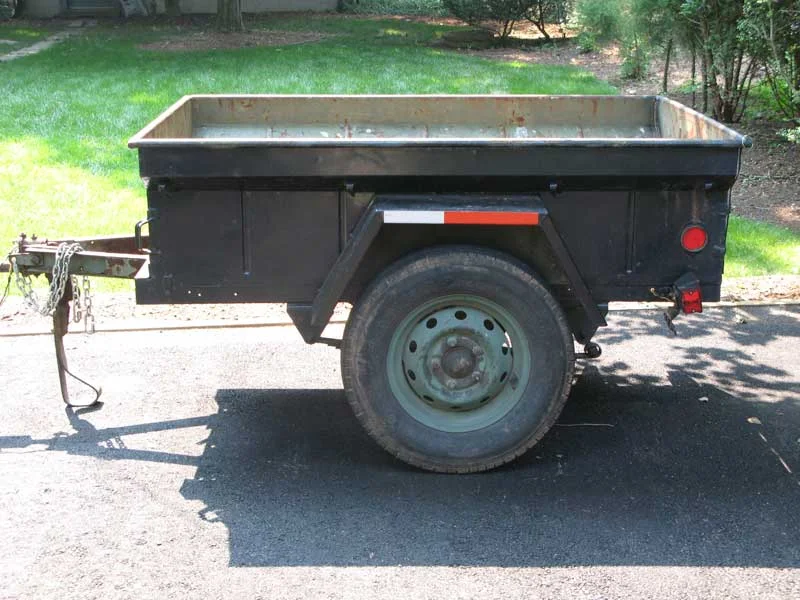

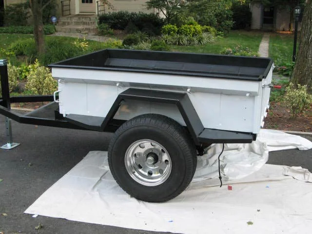

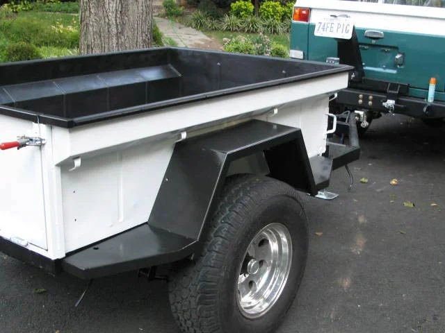

From this to this
Spent most of the day painting my trailer, painted the tub Rustoleum Gloss White High Performance and the fenders Rustoleum Black Hammered which does a great job of covering small blemishes. Need to bolt the fenders and the turn signals and take it for a tow.
Lou
