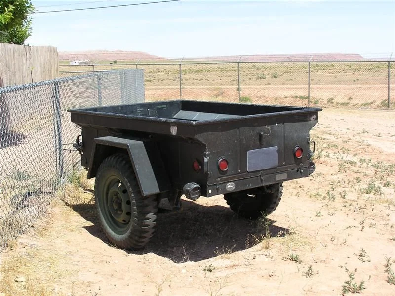

The inside of the M416 bed measures, 72L x 41w. But the stock M416 trailer does not have tail gate. So, you would have to modify the trailer to make your extension for the dirt bikes.
The first photo is of my M416 before I rebuild it.

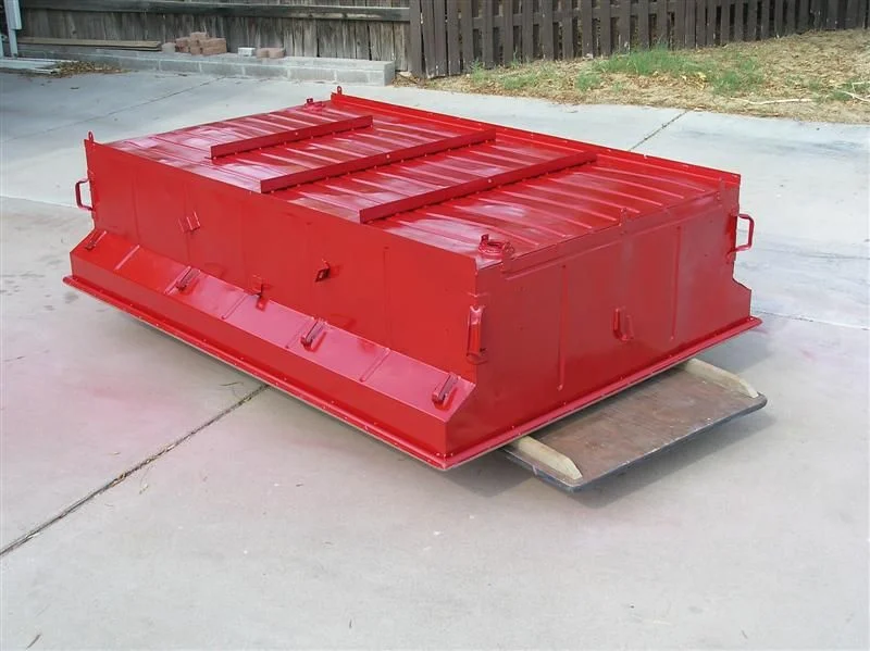

The second photo is the tub after I had painted it. The tub is upside down and that is the back end of the tub.
I chose not to add a tail gate to my trailer. I like the fact that it will float and keep the contents dry.
