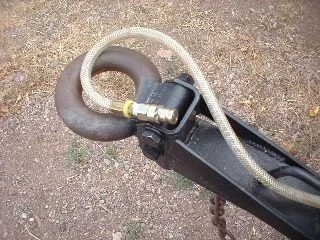

The stock mini-truck tank will work just fine. Get a regular 12v puel pump from the parts house and mount it next to the tank. I usually run mine disconnected from the Cruiser while driving so as to avoid any fuel spillage in the event of a accidental hitch failure. You can use a dry lock for the quick disconnect. On the tow vehicle (My FJ40) I have connected to the return fuel line at the tank. Fuel transfer is as easy as connecting the lines and letting the pump do its job. I also can use it to fill my ATVs and dirtbikes with fuel. My trailer has it's own battery so I don't even need to hook up the cruiser to use the aux fuel tank.

hammerhead any pics of your set up? it sounds like pretty much what im after. the plumbimg especially.

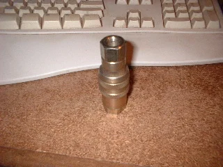

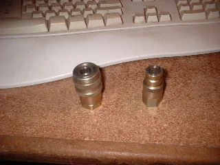

Here are a few pics of the dry-lock set-up. I picked it up at a hydraulics shop.

nice do you have any other pics im interested in your whole set up? did you do a write up?

ok heres some horible pics but i think u can kinda get the idea, basically i plan to get a contractor style camper shell with the actual door style rear door so it's easier to get into and out of
so i know the pic of the rear is kinda confusing but the plan is to have like a swing out style bumper but it will be doors 1 to open to either side and lockable in the open and closed positions (in the open position im gunna make a canvas auning to give a porch for if its raining) tire carrier on 1 side and water or jerry cans on the other the top will be taller than it needs to be to give a full lenght basket (im debating on this if i do it it will probly be removeable so i can take the shell off and haul something tall if needed) and the points above the basket will be to act as a lumber/ladder rack so i can tie off whatever i might need to put up there.
ill probly trim the lower parts of the pannels and make some kind of sliders cause my trailer should match the tow rig right.... any way well see how it actually come out but, what do you guys think other than that i need to get a real photochop program?
