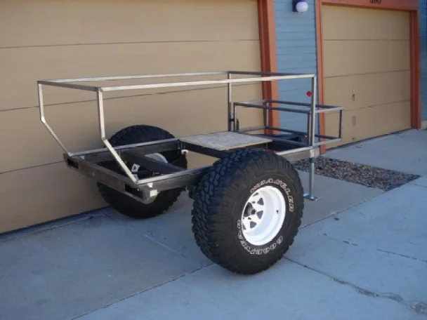

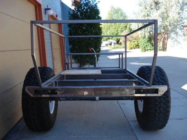

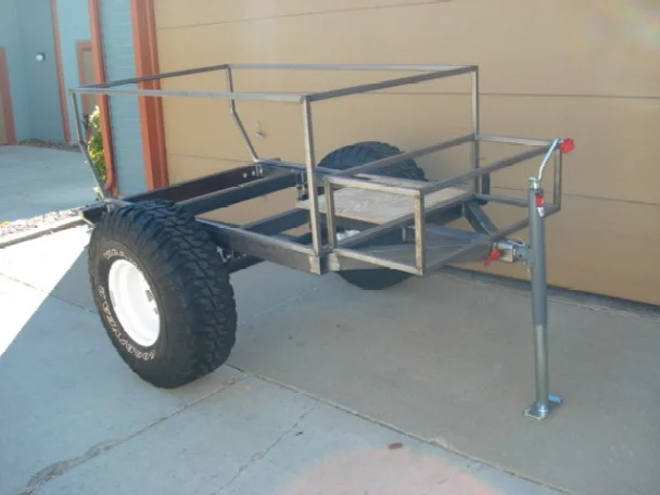

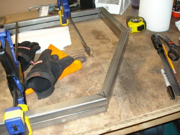

So here are a few pics from yesterdays work.
One of the most time consuming things is trying to fit all this tube together at weird angles and make it look right. Here you can see the joints I made to have proper overlap, I cut them by hand with a cut off wheel on my grinder. All in all they came out good, I would like to see the gaps tightened up a bit but for now I can live with it!

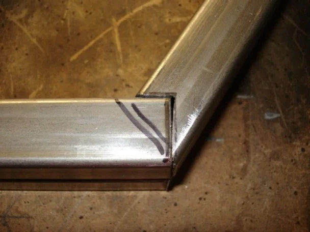

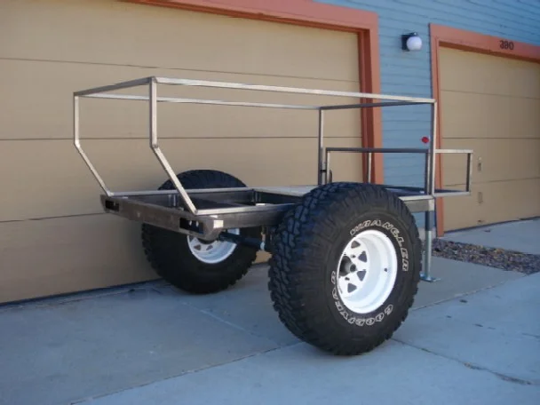

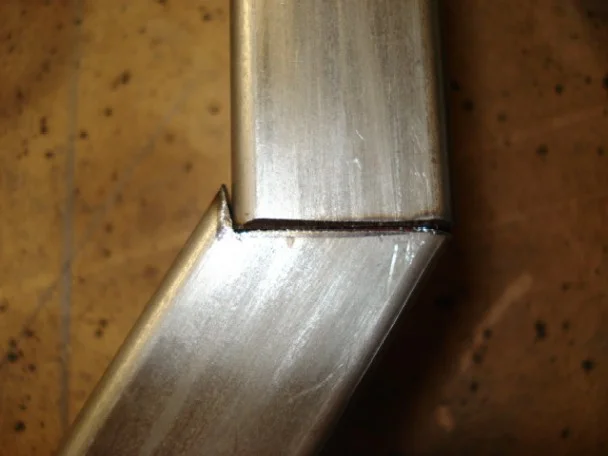

Alright! It finally looks like something more than a beefy small flatbed
This is real simple tube work, but to make it square was quite a challenge and time consuming. My wife has suggested making a long drawer down the side of the trailer, over the kitchen drawer that will come out of the rear. This would make two drawers on one half of the trailer, with the kitchen extending out the back and a 12" high 20+"deep drawer that slides out of the sides for the more common stuff. I would keep the other half of the trailer as one Monster drawer that could swallow coolers and larger items with ease. Whatta' think?
Starting to look cool, IMHO

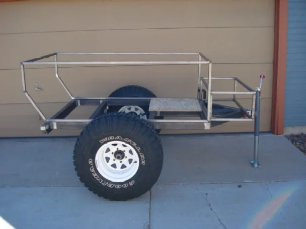

And just a few more for fun...

To clarify...

10 stainless steel 3/8" bolts is going to be plenty strong. Should look nice too.
1972 FJ55 "Geirdriful" named after one of the Valkyries
Check out my build thread:
http://forum.ih8mud.com/showthread.php?t=165633
Some more good pics of the Pig here too:
http://forum.ih8mud.com/fj55-iron-pi...-iron-pig.html
Maid Marion, "Why, you speak treason!"
Robin Hood, "Fluently."
nat is offline   Reply With Quote
Old 10-13-07, 08:36 PM   #202
IH8MUD Junior
gavman's Avatar
Join Date: Jan 2007
Location: Vancouver Canada
Posts: 125
I say grade eight, No need for the stainless as everything else will corrode as quick or quicker than the bolts.
Unless of course you are gonna leave them exposed?
gavman is offline   Reply With Quote
Old 10-13-07, 08:48 PM   #203
IH8MUD Lifer
REZARF's Avatar
Join Date: Sep 2003
Location: Louisville, CO
TLCA# 13041
Posts: 2,806
Yup, they will be exposed to the weather.
Drew F.
Rising Sun 4x4 Club
76 FJ40, 85 fj60 Engine and Ignition, 35" MTR's, Warn 8074, 4" of lift TPI, snorkeled, racked, Mini-truck P/S... and sometimes running.
Friends don't let friends drive Thornbirds...
My camping trailer build up thread.
REZARF is offline   Reply With Quote
Old 10-13-07, 09:21 PM   #204
IH8MUD Lifer
RHINO's Avatar
Join Date: Dec 2003
Location: valley of the sunstroke, AZ
Posts: 2,790
i dont know much about the hardness of stainless, but i'd definatly go stainless or at least zink plated since it'll be exposed.
the way the back angles out it looks like the axle could come back some for the 60/40 split. but it sure is comming along nicely, keep up the great work man !!
75 BDJ55 soy cruiser
01 TACO got salsa ?
RHINO is offline   Reply With Quote
Old 10-13-07, 09:27 PM   #205
IH8MUD Lifer
REZARF's Avatar
Join Date: Sep 2003
TLCA# 13041
Posts: 2,806
I think it is the pic that makes it look too forward, the axle is set pretty far back, plus the wieght of the front box ought to balance it out.
Rezarf <><
Drew F.
Rising Sun 4x4 Club
Old 10-14-07, 08:03 AM   #206
IH8MUD Lifer
RHINO's Avatar
Join Date: Dec 2003
Posts: 2,790
true,, pics always throw stuff off.
