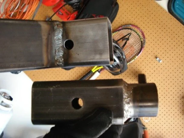

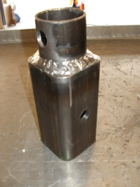

I am going to make a short, 6in or so, sleeve that will fit inside the main draw-bar location and be able to be pinned with a hitch pin, but it will also have a round mount welded to the front edge of the sleeve. Then I can remove the sliding draw-bar and stuff the sleeve in and prop the trailer up with it, essentially shortening the trailer by nearly 3 feet for storage... we'll see!
Here is the little item I fabbed up...

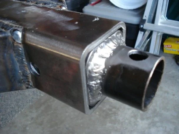

Worked like a charm! I made the sleeve out of the draw arm material (2.5x2.5x.25"). I inserted the tube about 2" into the sleeve, then I put a bead on the inside and layed it up thick on the outside to fill all the holes in.
I think it came out nice and it works great! As a side benifit, with a reciever lock, I have now essentially created my first anti theft device for this thing!
