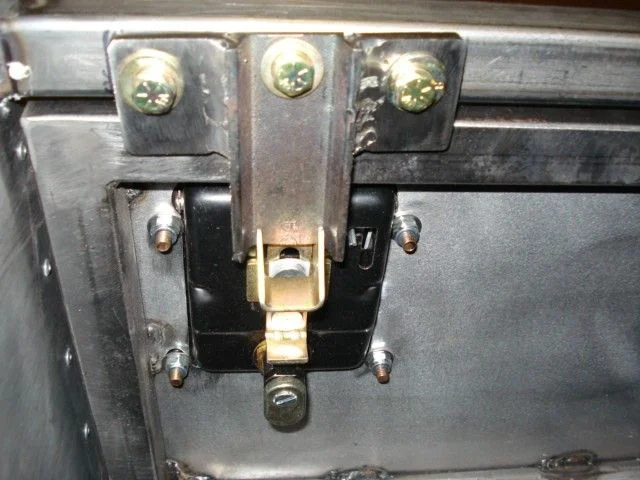

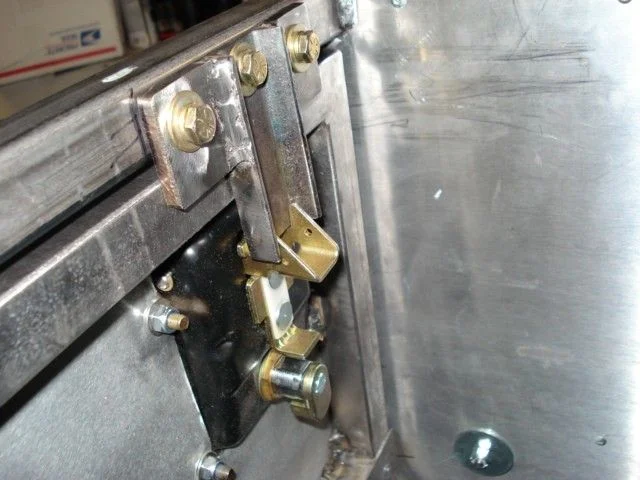

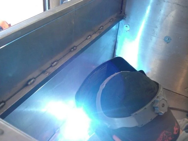

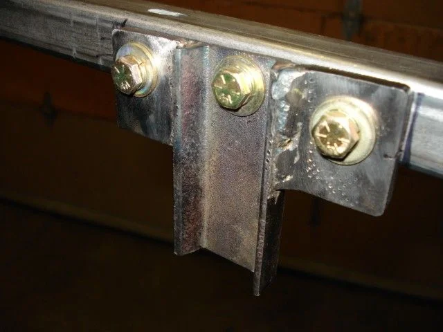

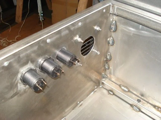

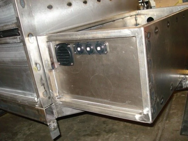

Well, I got a lot of work done this weekend, not too much to show for it though. I finished the welding of the floor, front of the tub, axle spring perches, spring mounts, and hangers... etc.
All the structural welding is complete!
Axle Ike built me a sweet batter tie down system for me on Saturday, thanks again Isaac! It came out awesome!
FWIW, I started drilling holes in the sheet metal for all the accessories that will be attached to this bugger. I got as far as both vents, and three 12v waterproof outlets on the front box. Tomorrow night I will mount the shower, rack system, and water fill holes, as well as the power inlet for the battery charger... I hope
Once my last box shows up from McMaster this week, I will hinge and install the gas struts onto the lid.
Getting closer, I bought about 20bucks in stainless hardware today to mount everything up with. Man, hardware is expensive.
Here are a few shots from the weekend again, not too much to show for a 13 hour day of work.
Rezarf <><

So you bought two SS bolts with washers and nuts?! Everything metal has gotten alot more expensive. And the darn hardware comes from China too...can't seem to avoid it even if you want to .
Are you planning to install 12V outlets elsewhere on the trailer besides the nose box? I have them on the back above the door...they come in handy when your light/appliance doesn't have a really long cord.[/quote]
Thanks and yes, steel is crazy right now, actually I got about 120 peices total. All stainless, washers, nylocks a few other things like grade 5 nylocks and stuff too.
I am going to install 2 more outlets on my kitchen counter later on, but these are already over kill for what I need. I want a few out back for exactly what you described.

Well, time is running short so, you are going to get shorter write ups as we close in on our date...
Here is what I came up with for catches for the tailgate latches. These are really simple but allow me to adjust the catch in all the directions I could need them to adjust. Pretty simple. I used the nut-serts to bolt to in the frame. Seems super strong and they close oh so nice!
