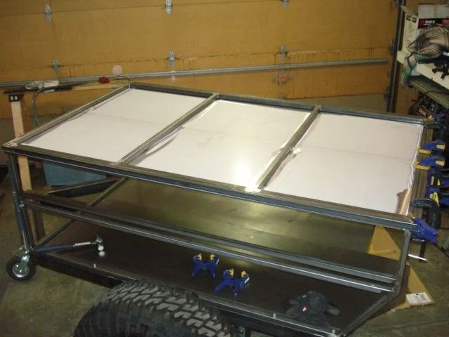

Posts: 2,857

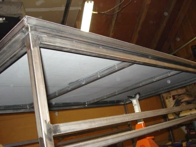

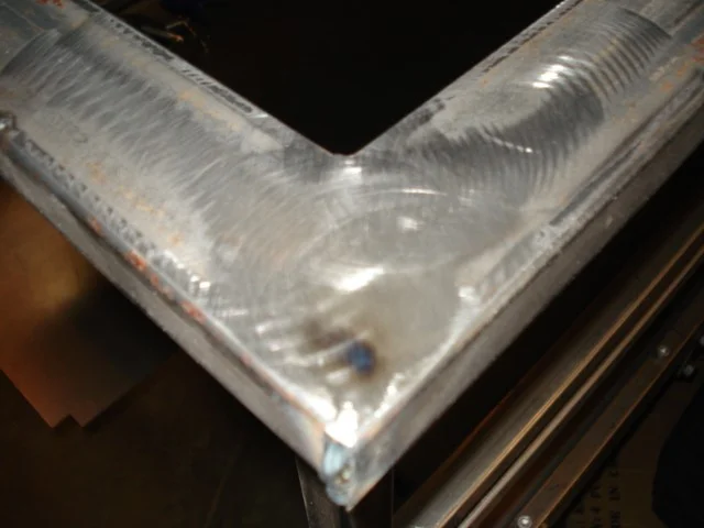

Well, I got the lid roughed out tonight.
Last night I knocked out the welds on the lid frame, it was an easy job but it takes time to make it look right and be strong and be square.
I am using a De Walt flap disk and must say it is lasting and lasting... well worth the extra coin IMHO.
Then I had to grind off the galvanized coating on my lid sheet metal. No biggie, I busted out the Rapid Strip tool from northern and it made quick work of it. FWIW, I laid the tube frame over the sheet and traced the outline of the tubing onto the sheet so I knew what to remove.
Then I had to square the tubing up to the sheet. No biggie but this is how it went down...

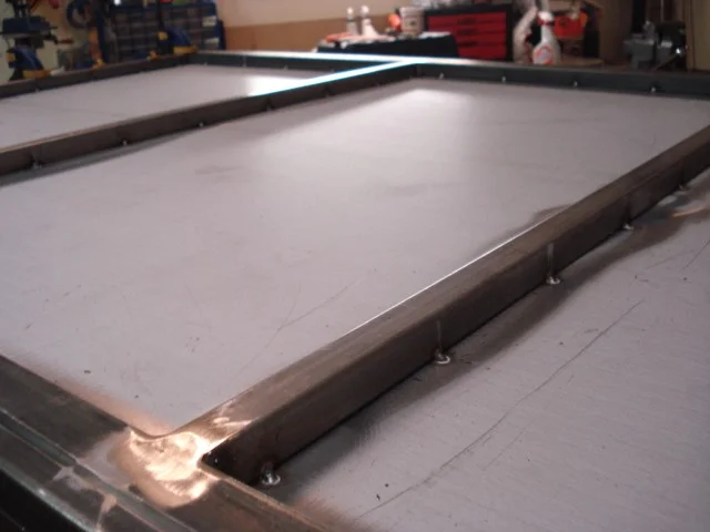

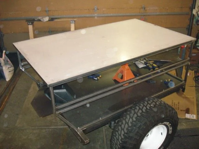

Then I measured off my weld marks so they would be nice and even when I am done. After all that was done and I rechecked it about a zillion times I clamped down the back end and worked my way forwards. I used a clamp about every 4-6 inches and worked from the center out, then started to move in about 2ft sections forward, alternating sides as not to warp the sheet metal. I made heavy tack-welds to make sure it stayed put.
After it was all tacked up, it was time to flip it over and see how it would actually look. I am getting stoked as I see the body come together and, my sides are going to be picked up tomorrow!

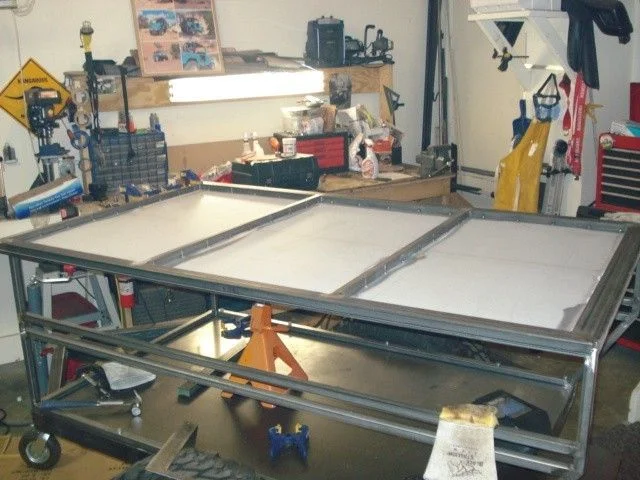

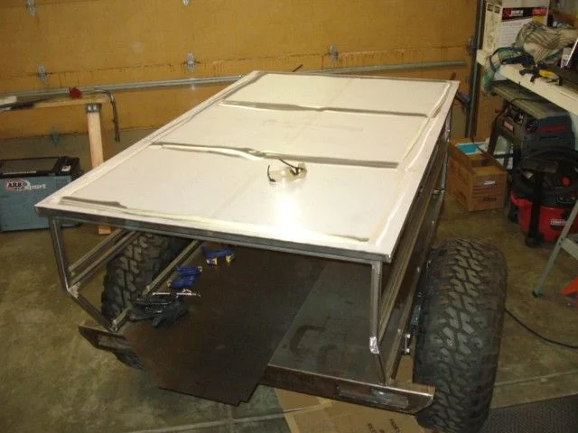

One more for the peanut gallery... you know who you are!
It is amazing how quick the sheet adds weight, I now know why guys tube their cruisers out!
I am going to start the stitch welds tomorrow if I have time between work and heading to our Rising Sun meeting. More as I get it done...

Originally Posted by slimbuddha View Post
I've been watching this thread for quite a while, and I am mighty impressed. In the next couple years I hope to follow in your fine footsteps. I would recommend one thing to make this really legendary. Reading through the forum is fine, but to really see the build up, I nominate a page dedicated to the build process, with some commentary and the such specific to the major steps.
Thanks man, I have thought about it, but don't have the skills. If I have a helper, I would be all over it!

Originally Posted by Brian in Oregon View Post
Nice job!
Keep this up and we'll soon have a new discussion board - Hard Core Trailer Tech!
HA HA! That is funny. We'll see how "hardcore" it is when I get it on the trail... or at least the road for that matter.
