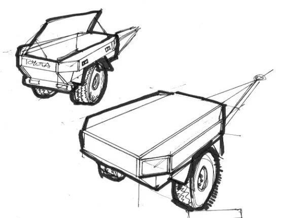

I let this idea die until I realized that I can now bend square tubing. I might re-think my side box idea. It is a great idea that I got from AT's Horizon trailer... which is 'da BOMB!
My main hesitation was the idea of attaching sheet to round steel, but now the square tubing gives me easy mounting of the sheet. Whatcha' think?
Here is a rough sketch...

Looks good, but I think angling the "panier" boxes is more work than it's worth. I'd go for rectangular, like on the Horizon.
More work, yes, but it fits with the overall design scheme he has working
Ed
__________________
There is nothing so depraved as a man in the depths of an ether binge
'66FJ40, Fresh 2F, H42/Orion(By Poser...LCR4WD), ARB Front/rear(By Poser...LCR4WD), MetalTech Cage installed by Poser, Screw-ups fixed(by Poser) 4WDB Corvette Master, Mini Truck PS, 3.5" Lift, Warn 8274, 33s on stockers

Agreed, if I didn't care how the overall thing looked, i would be a blessed man... with a HUGE box on a bomb proof frame and would have been done about 2 months ago.
...8 bends a few stringers and the boxes are done... yeah right!

Go for your design. That's what makes it unique and attractive. Take the high road!

X2, and the angle on the box should help it navigate those trees that jump out on the trail. More likely to push itself around it that get hung up!

Drew: Do the sideboxes! And I like, your angled approach (no pun intended...well actually pun intended ) from a cosmetic perspective even though you loose function on the interior with the mitered corners...what would it look like if you left the front side as mitered but made the rear/trailing side of the box 90 degrees to gain a little more use of the space?
FYI: I REALLY like the stove set-up mounted on my AT Horizon side box..try to incorporate it if you can. Didn't think it mattered that much in the beginning...but it is a great convenience all the time!
You probably already are planning to do this but be sure to thickly (1/4") Rhino/Line-X/whatever all the front sides of your trailer, frame, box, etc. My AT has just gotten beat to snot from gravel/sand/rock spray!!!
One last FYI: Be sure to consider your RTT height if you do add sideboxes...you may need additional height for your RTT mounts...if you go with a side hinged top as your latest pic depicts (a side opening top will be more useful to you than a rear/front hinged top).

My vote is angled front and keep the rear ends square.
If you have to pull it through the trees and scratch it up a bit, then well good it will mean you're using it and getting outdoors.
Thats what this is all about isn't it
FYI i think you are carrying a lot of people through the winter with this build, which is great. (Maybe a little funny too but who cares)

Go angled both ends. That would look KILLER.
Have you considered using the cornered ends for "tuck away" stuff. As in, box off the inside of the cornered area, put a small hatch on the angled end, and put the water pump/fuse box/whatever/ there. It would seriously free up space in your front box, and be SUPER easy access.

The top will still open at the rear and hinge on the front. This allows me to access the things I need from either side and it eliminates the heavy flexing forces on either side of the trailer, I can brace up the front with little effort to make it rigid.
I will be making a drawer for a kitchen that slides out the back see page one of my sketches. My wife likes that hieght better than where it would need to be on a side box... and that works for me
The line-x or similar sounds like a great idea, I will have to see where the budget is at that point. But I have heard this from a lot of folks. Seems like a near necessity. thanks!

Henry, I have a placed all worked out for the rubber style chocks... stay tuned!
Isaac, we definatly think alike! Thanks, I like the side boxes, I am going to use them for more things that won't be accessed as much like the electrical components, charger, junction box, water valves, pump, fuses block, spare fluids, recovery for the trialer, one will house the shower... things like that.
