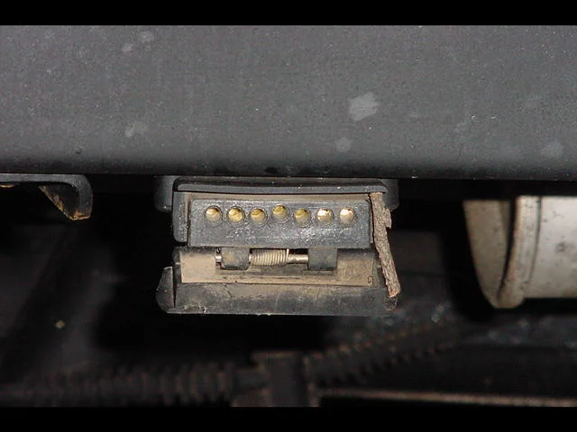

I haven't had much time to look into it except to stop by an auto parts store. They have nothing even close.It's an Ausi part.If I had the plug I could make an adaptor. It is a 7 pin plug but they are not in a circle they go straight across with the middle pin slightly higher than the others. I'll take a pic.

Here are some pic's of the connector.
That's a stick holding the cover open. Name:  MVC-005S.JPG

I lied, never seen a seven pin like that before. You might be better off cutting that one off and rewiring it to a standard "US" 7-pin. They sell 7-pin plugs that have the 7-pin and 4-flat together in the same unit. Available at Tractor Supply and other stores that sell trailer wiring stuff.

HAD one of those 7 pin flat----not anymore----it's not worth the trouble.
Rewire for a common round plug and use an adapter for anything flat.

The flat plug is one of the standard types here in the land of Oz. We also have two versions of a round connector. All connectors can be either 5 or 7 pin.
Personally I'd never use anything other than the flat 7 pin, I've had no end of trouble with round connectors, never had a problem with the flat one.
