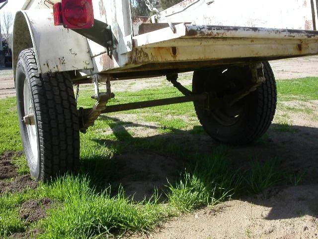

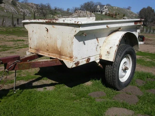

I oppoligize if this is in the wrong section.
What is this trailer? I helped a neighbor clean up his property and found this. He gave it to me for helping him out.
I replaced the original rusted out metal bed with aluminum diamond tread.
The hitch was a kickstand style that was totally junk. I replaced it with a removable receiver style.
I boxed the frame rails in.

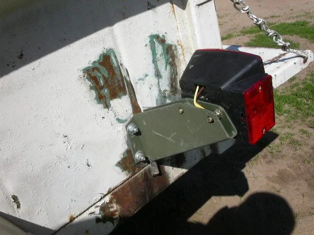

I replaced the broken little round lights in the rear with some army surplus mounts and some common trailer lights.
It never had a hand brake on it and it does not have brakes behind the wheels.
You can see it has green paint under the white krylon.
Any Ideas?

Old-school Bantam T3 4901/T3-C?
Nice score!

The frame does not look to be original, and even if it is, someone has welded a bunch of metal to it, so any collector value that it may have had is only in the box, and that would need to be really clean.
I say play with it, paint it light blue and have fun.

I think the axle/wheelarches are not original.
For me the parts are coming form different trailers;

Just going by the 'lipped' fenders, it could possibly be a Spen trailer w/ some mods
Try looking up Bill Oakes over on G503. He has one and seems to be the most informed person on Spens.

I think Walldog hit the nail on the head.
http://www.film.queensu.ca/CJ3B/Phot...railerPage.gif

That is exactly it!
I took the cheesy little kickstand on the tonge off. I still have it if anybody needs to rebild thier SPEN. Postage and it's yours. The guys who posted to this thread have first crack at it.

My suggestion is to reconsider your mounting of the light brackets.
These lights are quite vulnerable to trail and other damage. I've busted my plastic housings a couple of times now. Your brackets are bolted to the thin sheet metal. That invites bending the tub or tearing the bolts out. On the military trailers the light brackets are bolted to the heavier frame.
