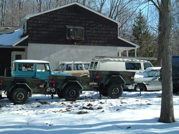

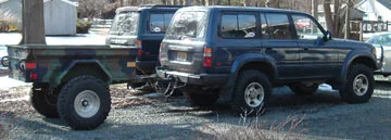

Mike heres a couple of pixs I have of the M101 with my 80 that has 315s and J's

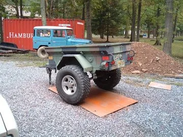

Tongue with LocknRoll
SOA M101 and 80
I am removing a pintle from a second M101 - PM me we can work out the details
