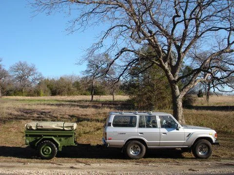

Yes, Brett's setup trailer is one of a kind, he need to bring his six ton jackup to hold his trailer leg everywhere to go!

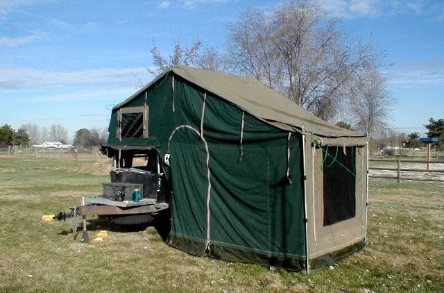

These trailers are great! These pictures have given be some ideas for my own setup. I hope you’re willing to help out a poor cousin. I realize that I’m starting out on a bad footing, but I own a Sankey, and I want to build a “camper” that I can tow behind a series Rover with a whopping 67HP engine. My goal is to do the Trans-Taiga Road this summer. I’ll need to carry lots of supplies and repair parts, and I really-really don’t want to sleep on the ground on a long trip like this.
I’m hoping to get some advice like;
Is there an advantage to hinging the lid on the front instead of the side?
How do you vent the trailer? If you have to put your gear away wet, how do you dry things out on a trip?
If you put a roll cage with the tent on top, does it mess with the center of gravity? Can you take the trailer off road with the tent mounted up there?
Thanks in advance

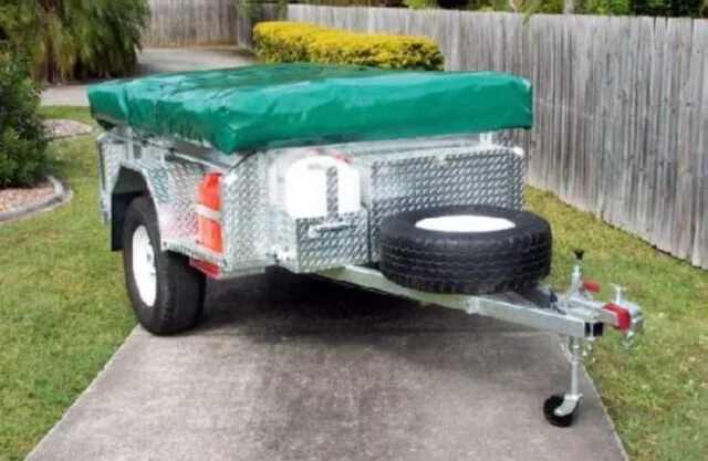

Ive just got this one and took it to the beach over christmas
Should have bougt one years ago.
Comfortable, Dry, Easy and built like a outback dunny (I am in love)

Who made your trailer? Flushed gas can holders, that's cool.
Cheers,

Quote:
Originally Posted by Snook View Post
Toy60,
Cheers,
http://www.ozzieoffroad.com.au/
Great bang for buck but I think the freight costs will kill you

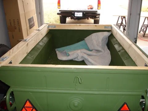

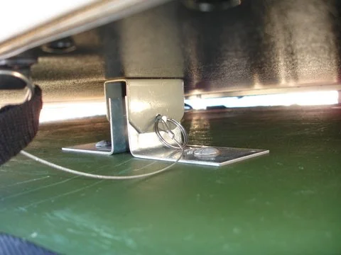

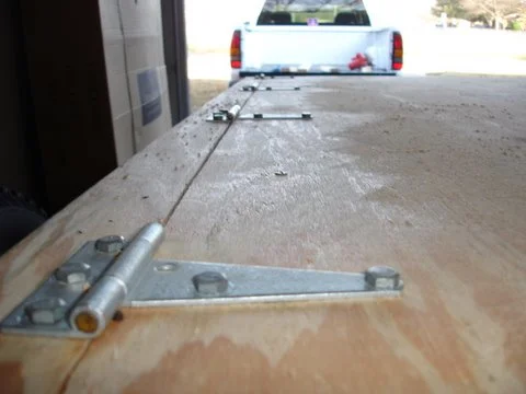

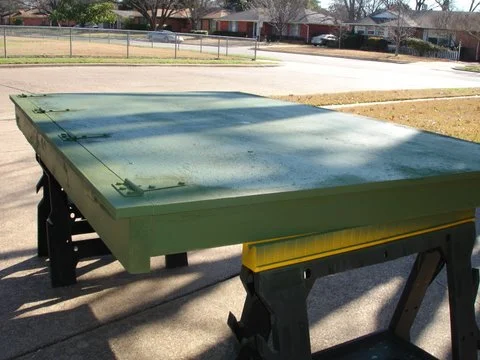

I'd like to revive this thread, as this is where it all started for several of us on the Trailer Tech forum. Any new ideas for your tent setups? I am working to get mine completed in the next 7-10 days. Here is the rough draft of where I am so far...
I have finished with the hinges and the deck, and I need to finish sealing and painting the deck prior to installing the lock hardware and tent (although I temporarily put it on for the attached pics). I am really looking forward to my first outing with this thing.
ever shoot any pics of the wood sealed? also how did you mount the wood top to the trailer?

I don't think I have any pics of the wood sealed prior to painting. Here are a few shots of how the rest of it worked. I ran galvanized screws deep into the 2x6s for hinge support. The lid is solid as a rock now. I also reinforced it underneath with steel studs, galvanized carriage bolts which also double as a supprt for the brackets that hold the tent.

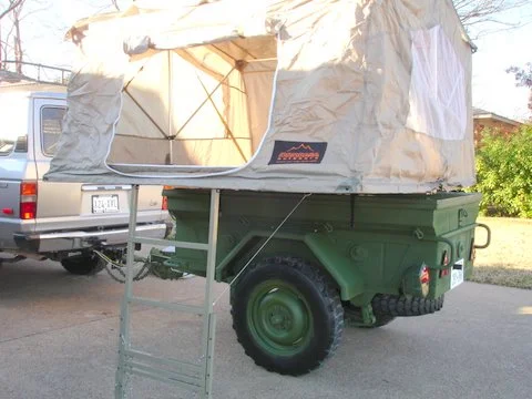

Here are a couple more.

thanks those pics help alot. so did you drill holes in the side of the tub or did you use the existing holes from the hooks?

Actually, neither. I wanted to avoid drilling holes to keep it somewhat original, and I also wanted this lid to be removable so that I can use the trailer itself when I need it. The weight of the lid keeps it safely in the trailer, although I am in the process of securing it to the loops on the inside of the tub with some stainless wire for extra safety.

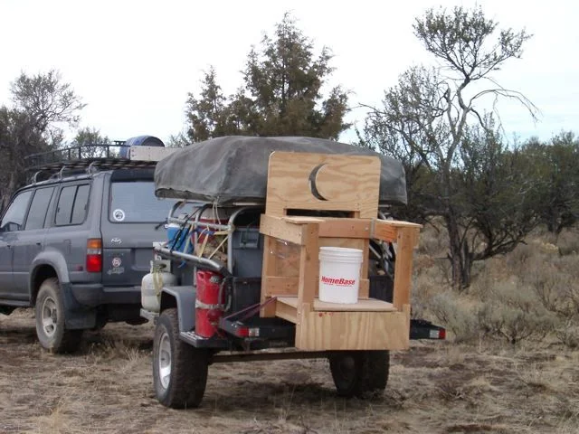

Here's my Buswakka, complete with "facilities"...

Saweet throne action! Don't see that every day!
Cheers!

It's very handy when you're camping with a larger group in one spot for several days...

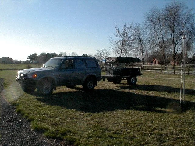

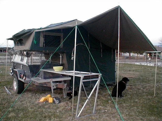

Here are some more of the trailer with the 'new' wheels and tires, and the tent set up.
Dan
