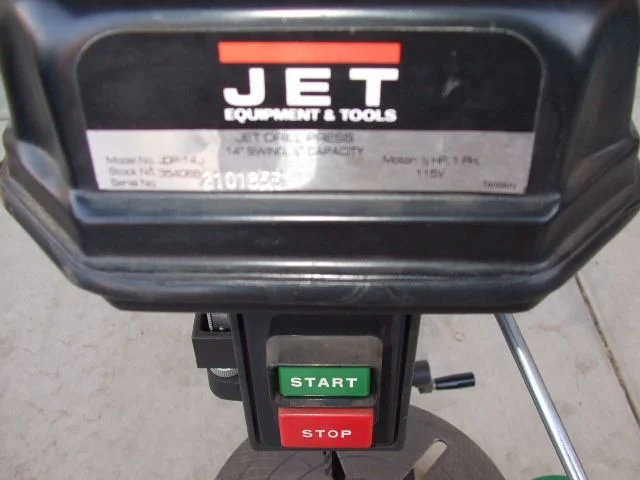

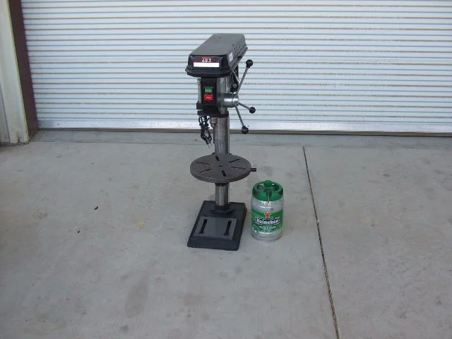

I have a new Old Jet bench top model.
It was $300 when new about 3 years ago.
I agree with Dirtsquirt on the speed. The slowest it goes is 400PRM.
It is great for small holes but when you get above 3/8" in thick metal the speed is too fast. Forget about using a hole saw for coping for an extended period of time or in thick tube.
The bigger the hole the slower the RPM. (You already knew that)

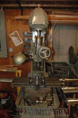

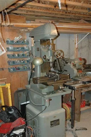

you should be able to buy an old US made drill press for a few hundred dollars. i got an atlas for around $150. just make sure to check for runout.
even better would be to find a small mill. mine is a 1940's vintage vernon mill that i got at a moving sale for $400. makes an awesome drill press.
