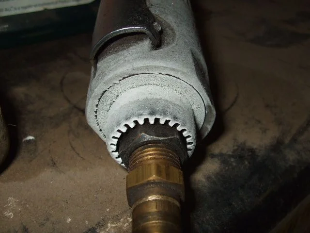

Your Ryobi should have a warranty. Take it back.
Phnuematics are loud and they freeze up when the temperature is cool. They don't lock up, they just too cold to hang onto. The temp was 42 degrees when this happened.

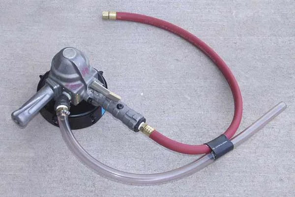

If quality class is the same a pneumatic is more compact, delivers more even speed over the torque range, will run much longer between tune-up/repair, etc. The required maintenance is oiling and if gear driven grease.
Electrics are less expensive, especially in the "4 inch size class" they are pretty much disposable priced. For a home or small shop use they are probably the best option. They also require maintenance, the biggest is blowing debris out after each use, the gears require grease.
Electrics get hot with extended use, pneumatics get cooler. Excessive cooling/freezing up is from moisture in the air, dry air has little cooling effect, moist much more. Pick your poison, here most prefer something in the work area being cool.
My customers that still use electrics have all moved to the DeWalt DW402 or DW802 for the best cost/power/reliability/parts availability ratio. I can't think of anything that I would buy from the "new Milwaukee" the walmartization of that company hasn't gone well.
For hand held material removal it's hard to beat one of these, a bunch of my customers have spent a small fortune trying, but most small shops don't have an extra 60+ cfm to run it!
