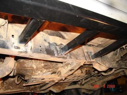

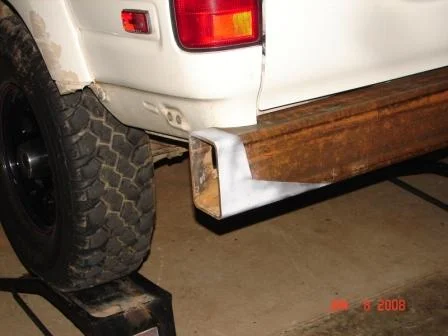

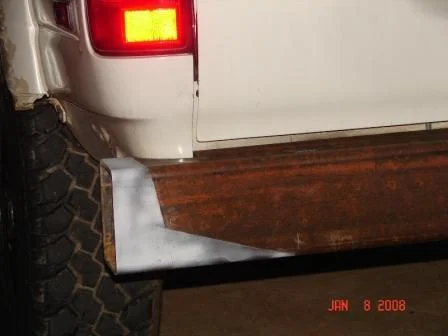

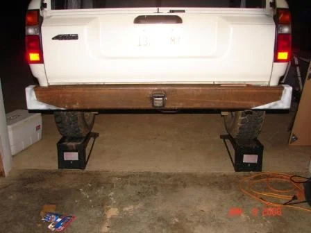

Finally getting somewhere on my bumper and sliders...here are a few pics.
Still have mods to make to the bumper to tie into the quarterpanel wings (white area will be cut out) and need to complete and attach the DS slider...but im getting there.

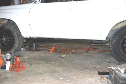

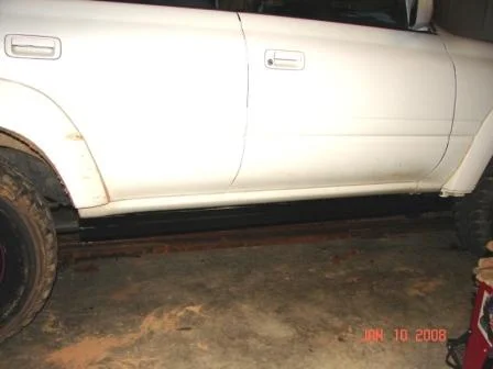

Slider

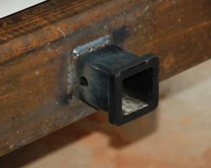

Receiver

Looking Nice! What size materials are ya using?

Thanks...its been a learning experience.
Bumper is 3/16" 4"x6", the slider is 3/16" 2"x3" and the slider arms are 2" 3x16.
The wings will be 3/16" plate steel.

Cool....that seems to be the route I wanna take. 3/16 with 2x2 outriggers.....I was thinking 2x4 for the slider......since ya got yours burned in......what are your thoughts on 2x4 vs 2x3? I would like to have a little bit sticking out to use as a step. Which of course could be handled by cutting longer outriggers. I know it's only 1" diff, but.... Just wanted to get your opinion.

I started with 2x4, but that chit is HEAVY (estimated, without outriggers, a 6' section of that weighed in around 60-75 lbs)....I was afraid gravity might wreak havoc on them over time and start to bend down. My whole slider now might weigh 55-60 lbs. IMO, the 2x3 is considerably lighter, still wide enough to support the weight of these beasts and my final product will have tubing for rubbing / steps...
If you went with a thinner ga tube, then 2x4 might be fine...but I only had 3/16 to work with for the price it was being offered (FREE), so I had to compensate accordingly.

looks good Steve! nice welds! does Todd know you have access to a welder? he was looking for one the other day.

those are nice welds!...Steve, Like Sean said above, I'd need access to a welder to weld up the sheet metal (.023 wire) on my half doors. Technically I'd like to get these done for the MLK run, but time is getting short and I'm gonna be out of town this w/e. Let me know if you might could help a brother out next week. If we can't get it done next week, maybe we could work it out in the next few weeks...beer's on me

Thanks guys...Im finding welding pretty easy...especially since I was laying on my back welding above my head. Got a nice big amber that popped off and landed on my coat just over my biceps, burned thru the coat, my shirt and my arm. Got a nice pencil eraser size 2nd degree burn on my arm now.
Todd, Im hoping to find some time this week to get the other slider completed before MLK...so your welcome to come out and work on your doors.
Just give me a call at 423-421-8168

Well, thanks to Brandon and his kick a$$ welder, I got my DS slider done Monday night. Sanded, primed and painted it last night...its hanging in my garage curing. Hopefully will have some time tonight to get it welded on.
Todd also came over Monday night and used my mini welder (75 amp) to work on his doors. My welder needs half marks between settings. 2 didnt penetrate and 3 burned thru...so it looked like a bunch of little boogers all the the length of the weld, but it is attached. He took pics...
With a little (ok, a lot of) grinding and a little bondo, it will look professionally done when he is finished.

DS Slider is done...pics attached...

Quote:
Followed by proof testing this weekend at Royal Blue?

Quote:
Thats the plan!
Im only gonna be there on Saturday, so Im going to have to get an accelerated testing schedule in place!
