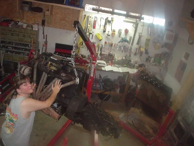

So I cleaned all the oil off and found a rebuilt 2F from a friend for about $700 and jumped on it.
After some work I got the F out with a little help

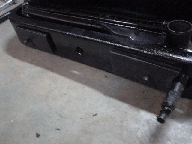

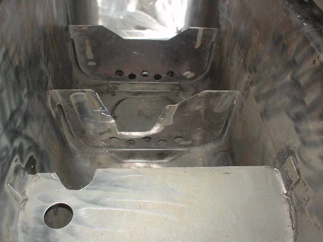

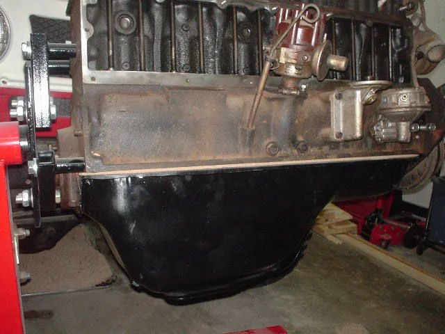

I modified an F oil pan to replace the one the 2F had been resting on for over a year:
Name:  Oil Pan 009.jpg

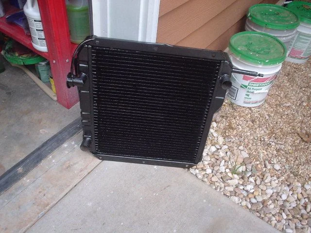

and I got my radiator cleaned and repaired as needed for $35 here in Rome.

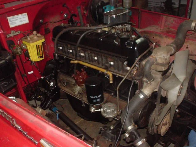

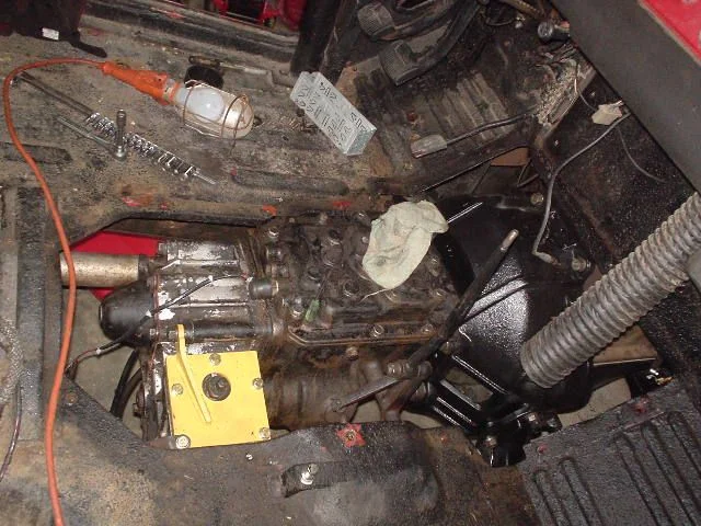

And right now the "new" motor is in and the tranny/Xfer case are attached.
Here is a pick of the moor after I had put on my new improved oil pan:
Followed Poser's instructiond for puting on the side gaskeet and oil pan gasket in the 40 section and it worked great...well I will know for sure once I try to start it!
(I am BTW looking for a different dizzy - something not retarded you might say)
I am looking forward to getting some parts back from Sean (including my radiator splash guard and heater) so I can get that stuff back in and have a chance at getting this thing running. I owe a pick of the engine in.
I will keep you all posted.

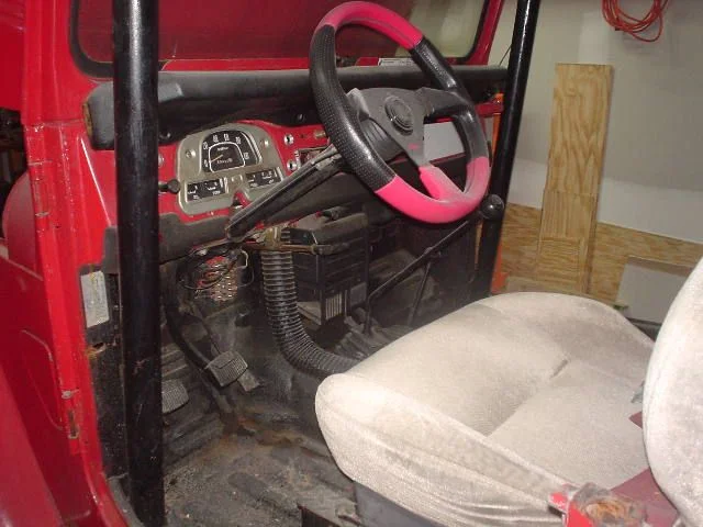

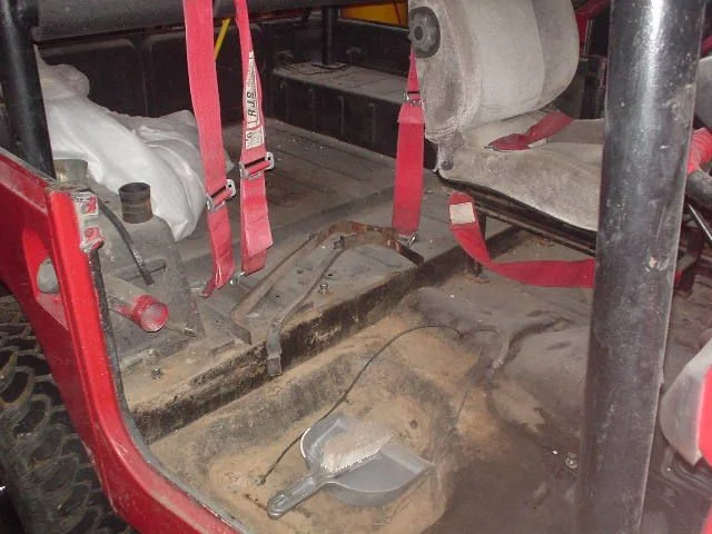

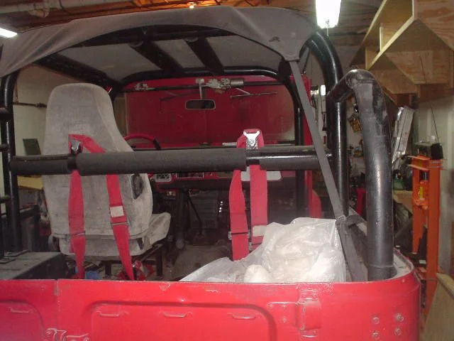

Here are a couple random interior pics:
Not sure what those seats are out of and not sure I like the mounts either. PO welded them out of square tube and diamond plate. I got some free stock '78 seats on the board and they are stored in VA at the folks house right now. Not sure If I am going to save those for 40 or not.
BTW found a sandblaster in Dalton Yesterday that blasts for $110 an hour and can do a frame in about an hour and a half and his turn around is two days.

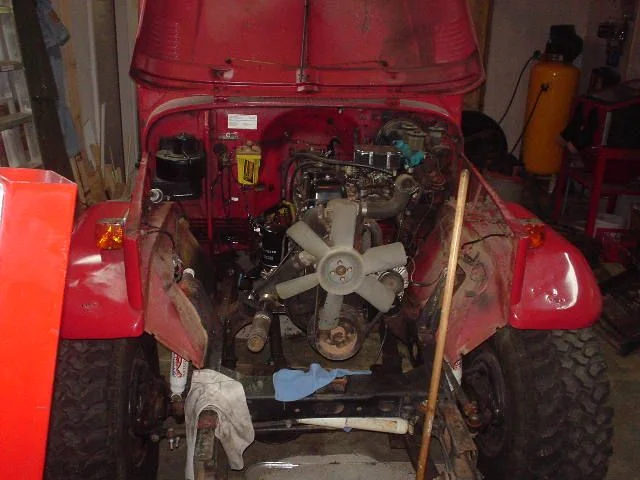

So, as promised, pics of the "new" 2F installed and a semi-clean XMSN and XFER case.
Note Poser's XFER case saver. All the cool kids have 'em

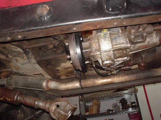

...and one more from the bottom. Now just gotta stake the nut and torque the drive shafts.

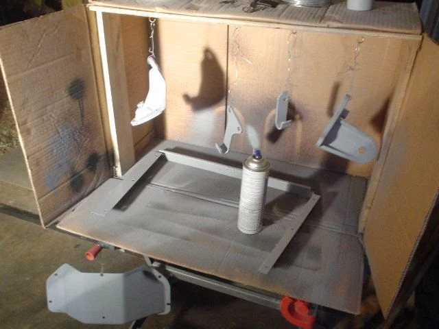

i think i'm most impressed by this make-shift spray booth.
This FJ40 shit is truly a thinkin man's game!!

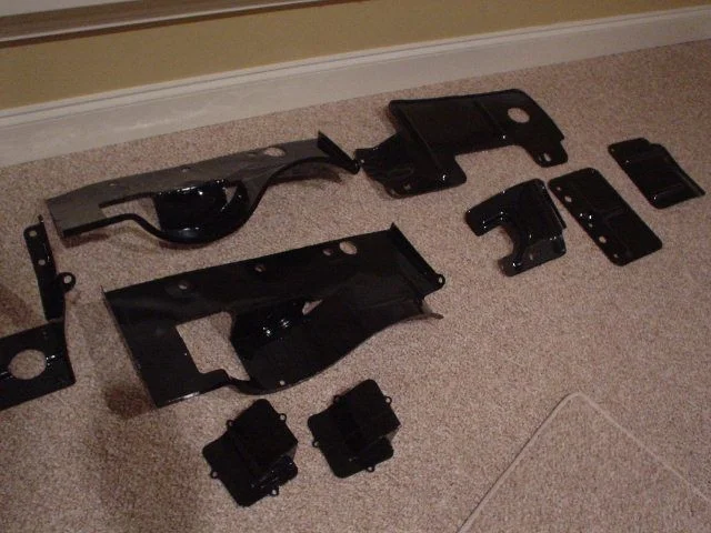

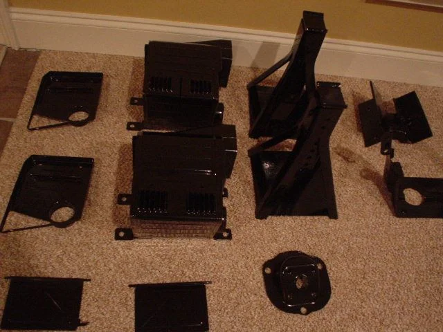

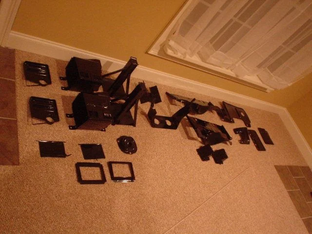

I was able to slide by Sean's place and pick up the powder coating he got done for me at what I would consider to be a very reasonible price (since most places would have charged me for each peice what I ended up paying for the whole kit-and-kaboodle!)
Let the drooling begin:

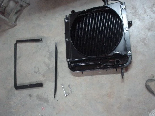

The other thing I did was get the radiator back in place.
I bolted it all back together with new hardware on the floor:

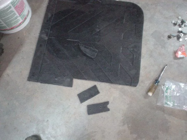

If you notice, the shroud is upside down and I had to take it apart and turn it over. LOL!
Then I cut some chunks out of a $5 18 wheeler mud flap for some cushioning. When I took the thing apart the PO used pieces of an old tire!

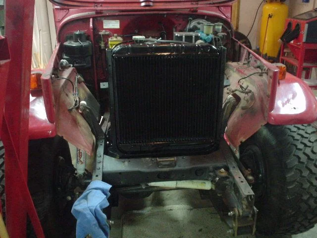

So here it is back on the truck. I was unable to get it all together becasue I discovered I did not have any 5mm washers or split washers.

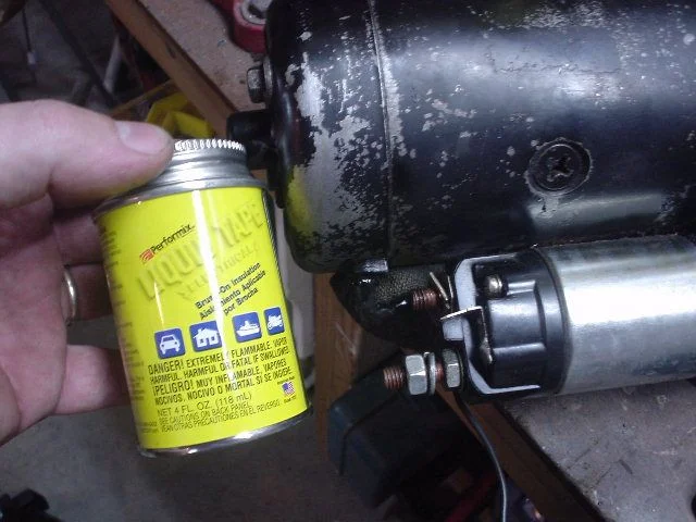

The other thing I did was hang the starter back in. Now, I discovered that the large wire going from the starter to the solenoid was no longer insulated due to oil and heat and I stripped off what was left, cleaned it with brake cleaner and the painted it with liquid electrical tape:
It was a good solution I think.
So a trip to Ace Hardware for some more metric hardware for a bolt for the starter (12mmx1.75x25 with a flat and split washer and a 17mm head according to the nut and bolt thread) as well as those 5mm washers to complete the install of the radiator as well as bolts for my clutch cylinder will get me going good.
I also need to stake the emergency brake nut and install the drive shafts and torque them. (It was on my list for the weekend but I did not get to it.)
I am planning on removing and lubing all my heater/fresh air stuff prior to reinstalling the heater box so I will be unable to start the truck 'til then. I am also waiting on a non-USA dizzy from a mud member and then I will add the Pertronix. I will post a thread in Tech when I do that. I know everybody has questions about how those go in.
to most of you to Todd for making fun of my sweet retro steering wheel!
