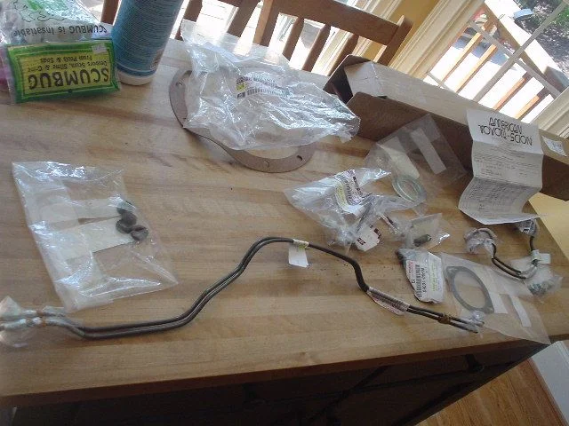

This just in.
Name:  cdan order.jpg
Back order did not take long. Back to work on Saturday!
